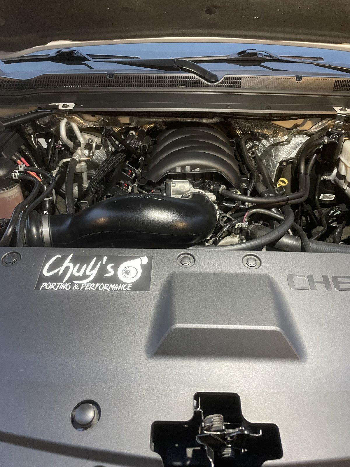

I went with the LT5 95mm tb with lingenfelter tb adapter to chuy454 ported l86
Nov 21, 2020
38
36
Chuy does really good work

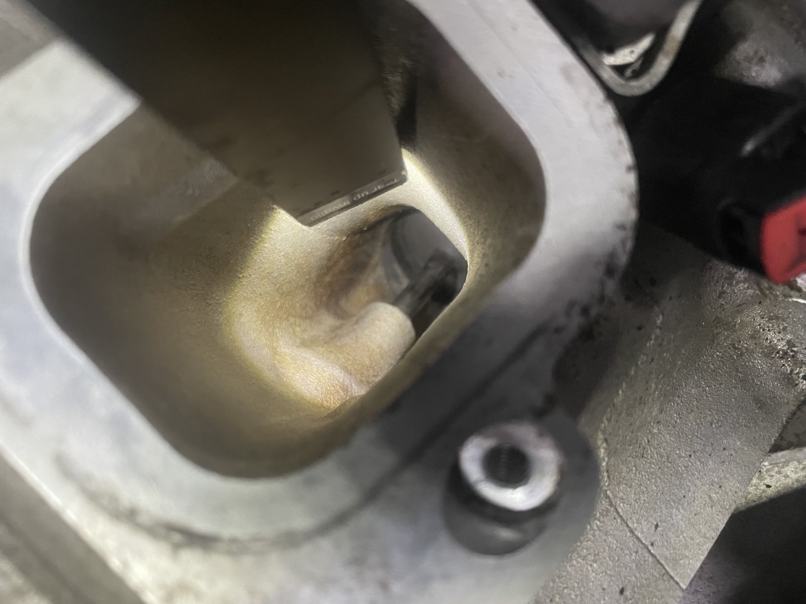

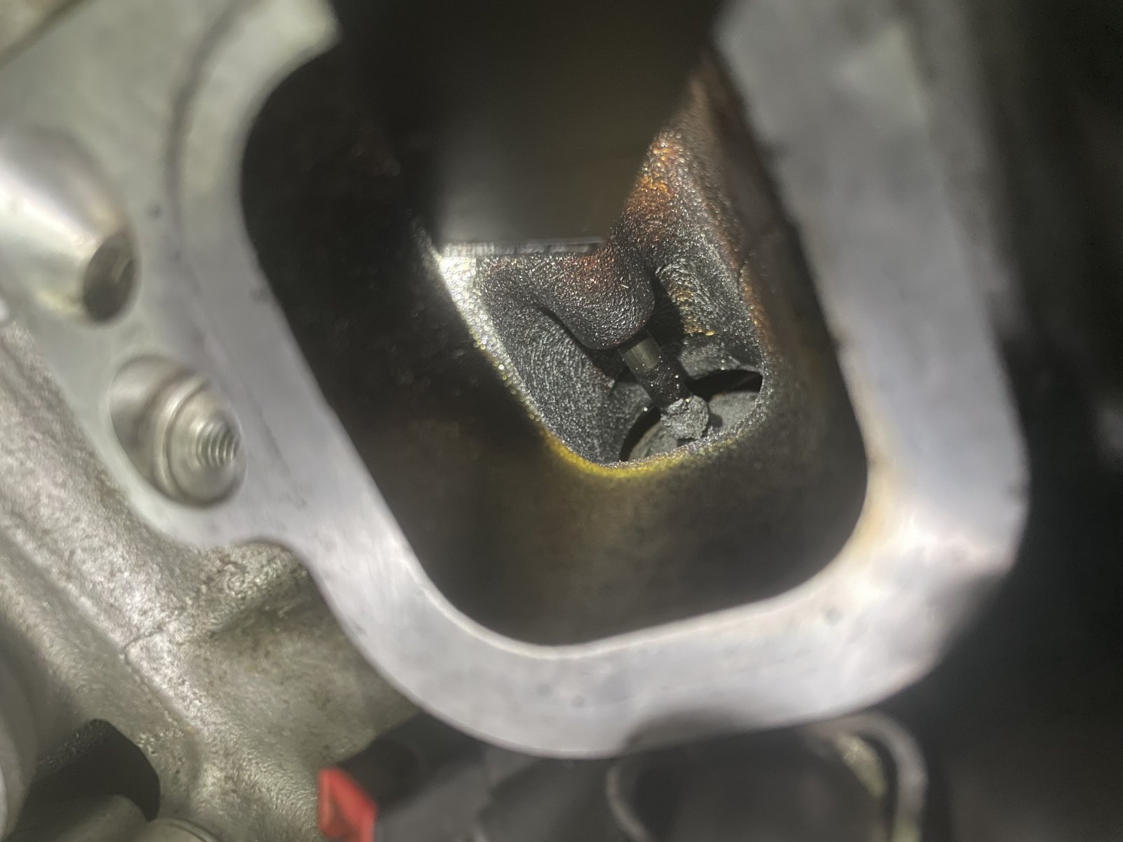

First time customer and I was not disappointed! Great service. Removal & install was very easy. The hardest part was manual cleaning the intake valves . I’m glad I put on a catch can shortly after purchasing it.
How did you manually clean the intake valves, what did you use ?
Nov 21, 2020
38
36
If it’s really bad, definitely source out a walnut blaster. I just rotated the motor and used chemtool b12 to soak the valves that were closed. Agitated with miscellaneous bottle cleaner brushes and took 3/8 fuel hose adapted it to a shop vac to suck up fluid.
