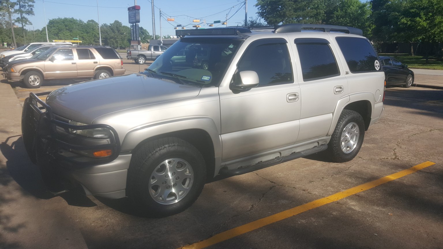

I don't want a monster truck but 3 inches might be cool on 33's. Keeping stock rims. Will keys and blocks do ok for a budget lift? Also post pics if you are running the same setup.
My hoe sitting stock height.

Cool ride. Thanks for the reply. I ordered 3" blocks for the rear and 1"-3" keys for the front. I kind of like the factory stance. But higher.

Here's a pic of ol yuky she needs some lift I am also running 285/75r16 and love how they turned out as far as the stance
