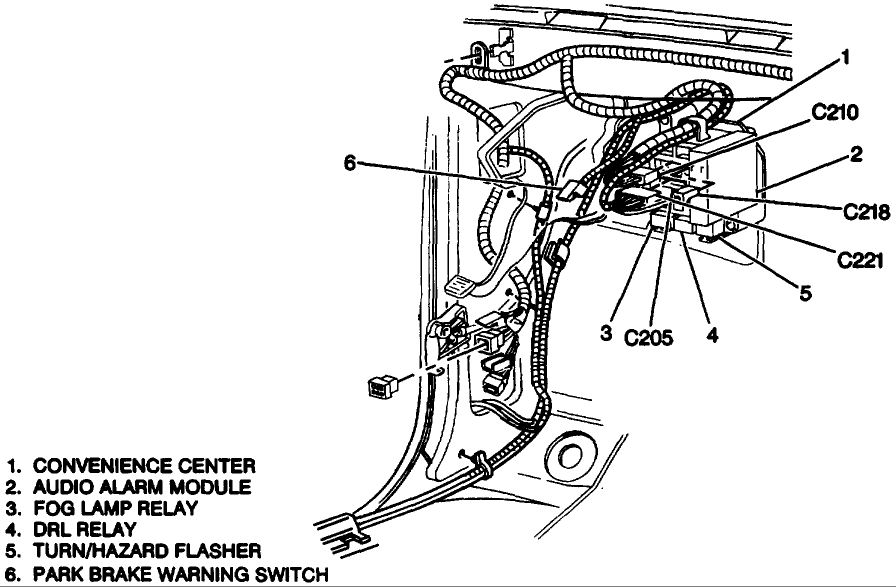

Could be a bad receiver which may explain the loss of range. Here are the diagnostics for the horn not sounding with the remote:
Connector C210 which is plugged into the "convenience center", on firewall near the parking brake pedal...
