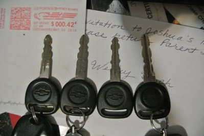

So I bought two new keyfobs+keys off Amazon for $32 (www.amazon.com/gp/product/B019E48DOM) for my 2011 Tahoe, and took it to the local GM dealer. They only charged $50 to reprogram all 4 and cut the two new keys. Now I have 4 working keys+keyfobs, one is Driver #1, one is Driver #2 and the other two lock/unlock perfectly without changing the seat positions (Memory Seats/Personalization).

these are keys from a 03, 04, 12 if your key has a (+) symbol on the metal part then it has a chip, the chipped key can be programmed yourself no need to pay to have it programmed.

these are keys from a 03, 04, 12 the groove is slightly deeper on the newer key, none are chipped, GM uses a HAL sensor in the ignition housing at least on these trucks they do.
