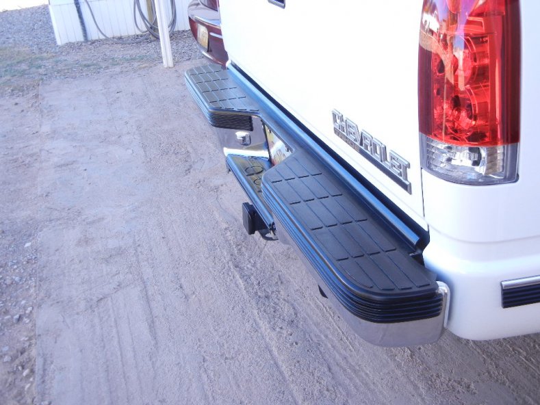

I replaced all of mine on my '97 about 1-1/2 years ago, all stock in front as I didn't wish to change the look, or the headlight pattern on the road at night, and went with a slightly mild custom light for the rear which looks very close to stock.
