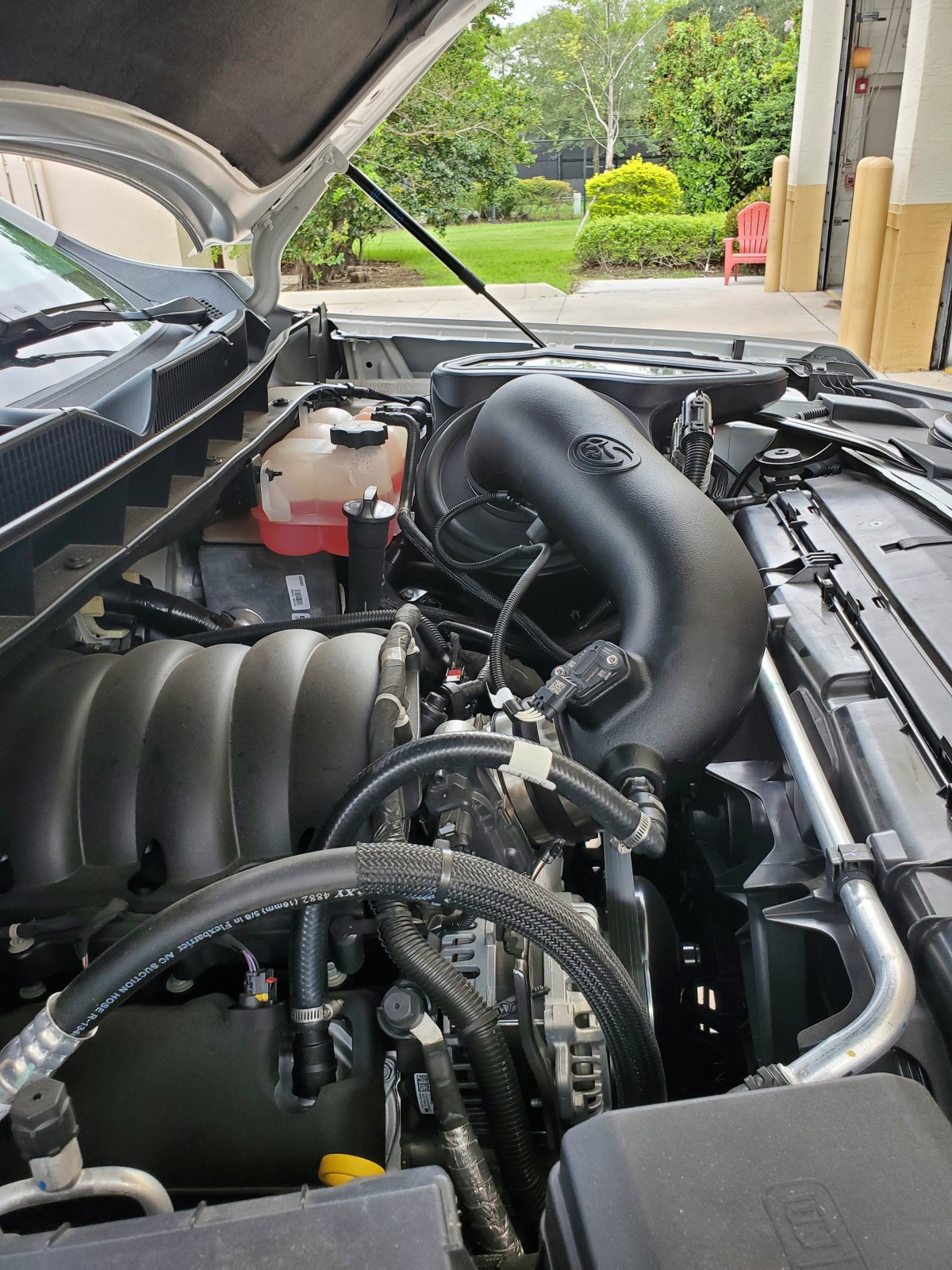

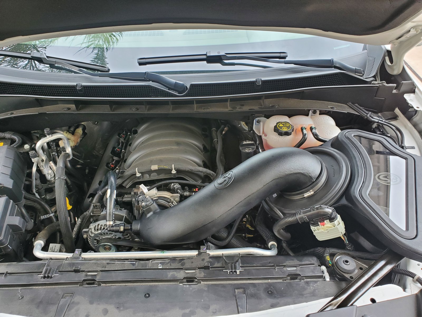

I just installed a new S&B cold air intake today. Negative battery terminal was removed at 0830 this morning. The job was completed at 1230 and negative terminal reconnected. Everything looks and sounds OK but I have an orange "dash" in the instrument console for each tire showing no pressure. On my GMC App, I have the picture snap-shot from my phone. How do I get my pressures back. All 4 tires were corrected to 36 actual psig and it still shows this in my GMC App.

I like it; when cruising or idling it sounds like factory, when stomping on the gas sounds like I have a Borla installed. I'm going to have a 2nd set of eyes look at my installation though. There is a sensation of something "Loose". For no reason, I'll get a "Growl" like I'm stomping on the gas but at low speed. then it immediately goes away and back to "Cruising/quiet", sometimes noticeable when in around a curve, even when decelerating. It actually is becoming annoying when that happens.

One of my inlets is hooked directly to the tube that leads outside the engine compartment directly under the leading edge of the hood. Where I tend to agree with you is there is a 2ndary inlet to the extreme right of the engine compartment that follows a channel that is under the hood. I'm trying to get a head start before dropping a Magnusson and Borla next year.
