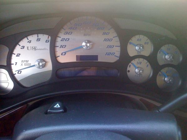

Just changed my gauge overlay needles
jdpromo33
Proud Tahoe Owner
Dec 18, 2009
690
Bloomfield, New Jersey

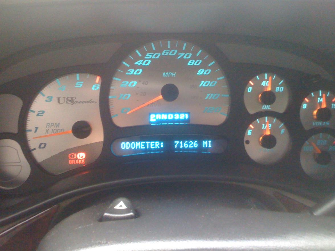

Intalled the US Speedo Stainless steel gauge with blue background and blue needles
Then swapped the blue needles with the factory orange ones

i think i like the blue better. awesome cluster though. how much was it?

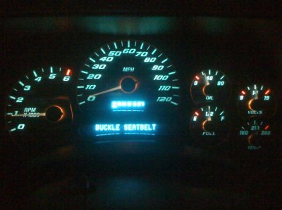

did you do the install youself on the cluster? i really like it. does it illuminate the oem green color or blue?

Very nice, I do like the blue needles better but to each their own, gotta be unique!

I did it myself and its quite easy once you figure out what your doing.
The OEM lights up LED blue and not green
The picture doesnt do it justice as it looks awesome at night. So much better than the stock guage

Hey jdpromo33- do your needles still light up orange even though you have blue needles?? Curious, just looks that way in the pic. I want to change my needles to Red I think, since I have indiglo blue/green color change face, but interested in knowing if it will even matter??? I have seen pics of others who have changed the bulbs in the back to blue, and there needles ended up lighting blue. Have you not changed the bulbs yet? Maybe that's why.

No, the blue once light up a lighter blue than the background and of course the orange ones light up orange.
I'm actually gonna get the Red ones as they will look good against the blue background.
