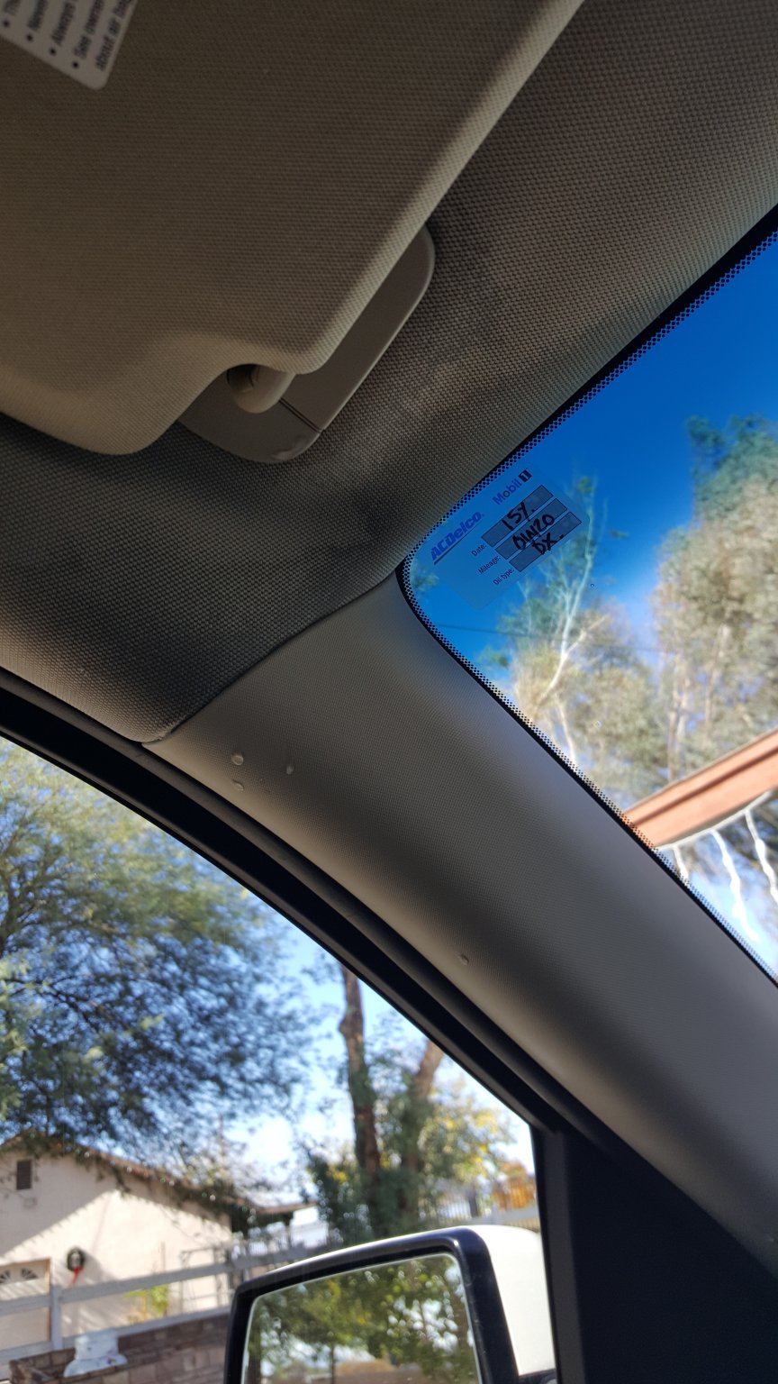

After a slow steady rain discovered dripping water from driver side ceiling near sun visor. Also navigation stopped working 2 months prior to this issue. Disappointed and hoping GM will make it right. A lot of water damage to interior...now the whistling noise I have experienced since purchase is just another issue to add to the disappointment of such a big purchase.

The wind noise could be the black side trim on the doors (window). I've had 3 of the 4 lift and had to be fixed. I was hoping they'd fly off on the highway but they didn't. The tabs that hold them on are ridiculously small and flimsy. Apparently the wind gets under them plastic and the tabs break.

Leak=Shark fin antenna.
Noise=Trim or shark fin antenna.
Navigation=Shark fin antenna or computer failure.
Water can do a lot of damage when it manages to get into something that should be protected.

A moonroof is electric and slides back into the roof itself, which I'm guessing you have. There's drains in there that can get clogged with dirt etc, which can cause your problem. Try blowing those drains out with some compressed air. I'm not saying that's the problem, but if it is, the air should take care of that. Please let us know what happens. Also--please cluck on the above listed link. That could also be your issue, as you did state your navigation stopped working. Good luck and keep us updated.

I've noticed that drops of water will hit the seat if you open the door after it rains. It's a poor design in my opinion. Also had water drip on my hand after the door was closed as it built up but nothing as bad as you have. I have noticed twice that my screen did not turn on but not sure if it's tied to the rain, it came back on after a few minutes.
