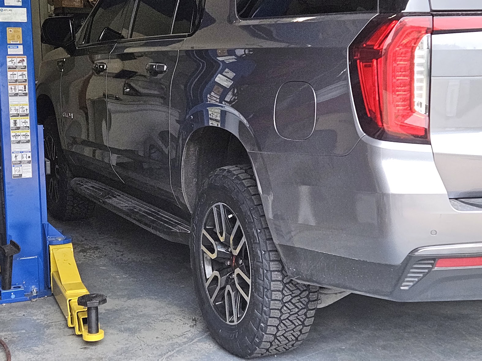

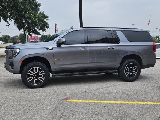

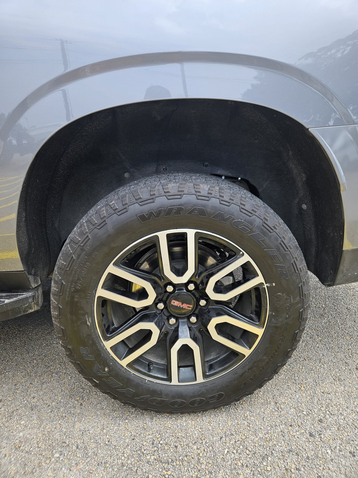

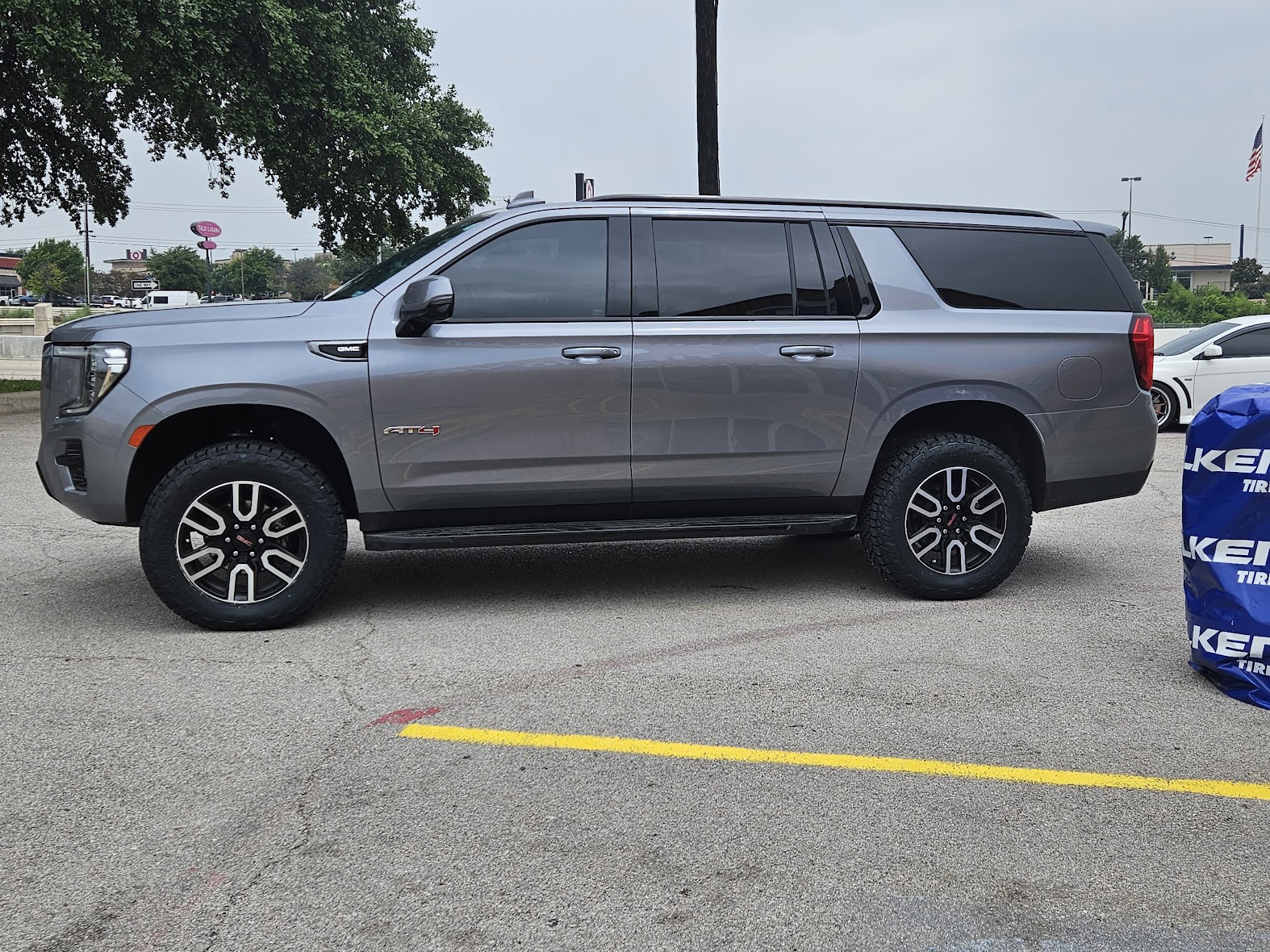

My AT4 sits am inch lower in the front stock, not level. Here are pics of the 3" Ready Lift Leveling Kit before I take it off and go with a 1" leveling kit.
Thats all in the eye of the beerholder.
I “leveled” my truck with a 1.5” kit, which still has it sitting about 3/4” higher in the back (by the measuring stick), but anymore than that and it looks like its sagging ass.
I dont care if the numbers show that the back is 12” higher on an at4, they “look” completely level in stock form. Jack only the front up, u will be looking like your sagging ass.

Giving it back to the off road shop lol
