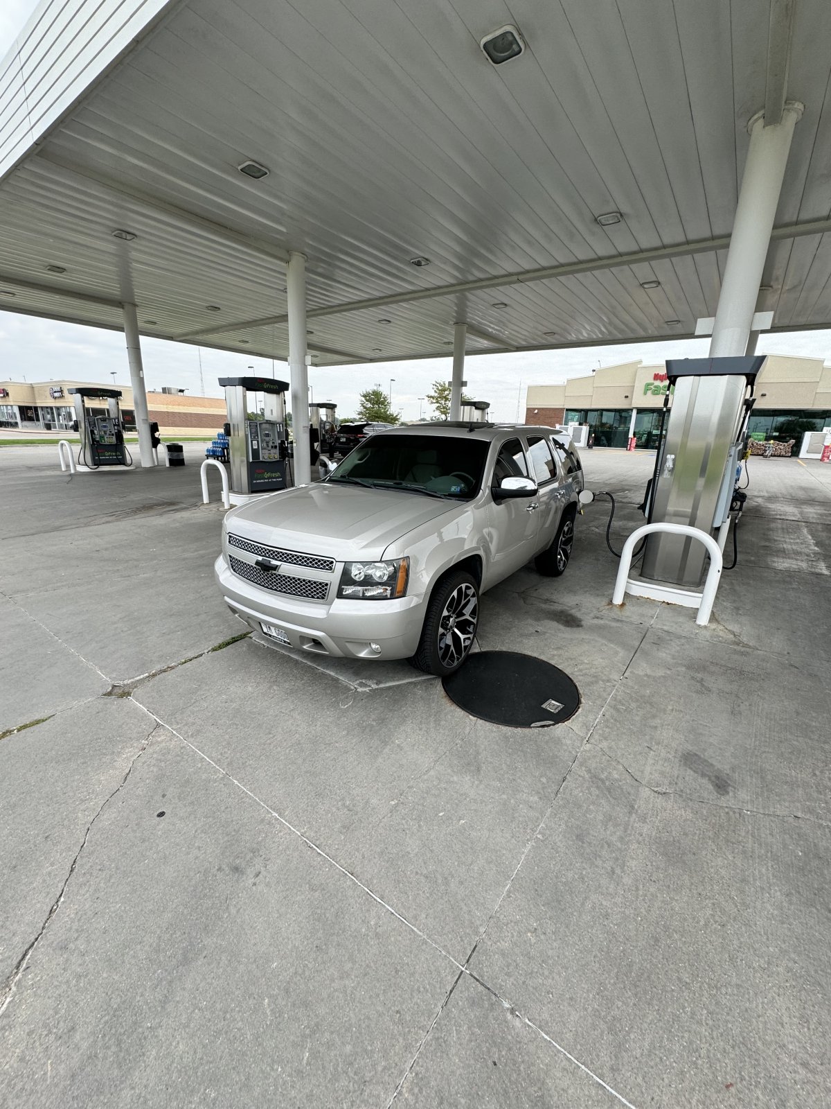

Im sure this has been asked before I just am struggling to track it down.
What are all the possible issues I could be having?? I can hit lock on my fob or inside my vehicle and my locks won't budge, but every once in a great while it does.
Tired of locking my Tahoe and my girl opening the passenger and setting my alarm off hahah.
Added a system so now I am even more on edge about this since I have yet to add the after market alarm.
Any tips or past personal experience is appreciated!!
Thanks!

Nice rimz
