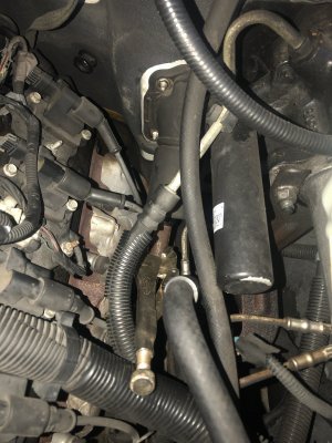

Hello all,
So I’ve had the dreaded steering clunk in my 2005 Tahoe. I had a mechanic come check it out. Quoted me 550$ to replace the “upper steering”. After looking on the internet I see that this problem is somewhat common and is traced back to a problem with the intermediate steering shaft. So I got the requisite replacement and thought I could change it myself, after watching as many YouTube videos as I could. Here’s where I hit a snag, I could not for the life of me get the shaft to come out of the upper steering shaft or lower shaft. In every video it takes people a mere finger to push the ISS out of the upper shaft and I couldn’t get it to move a millimeter. Anyone have a similar experience? I really don’t want to pay someone a bunch of money to do something that seems so straight forward.

That’s the problem, I can’t get it to collapse at all. If I could I would have popped the replacement one in yesterday, instead of screaming obscenities as I couldn’t move the thing a millimeter. Ughh might have to actually take this whole thing apart to get it out.

Push the shaft that’s going through the steering bearing? It looks like it takes just a finger putting pressure on the ISS u joint pops it out of the upper shaft. Every video says the same. I’m telling you I used every inch of my strength and I didn’t move it at all, the bolt fit right back through.

Run into this all the time (dealership tech). The first answer was the best answer, vise grips and a hammer. I'm sure I've done over 100 and only once have I had to apply a little heat to that area to get it apart. If you have a short air hammer and can get a good bite with the grips you can fit an air hammer from the bottom if need be but usually just the vise grips and a hammer work

I’m sorry for needing so much info but did you do this from under the truck? I feel like I’m not envisioning it. In my head if I latch the vise grips onto the shaft, and give em a whack the grips will just flap over and not transfer the energy to release the shaft. Am
I missing how it’s done?
