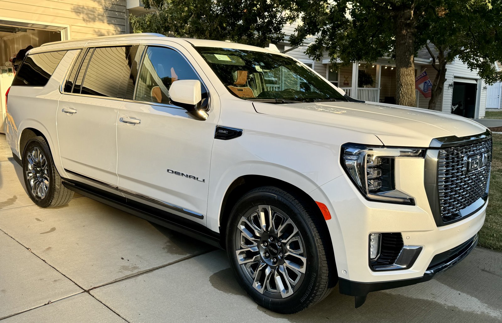

Love all the helpful tips! I wouldn't have survived the waiting period for my ride to jump on the train without y'all and your pics on here. It kept me really excited about everything to come! I scored this gem as a dealer retail order that hadn't hit the GM website inventory yet, so when I learned about it the build date was a few days prior. Ended up waiting less than 2 weeks from deposit to on the lot. Feeling very, very lucky and thankful cause I know others' timelines have not been as quick.
Here's the first wash pic after I got it home. I still need to get ceramic on it but so far it is 1000x easier to keep clean than my Black tahoe prior. Love love love the sparkles in it!
