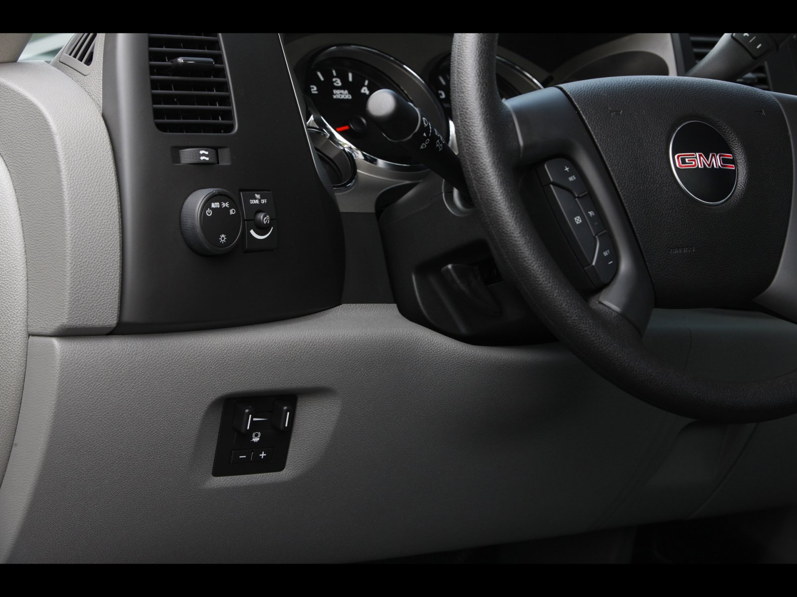

You would know if you had one they have a special slot on the lower drivers kick panel and +/- buttons, the newer aftermarket ones are digital, my 03 came with a aftermarket one so it's at least 16yrs old

If you have the ITBC it will be on the knee bolster below the headlight switch. Under the dash are the wires to add an aftermarket one. Under the hood there's a wire taped up under the master cylinder that would feed power to the trailer's battery or interior. You can hook this up to the stud on the front of the fuse box. Since you already have the tow package, the other wire along the fender is already hooked up to the other post on the front of the fuse box. Don't forget the 40 Amp J-Case fuse to make it work. Remember, whatever is running in the trailer will feed off the truck's battery even if the truck is not running.
