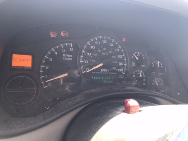

My instrument cluster is having intermittent problems, I found out someone has monkeyed with the security system so it might be related. Sometimes when you shut it off the security light is on solid. Everything starts working fine and then the problem pops back up again.

I’ve done all that, no migration found, very clean. Cleaned anyway and touched up all solder joints to ensure there was no cold solder. I’ve verified 100% it’s due to the aftermarket security modification. I’m at a loss as to how to fix it because I can’t figure out what was done. If you don’t hold the cruise resume button and let the horn sounds it resets the gauges. If you turn the system off with the switch the gauges start glitching again.

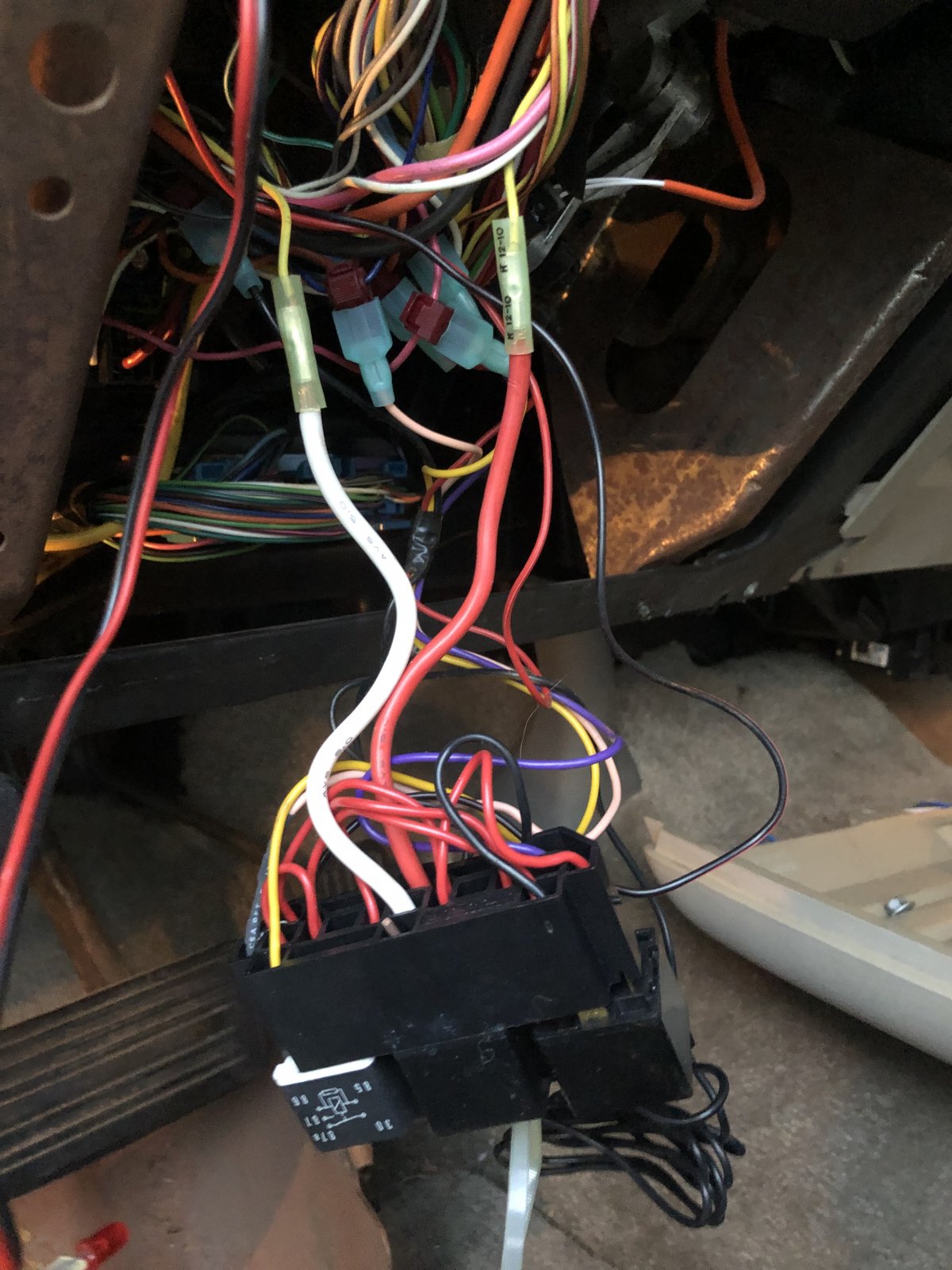

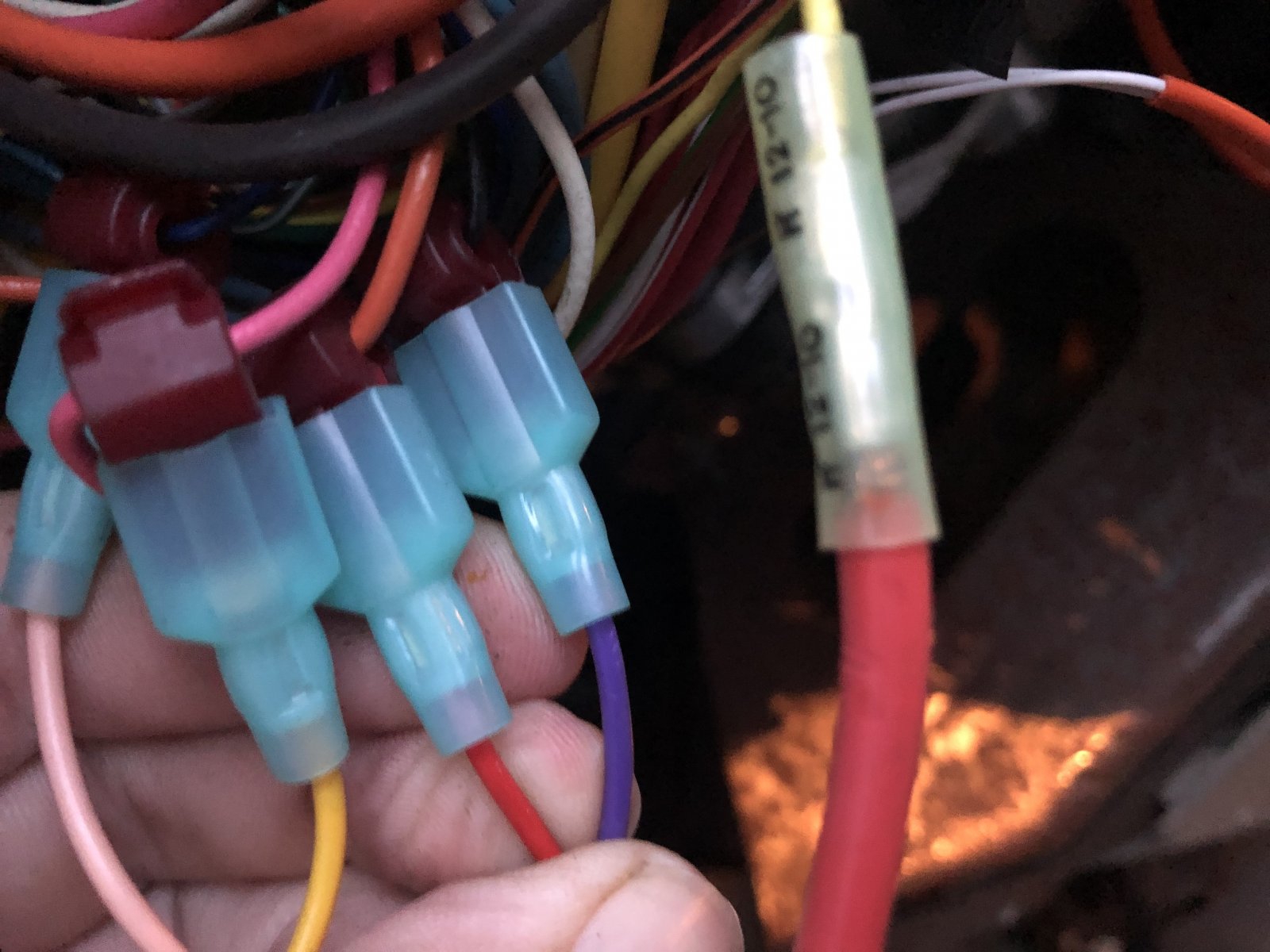

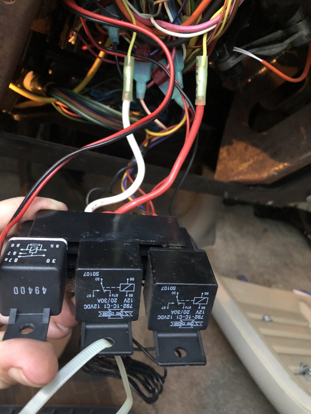

I apologize for disappearing, Ive been super busy, found someone had installed a bank of three relays that interrupted the yellow wire. Removed the relays and now its a hard fail and I can’t reset the gauges by holding the cruise button and letting the horn blow. Still not sure ir its the cluster or something outside triggers the failure. Im lost.
exp500
May 14, 2017
2,018
1,967
See the cut purple wire? Check Wireing diagrams for it. Think that is part of Anti-theft.

Thank y’all, has anyone ever seen something like this? Its a hard failure now that Ive removed the relays.

Right next to big white wire in your 3rd pic.
