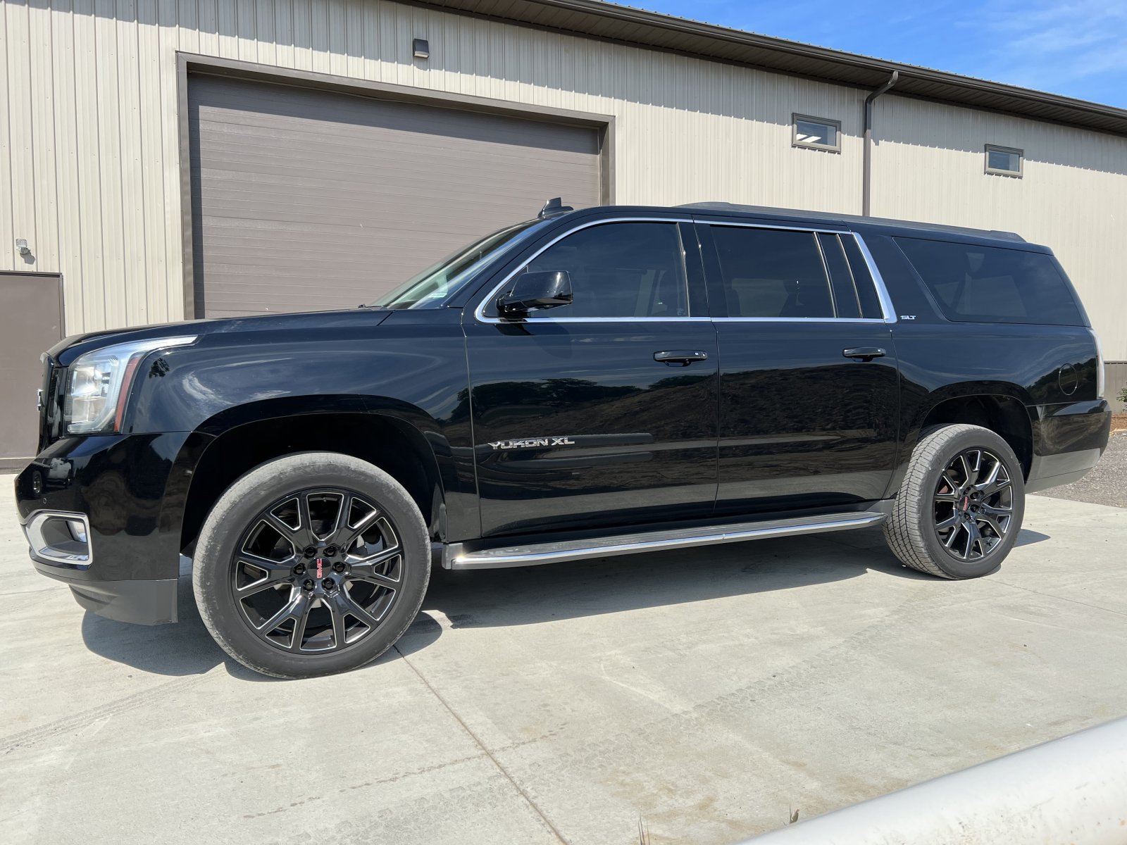

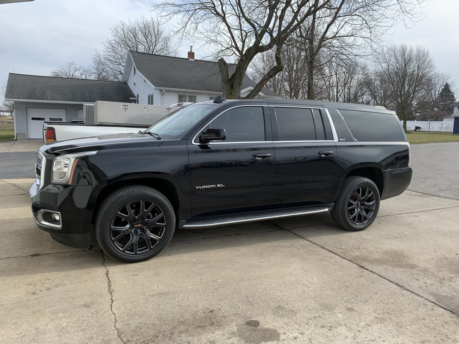

As for ride quality, I can’t speak much for that yet. I literally drove it 3 miles and dropped it off for alignment on Monday. I did find a picture of how it looked before and took a picture of how it looks now. I think it looks great and is one of the better options for leveling out these trucks. Little more involved compared to other options, but definitely worth it in my opinion. I will update again once we have some miles under our belt. We will be driving from Indiana to Florida and back a month from now so I should definitely have some good feedback on how things are settling in and also how the ride quality is. Stay tuned!
