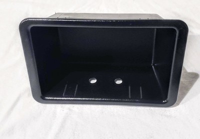

I want to replace my 2001 yukon useless rear console radio controls with a cubby
Jun 14, 2020
68
71
I want to replace my useless console rear radio controls that do not work with my front dash aftermarket radio, I want to replace it with a cubby insert like I replace my OnStar and tape deck with cubby inserts. Is there a product to replace the 01 yukon console controls rear radio with?
I found this 03 but I'm not sure it will fit a 01 console
NoReverseYukon
Feb 27, 2019
750
1,861
NE Wisconsin
Don't spend $37 on that. I might still have a few stashed away somewhere that i can sell you for much less. Just a heads-up; you will need to install jumpers in the harness to keep your rear speakers and amp working. I have a thread here somewhere that shows you how to do it. Let me know if you want a cubby. I also think that I posted them in the "for sale" forum.
