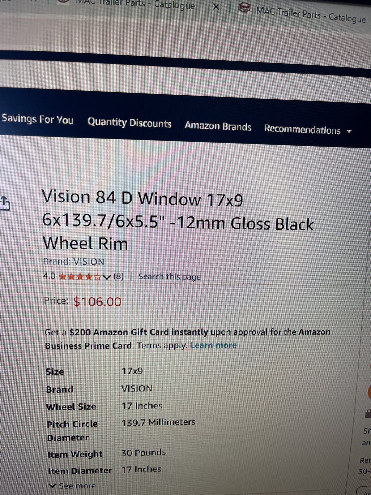

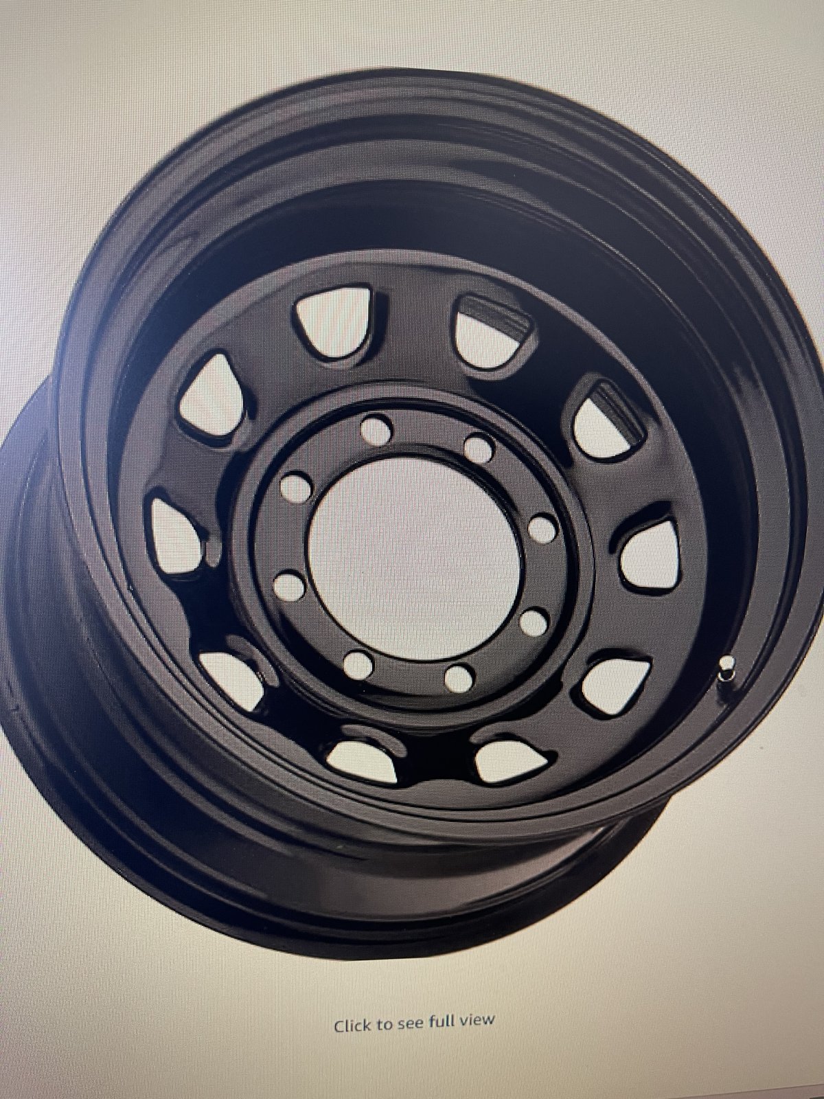

Diffrent sources stating OK for our trucks , are they ?
Anyone have better info ?
Of course in 6 bolt pattern .

Depends on your calipers. I’m not sure if ppv has bigger calipers but normally 17” is the smallest size that’ll fit. I can’t see the offset on the listing but it looks fairly deep. With that you may run into clearance issues depending on the tire size. They remind me of old NASCAR wheels. White letters out wb cool yellow would be cooler.

Exactly why I like those

-12mm offset is really aggressive. They will poke out past the fender for sure.
This is a good website to play around with on wheel and tire fitment. You can plug in your current wheel and tire specs on the left and then plug in the wheel and tire specs you're considering on the right and it will tell you how much closer things are to the suspension, how much farther the tires will poke out of the fender etc.
