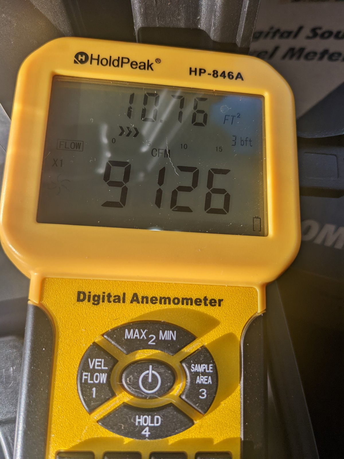

Depending on how much less airflow there is from side to side it might be normal with more to the driver, checked mine which should be working normally
Drivers side
Passenger side
