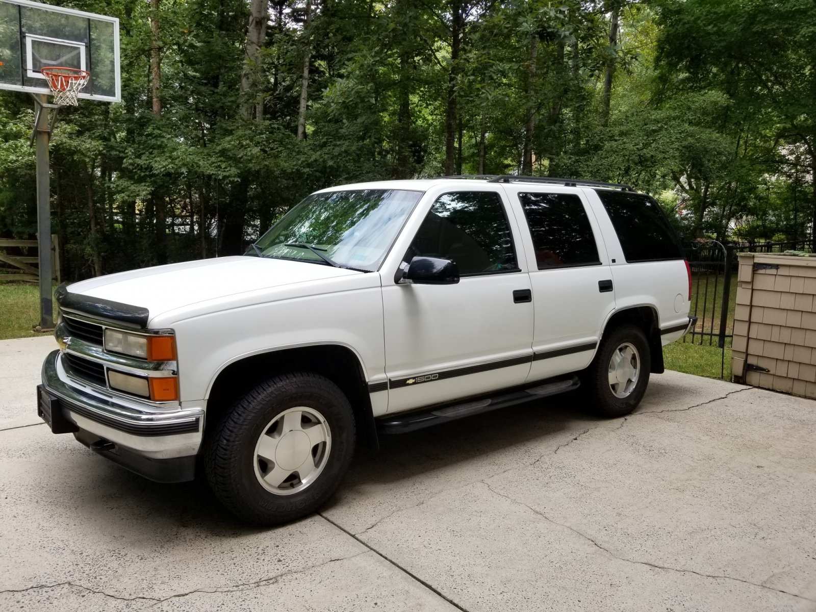

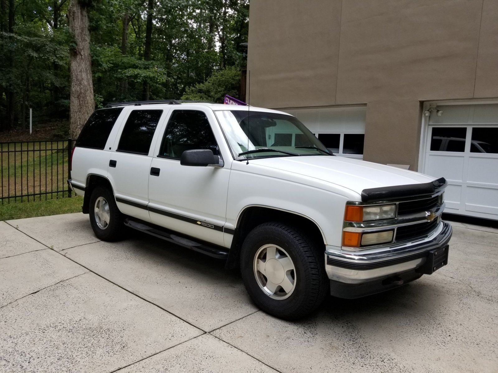

I am also getting close to my limit of how much $$$ I am continuing to put into my Tahoe, while maintaining some reasonable amount of sleep. I am the original owner. I have 100% of the repair records on the vehicle, over 23 years worth. I may soon hit my limit and offer it up for adoption to another Tahoe fanatic. All systems are running well, including A/C. If you want to be on that short list let me know.
