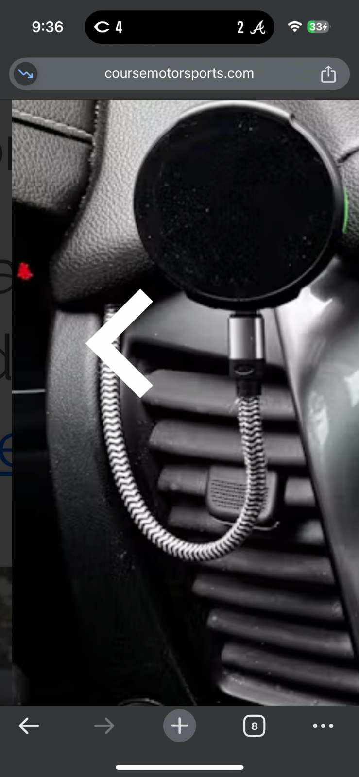

Is there an easy way to describe how to route a charging cable as shown here?
just remove the kick panel under the steering when that stretches from the drivers side fuse panel to the center console, there is a screw on the far left then it "should" be just clips, on the right it will butt up against part of the center console and there is 2 clips that have to pull out. once that is off then you pull the center console up and be able to access the vent area, you should not have to remove the console entirely if you do be aware there is a few wire harness connectors but you can lift it up set it back a smidge.
* also the center console lid must be open before trying to lift the center console because the rear part is attached under the center console storage lid.
this video may be helpful, just click on the play button and it will take you to the video, watch the video from beginning to 9 minutes and that will get you where you want to be
