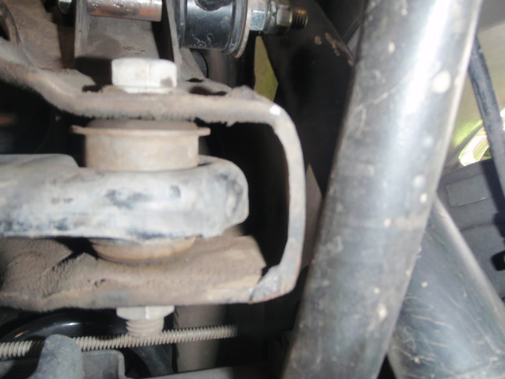

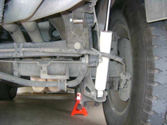

Got to thinking about replace my swaybar and took a hard look at my links....this is what I saw! Can you find Waldo?
Not my doing...

the way the endlinks are mounted?
What exgaust is that?
Ya is that messed up or what LOL? Gunna fix that after lunch

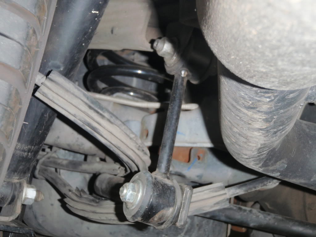

Here is the "offset" I was referring to in a previous thread on my driver side link..see how the link is offset on each end? I thought that was weird....doesn't look like it's functional for anything? Might as well be a straight link as far as I'm concerned

I don't think anything is wrong. The links are offset in order to move your sway bar about 2'' to the passenger's side in order to clear the panhard. The link being mounted on the outside with the retaining spacer is correct. On your driver's side the offset should be pushing the sway toward the passenger side and if I remember correctly from when I dropped mine I put the link on the outside of the sway bar. I really had to push my sway hard and the driver's side bracket is pretty much in the curve of the sway bar, I need to relocate the bracket on the frame so it is on the straight part of the sway bar. It looks like your sway bat does not clear your panhard on the passenger's side but it's hard to tell with the truck jacked up. The links may be on the wrong sides as well, I had mine wrong at first and my sway bar was denting the bottom of my panhard and I went through 2 6'' bolts on the passengers side because they were bending due to having the offset links wrong.....

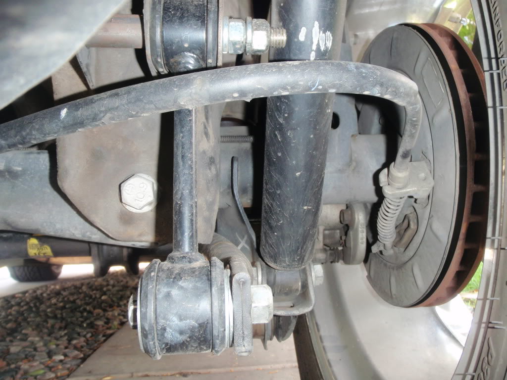

Here is mine, could be wrong too but since I switched it to this no more bending, scraping the panhard, or clanking
Passenger's side
Driver's Side

Whoever did your drop is not a complete idiot. The link is set up per the McGaughey's instructions- the sway bar however, is not. It needs to move 2" towards the pass side. Once you do that, the sway bar will bolt to the pass side of the links, and the reason for the offset link on the driver's side will become apparent. Took me a little head scratchin' too, as the McGaughey's instructions are vague and contain shatty pics. Grocery Getter's comment on moving the driver's side axle bracket is correct as well.
Time to break out the jack stands! :)
Its already on jacks! Gopnna fix that shiot...could it cause a vibration this way?

****** hot it on the head, the sway should bolt to the passenger's side of the links. You will need to loosen up the sway brackets almost all the way to get the bar to move enough to the passengers side so it clears the panhard, mine took some serious tugging and I bolted everything on the passenger's side in place first. It's a pain in the ass due to the location of the driver's side sway bracket, it does not allow the sway bar to move too much so if you drill new holes in the frame a few inches over and relocate the bracket with some new hardware everything will fit like a glove......Something the install instructions fail to mention......I still need to do this but I am clearing the panhard so I have been putting it off...

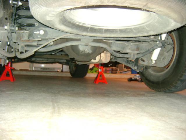

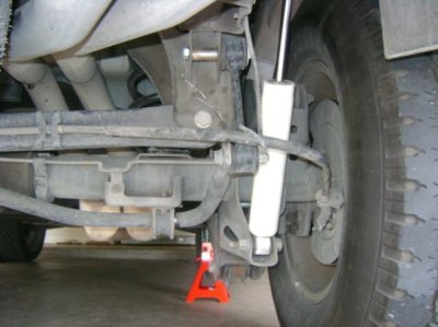

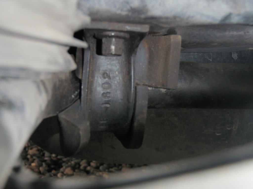

Here's a pic of the whole sway, driver to passengar..I don't see any clearance issues and haven't heard any knocking. I do, however, still have a VERY VERY annoying vibration throughout the entire truck.
The clearance problem will be at the passenger side, near the panhard pivot. The sway bar will contact in this area when you hit a bump or dip- or with bags, when aired-out.
Vibration could be pinion angle. Did you use the trailing arm relocators?
---------- Post added at 07:13 PM ---------- Previous post was at 07:09 PM ----------
This is where you will see contact, if any:
