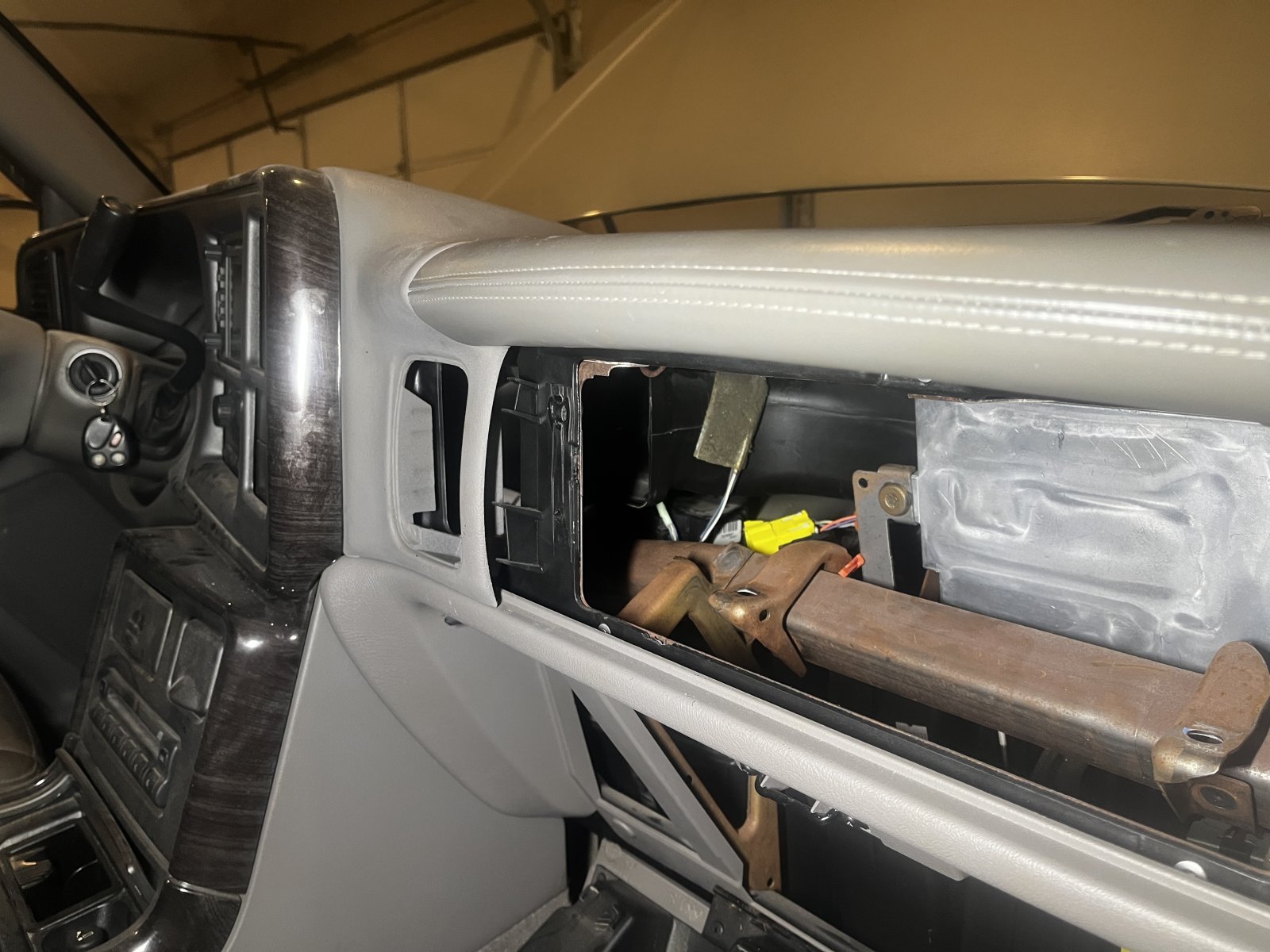

Have hot air coming out passenger side. Left side works normal. Replaced actuator under dash and no change. If I manually move the door I can get cold on both sides. My understanding now is that the one under the dash on passenger side controls the air temp on driver side. Is that correct? This would make sense why a new actuator didn’t change things but I’m confused that manually manipulating the door would allow cool or hot air on the passenger side. Where would be the actuator for the passenger side temp control and how is the best way to access and change if that is the case?

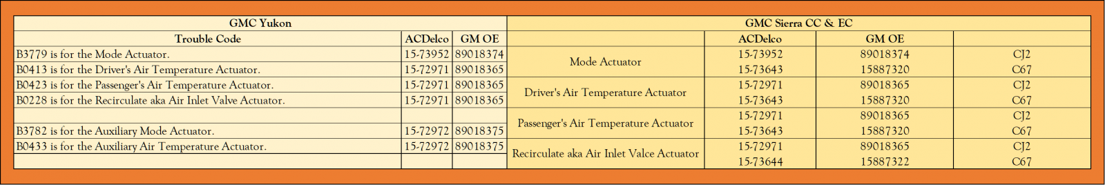

What’s the part number for the one that controls front passenger temperature?

Thanks. Are all the actuators the same part or are there some different ones?
The GM and ACDelco part number are on the same box.

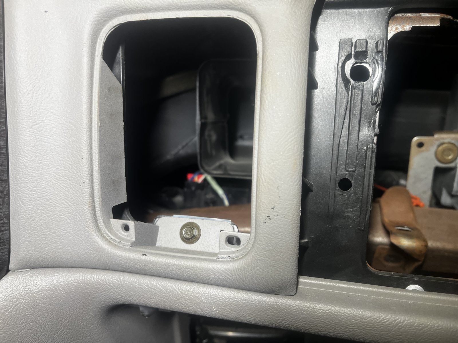

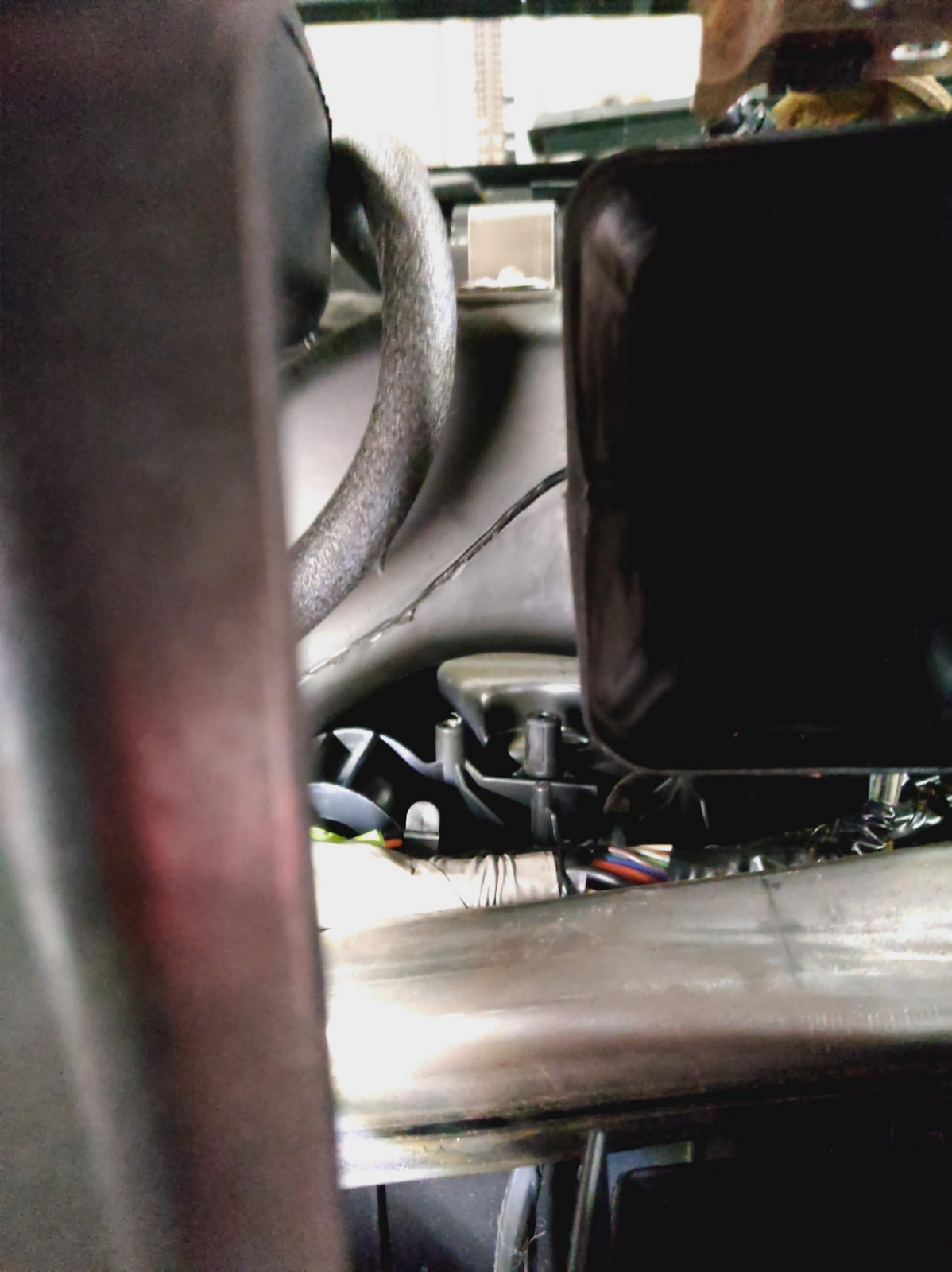

Watched the video very helpful. Mentions it being an 8 mm which it’s not. It’s a 5.5 or 7/32. I have the vents, airbag and glovebox out. Not sure how they were able to access the inner bolt using this method. I can’t get or fit anything in that space with the angles and tight fights. Any suggestions? If I could get the ducting out of the way I would be good.

On the top blend door, most people just cut the duct running under the dash in half and taped it back together. Not sure if this is the duct that is in your way.

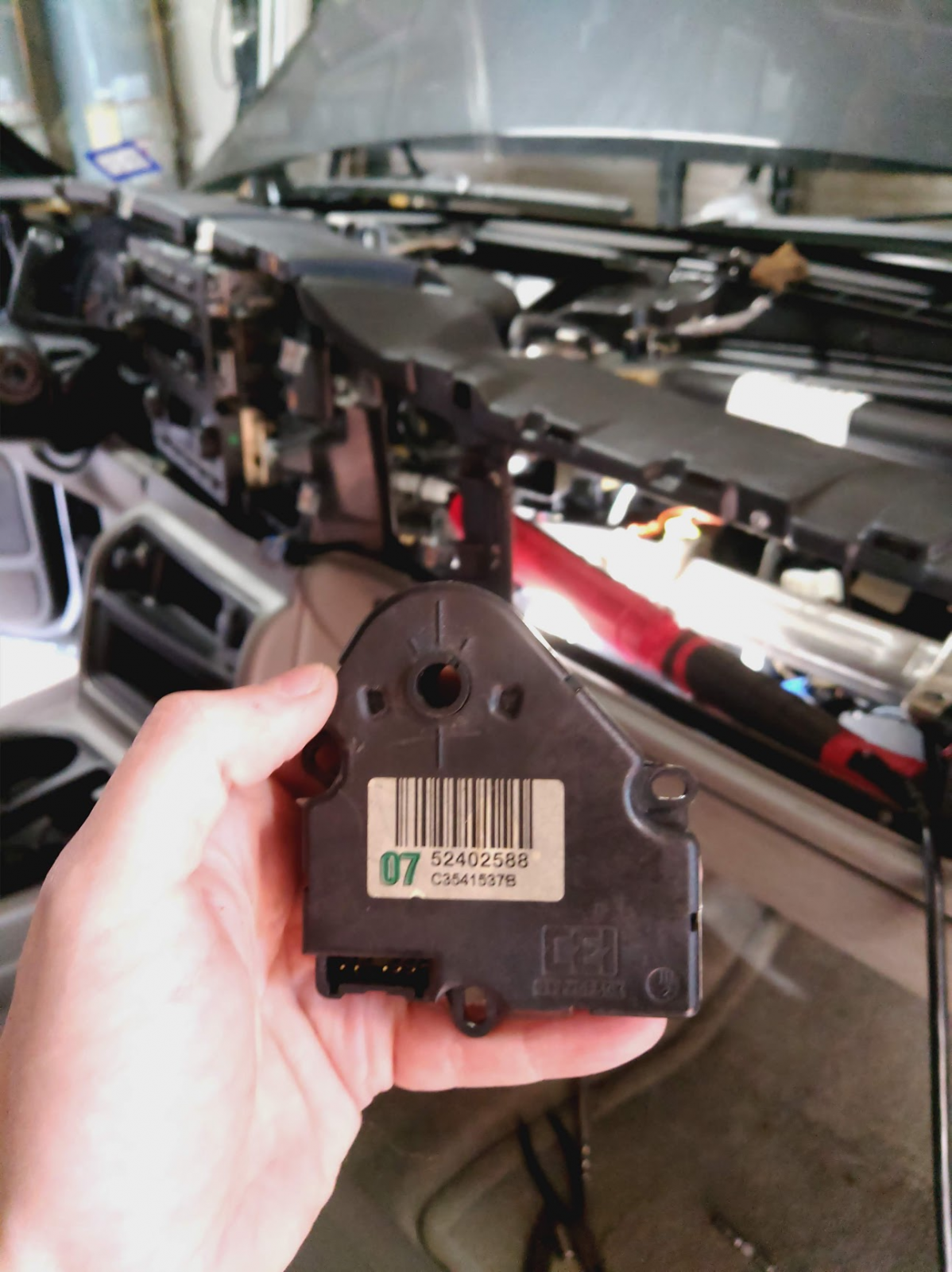

I usually find the part number on the actuator as the listings are so vague and misleading.

Where do they typically cut it? Would it help to remove the radio and hvac controls or what’s the proper way to do this?

I took the dash cover off but still had to pry up on the vent to get the actuator R&R.
