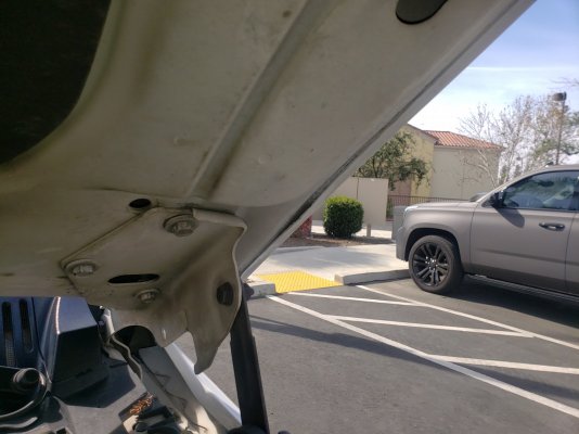

you can see the folded seam is openning up. Its right at the spot where the hinge force would stress it. Just wondering if it was a known issue at all. Might just be time for a HD swap, ha!

Strange, never seen that before. Looks like the seam sealer/body adhesive just gave up right there. I bet a body guy would have an answer. Does that area flex when opening and closing the hood? Are the hinges really stiff?

yeah it bends right there. doesn't seem overly stiff. Probably just end up refitting the seam to get it back onto shape and tack weld it back to the inner structure...

I would use panel adhesive first then c clamp with 2x4 on hood surface and smaller peice of metal on seam on bottom and leave it set a day first tack weld as last resort, any more panels are glued together good luck.
