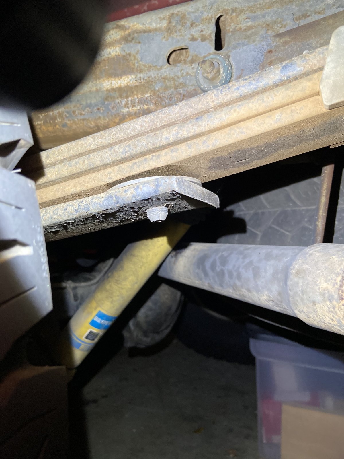

Wonder if it’s something specific to a four door SUV (the rear sway bar)? I’ve not experienced that issue on three trucks (C and K1500) or my two-door Tahoe. None have the rear stabilizer bar.
Also, there should be some plastic insulators on the ends of the leaf springs - perhaps they’re deteriorating.
Edit: these things, a little plastic disc with a post. GM part 20870046.
You may be spot on with that suspicion. As I mentioned previously, I too suspect sway bar bushings, shock bushings or even leaf spring pads(as you posted above). Nothing that worries me personally. Appreciate the differentiation you explained between the truck and SUV. That may help narrow it down at some point for me if I ever go looking for it again.

I thought it might have something to do with the leaf springs myself. I may throw a gopro under there one day soon and see if I can make out where its coming from. Will keep ya posted.

I remember hearing about the leaf spring isolator issue. I had noisy springs on my 2015 3500HD and it was a squaking type noise due to dry springs and midwest road crap buildup. I sprayed down the springs with penetrating oil and they were quiet and smoother. It would be worth a try for yourself
