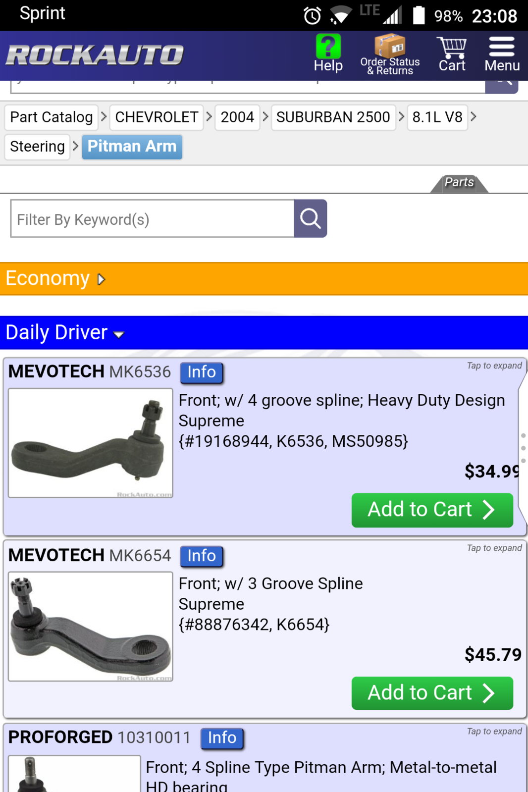

@Rocket Man was yours 3 or 4 groove pitman? My Vin pulls up one or the other and the local stealership said I just have to get in there to see what one it had. I bought both and will return the one not needed. I was just wondering if there was a pattern or manufacturer date for this in cause anyone else ran into this issue.
52,954
I just checked on RockAuto and for both our rigs all they list is the 4 groove. That's the one I bought.

I must be searching wrong cause it still shows 3 or 4 groove when I look. What where your search parameters ?

After 7 hours of suspension work fun, I thought I would share some new found information. 1st. - Pay someone else to do this because it is a frustrating pain in the ass. 2 - O.E.M. steering components with 225k are as loose as a sorority pledge after a party. I did not fully realized how horrible my suspension and steering where until driving the old girl with new everything. Steering is now as tight as... well you get the idea. 3 - I went with ac delco professional for my rebuild. All of the parts where either from Twain or from the good old USA except for both upper control arms which were made in China. 4 - My 2004 2500 Suburban with an 8.1 has a 3 groove pitman arm. I still have not found out the rhyme or reason why some have 3 groove and others have a 4 groove.

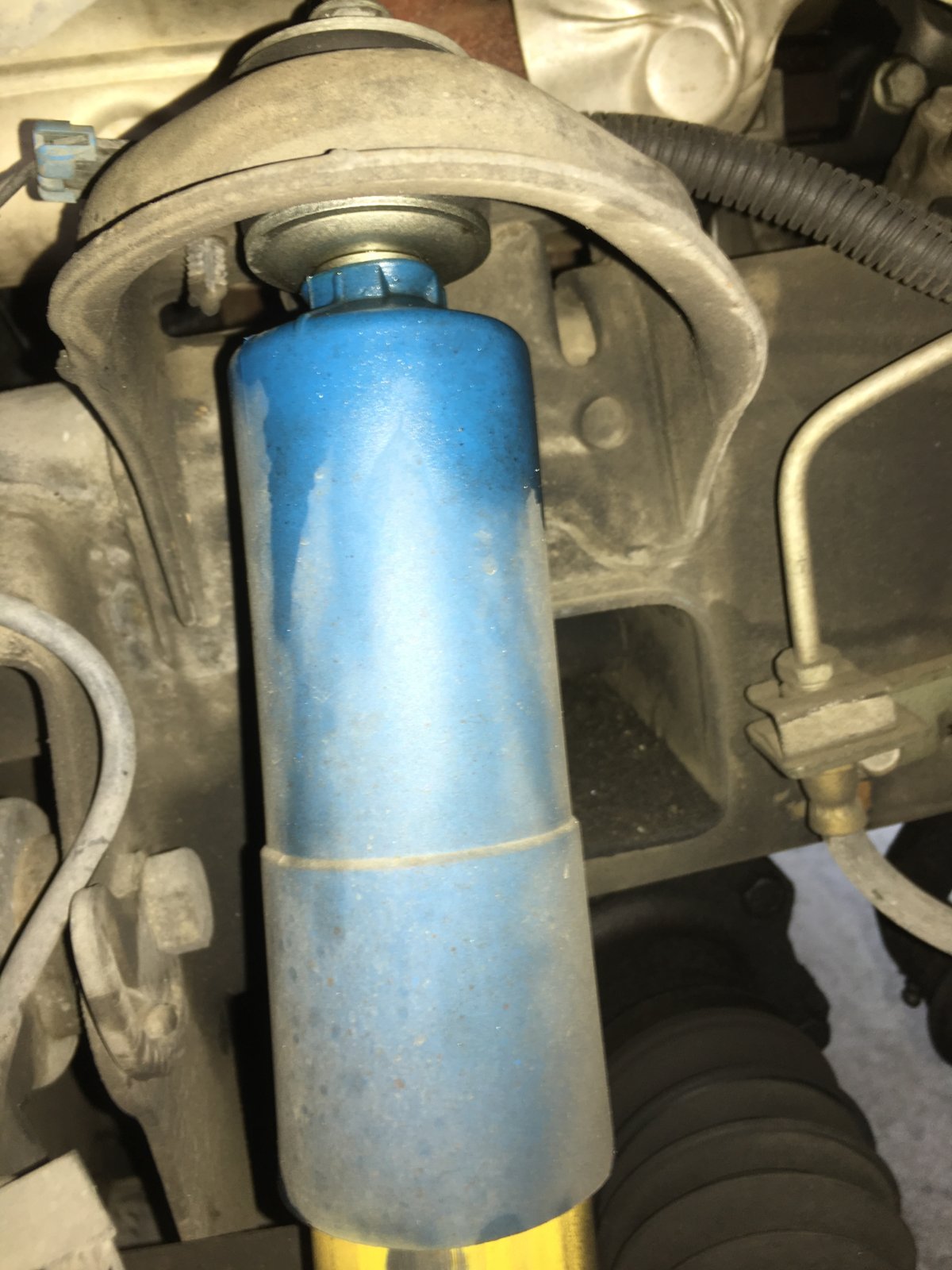

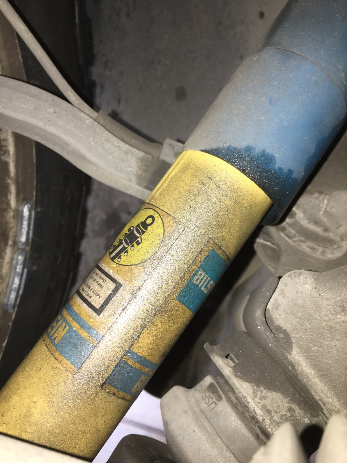

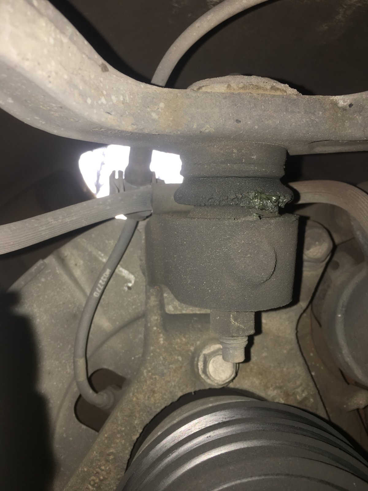

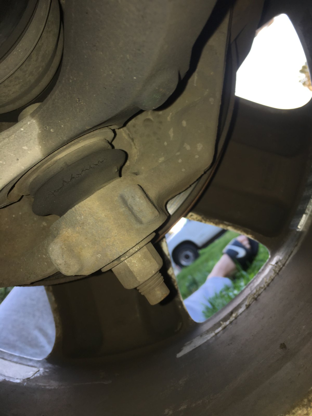

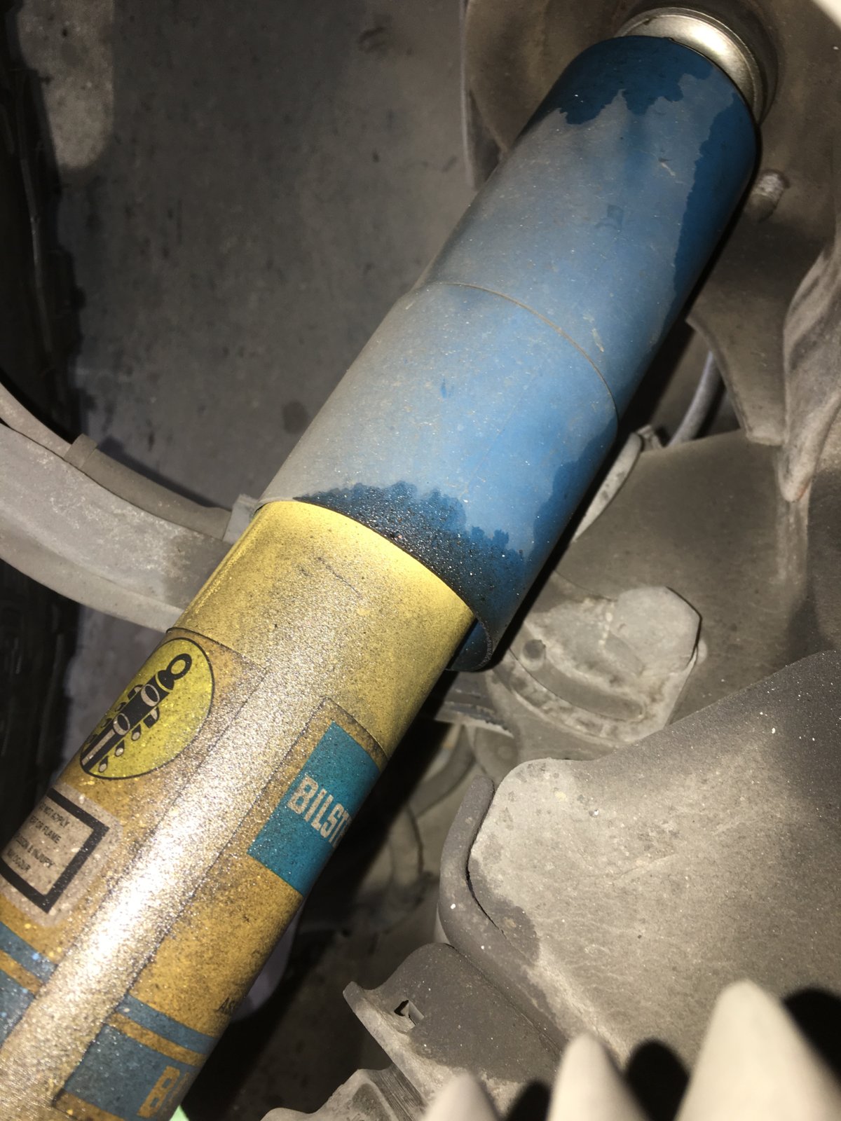

Ok, so I took a quick peek at the ball joints and stuff real quick, and definitely noticed that all 4 ball joints are starting to crack at the boots, and looks like a have a blown shock on the passenger side. I’m assuming this residue on the shock isn’t from something else. My truck does have some pretty significant oil leaks, but I couldn’t see it making its way over to the shock. Better add new shocks to the list again, can’t believe this went bad after 50k
View attachment 190498 View attachment 190499 View attachment 190500 View attachment 190501 View attachment 190502
i doubt the ball joint boots are the problem. i drove on a busted ball joint gushing with grease and it felt the same as when i got a new one
Yeah, I doubt that’s my issue, but just saying it’s probably time to finally replace all this stuff before it gets worse.
