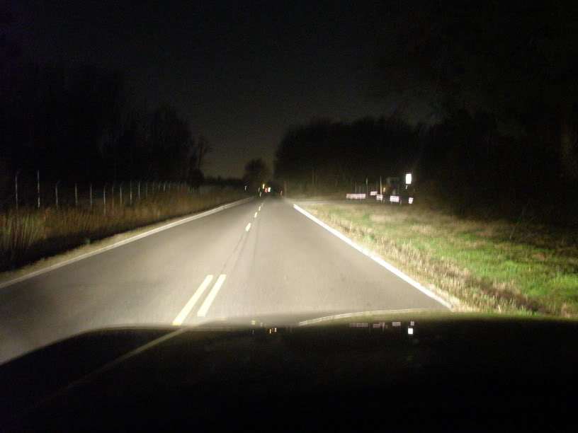

No hids in this pics. Low beams are standard 9005 (just 5 dollar bulbs) and High is the HIR.
Also dont think the light on the sky is sun. It was about 11:30 at night. Thats just some wierd setting on my camara.

again No HIDS here. I will get a pic tomorrow of a comparison of my 5000K HIDS and the HIRS.
