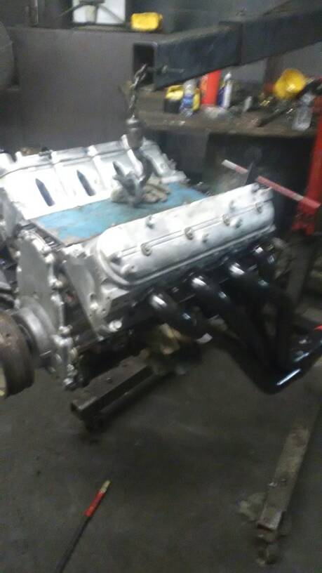

Fresh 5.3 build 2001 Tahoe
Sent from my Z917VL using Tapatalk
npease79
npease79
May 6, 2018
Couple changes ..low lift tsp cam 208 214 112lsa , 4.8 pistons, milled .005 243 heads, longtubes off road y...I intended to keep the stock converter , but i screwed the rear main up friday night at midnight after a long day. So since i gotta go back in its begging for a stall and of course a tune . I have put a hundred miles on it so far and even at about 3/4 throttle [as far as ive pushed so far] above 2300 rpms it really comes alive, sounds hilarious through the factory muffler its in stealth mode till about 2300 then starts roaring and sweeps the tach

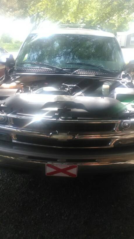

May 6, 2018
Blackbear tune intalled today...idles better did a 3rd gear pull and from 55 to 90 it flew however when i let off my truck refused to pull in 3rd or od as i coasted down around 65 i hit my traction putton and my trans started pulling again. Hopefully its just the computer
