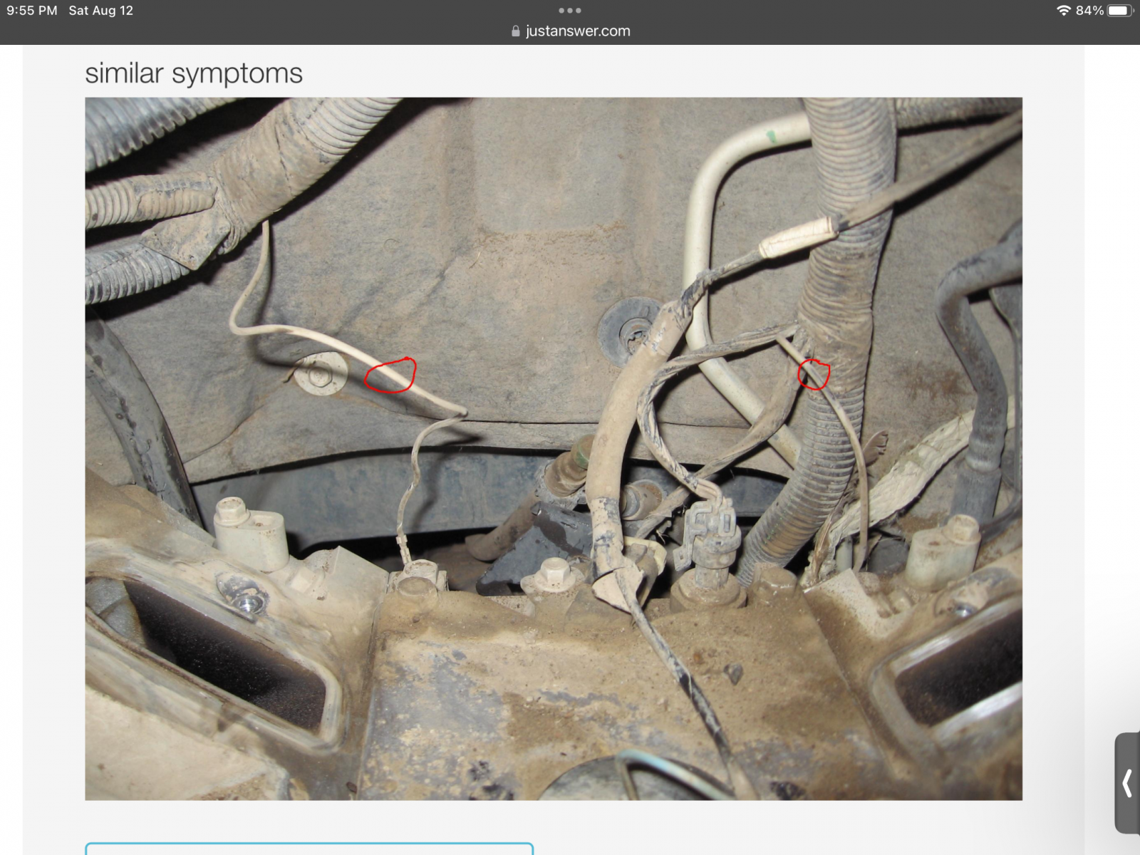

This one sounds like the ground behind the engine passenger side. it is likely broken. Tiny little wire bolted to the engine block. Ridiculous design. That little wire will cause all kinds of havoc if not grounded properly. Hard to reach the bolt but can be done with a little finagling. Also clean up the silver ground strap bolted to the drivers side firewall. Take it off and be sure to wire brush both sides of the wire and the bolt at the fire wall. You will see white dust coming off as you do.

Sorry. Did you inspect the ground behind engine on passenger side Like @tomloans mentioned? It’s by the oil sender unit. Very hard to get to unless you pull the intake manifold. See pic. One on the left.

Sorry. Did you inspect the ground behind engine on passenger side Like @tomloans mentioned? It’s by the oil sender unit. Very hard to get to unless you pull the intake manifold. See pic. One on the left.View attachment 405953
