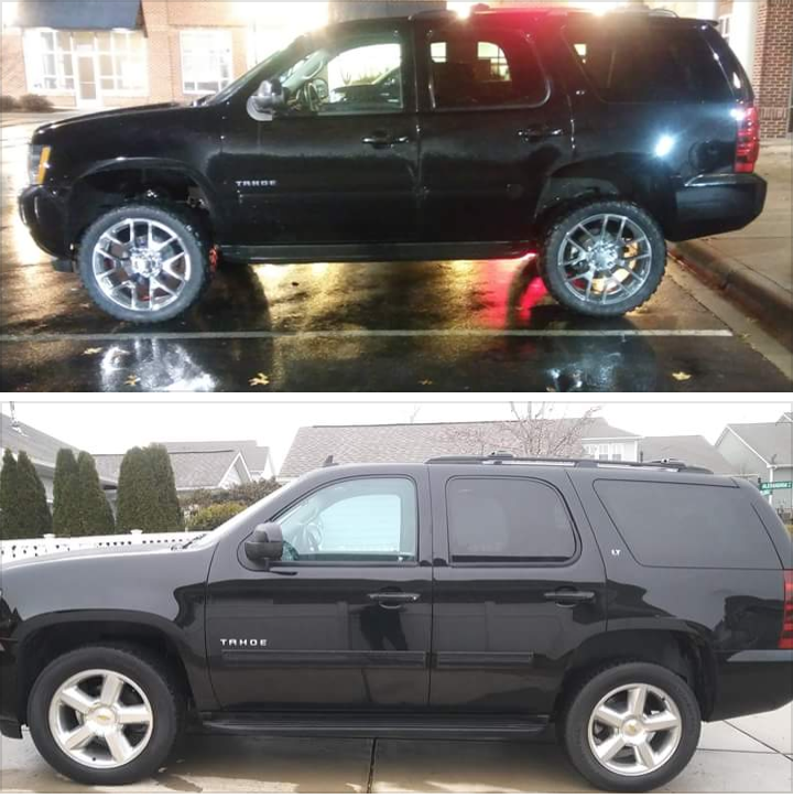

Does anyone have 33x12.50r22?? Trying to see what type of lift you have in order to swing those without rubbing!! I want it to be level also. Not looking to lift it high, just enough. I have a 2013 LTZ Tahoe, Thanks!!

Depends how wide the rim is, but a 3" and some trimming should do it. But if you're trying to get a 22x12 then you'd need a 6"

Also you posted in 00-06 section for 13 models but depends on wheel offset. I would go 4" CST or 6-8" bulletproof for lifts. You can do a level kit 2.5/1 for stock 22s on 33s.

I just installed a Crown Suspension 3" level kit and 295/55r20's on my '08 Yukon. The 295/55's are just as tall as 33x12.5's but they are slightly narrower. If you run stock wheels then you should clear but if you run aftermarket wheels with anything less than 30mm offset then you will have to do some trimming and or the Norcal mod to clear the tires. Best of luck with the level kit!

I have 3.5 inch rough country lift. Running 33x12.50x22s. No cutting or rubbing, almost think 35s would fit with minor inner fender trim.
