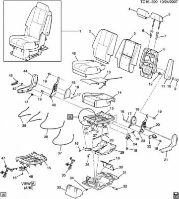

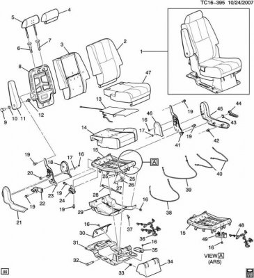

Parts Needed (follow link)
Oh, the power of the internet! :D
I found this information after doing some clever searching. I will provide the link because it is too long to copy and paste. Hopefully the links work.
Left Side Bucket Seat - HERE
Right Side Bucket Seat - HERE
I hope this helps. Of course, this is only the parts that are needed. I am still looking for some more information on the actual install.
It looks like we are definitely looking at #13 (20792750 - Seat Heater) and #48 (15843764 - Harness, Chassis Wiring, Seat Heater), and possibly #35 (25862293 Module, Front/Rear Seat Heater, Front Seat, Seat Heater) and #36 (15843765 Harness, Chassis Wiring, Seat Heater).
I will keep this thread updated as I gather more information. :Handshake:
