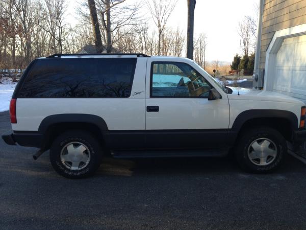

Here is a pic of the truck - all stock right now (and without a bath):
Planned mods:
Husky rubber mats (in)
Thule rack system and fairing (purchased)
OEM radio Ipod connector (purchased)
Frame surface rust treatment
Window Tint
New rims and tires
Brush Guard
Fog lights
Exhuast
New suspension parts (as things rust out)
