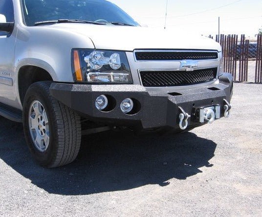

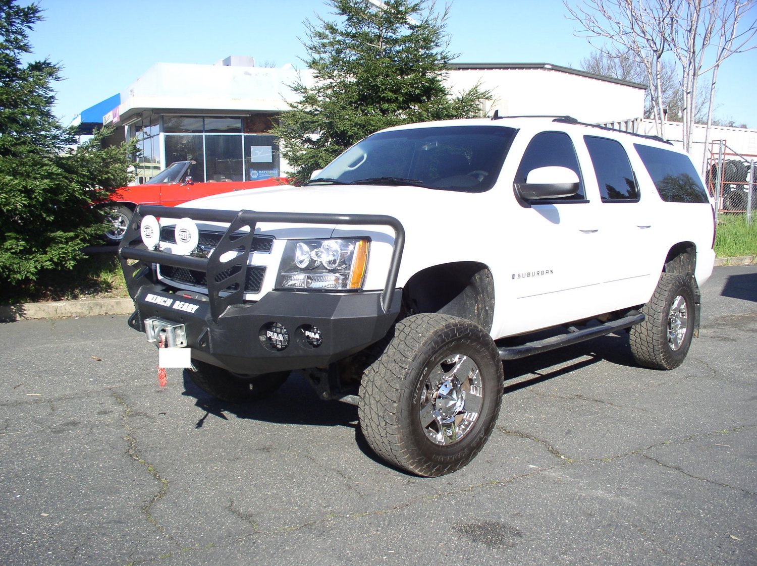

recently acquired a 2011 Chevy Suburban and it was wrecked from the front. i pretty much have all the parts except for the front bumper,
its been hard trying to find a good bumper cheap, especially the same color,
i checked ebay and they do not seem to be too expensive new, but the problem is that they do not come with the extra parts that go behind so you can attach them correctly and i do not have those parts at all, they were damaged by the wreck,
so i just got the idea of installing a heady duty front bumper with grill guard. like the Silverado's have.
i can see some online, but my question is, how would i install it, since the front bumper on a suburban is attached with the grill, all one piece,
do i have to buy a silverado grill? will it fit?

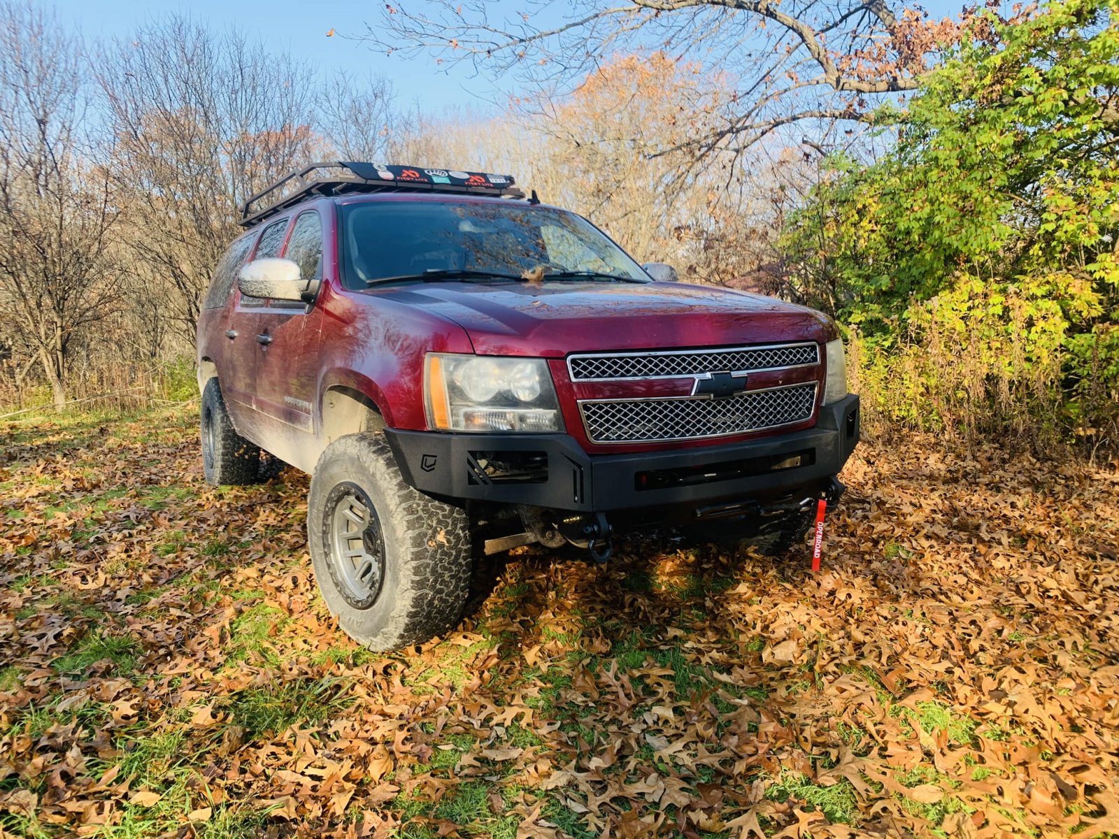

Check out baselineoverland.com Not so bulky and better lead time.

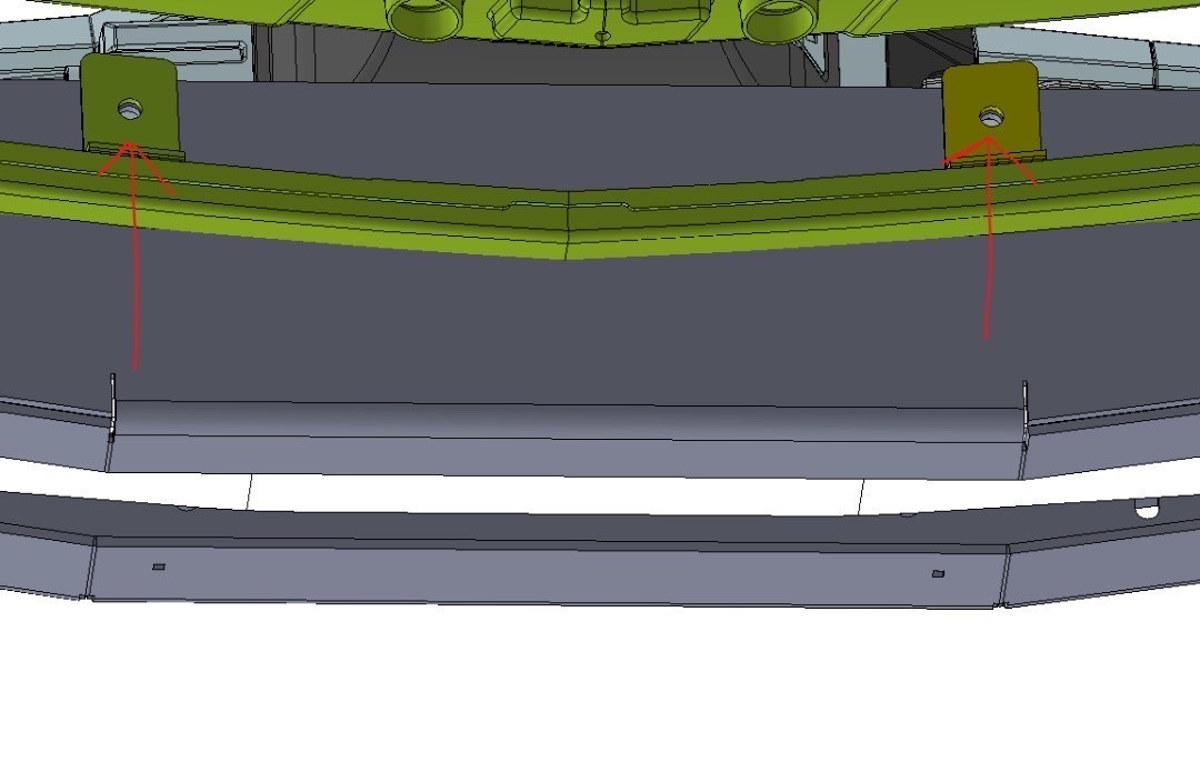

The front "grill" (bumper cover) gets trimmed at the body line. There are two tabs on the inside that attach to the top of the bumper.
You can order it raw steel and get it powder coated to match your truck if you want. There is an optional add on brush guard as well.
