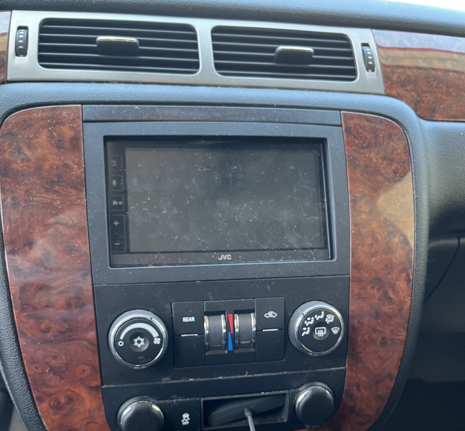

I have a 2013 Tahoe ppv. It’s got the basic heater and ac controls. Is it possible to upgrade the control panel to one with better controls?

Picture of current controls

not without a LOT of work, basically if you have a lot of free time and money to throw around and want to tear the dash out, then no
the digital controls use sensors that are inside the hvac duct work and rear duct work and in the headliner. and the wiring harness would need to be changed out as well
