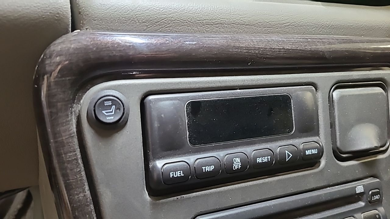

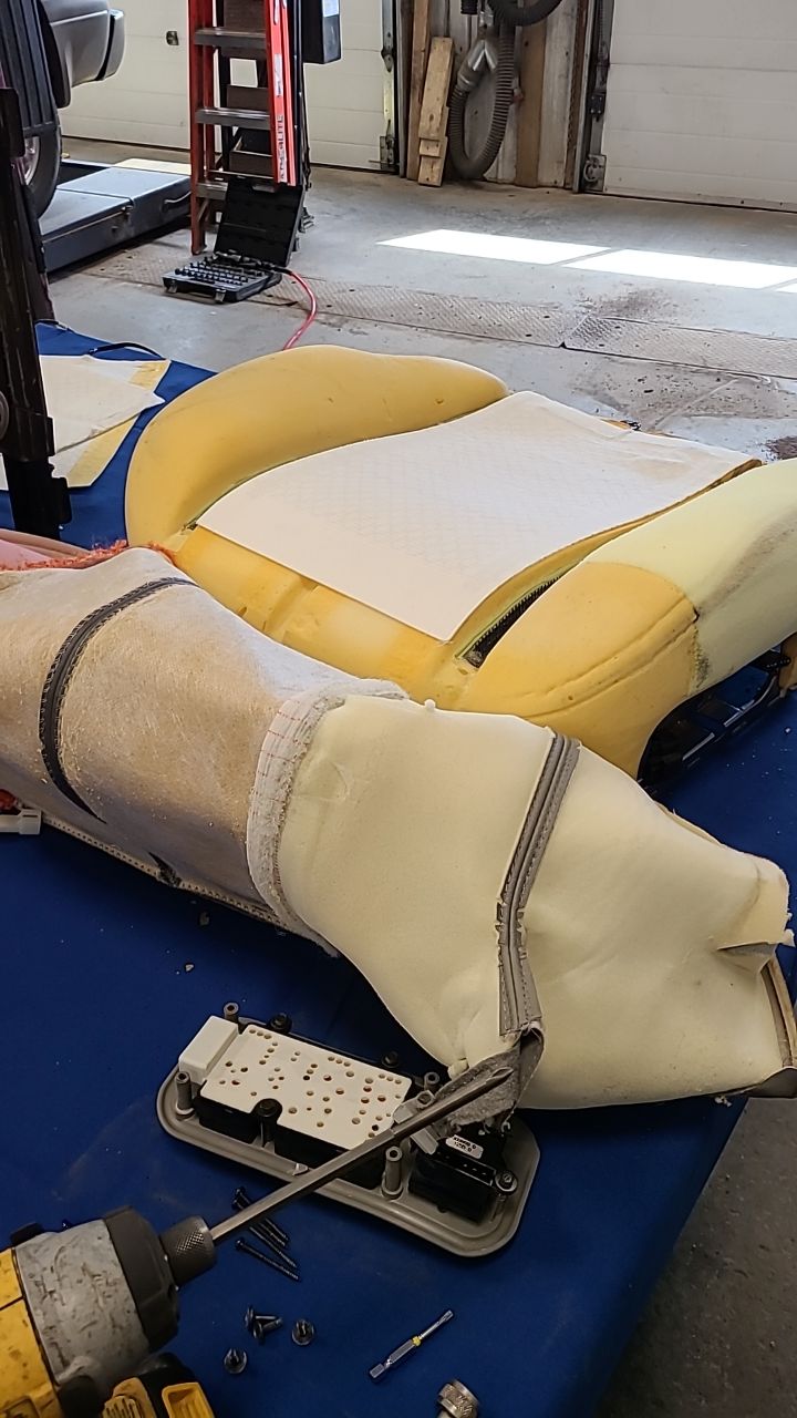

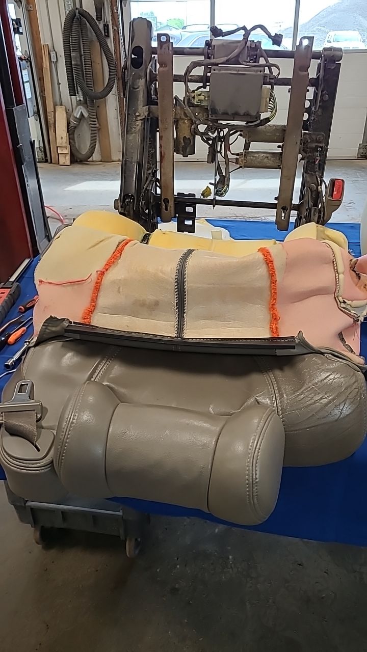

I FINALLY replace my drivers seat heater elements. It only took about 2.5 hours. I ran the wiring through the center console and mounted the switch in the dash. There is a small fuse box on the left side by the drivers left foot which is where i got ignition on power from. I'm happy with the result. I was dreading the work but it really wasn't a bad job to do.
