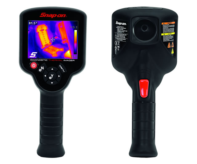

This tool makes diag on heated seat easy to tell if it’s working or not. You can pick up a Milwaukee version from home depo. A lot of the times a section of the heating element shorts out rips or breaks. Once that happens current can’t flow and it won’t get warm.
