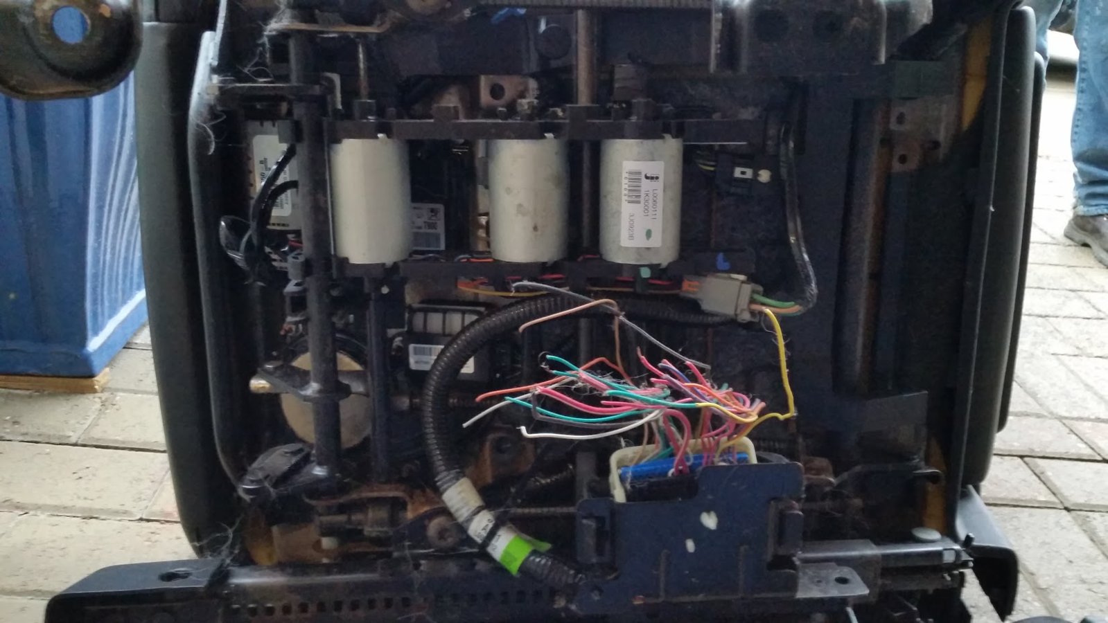

Looking for heated leather seats for my SSV. 90% of the use for this vehicle is towing snowmobiles, sits more than it should in the summer. Instead I find a set of heated/cooled ones for half the price of anything else.
Sounds like fun... :)
The cooling system is self contained peltier / thermoelectic deal, not tied to AC or vents. Heat works off the same setup.
First concern is that these don't heat up as well as good old fashioned heating element.
Does anyone have experience or opinions on the heat part of a heated/cooled seats?
I'm not really concerned about the wiring. I would not worry about the factory switches, I have no problems adding a couple of toggles to the console. I would kind of rather wire it my own way anyways, get it to kick on with the remote start. Plenty of extra power wires to work with a cop Tahoe.
But what about the air bag? I read a few threads about air bag warnings or the need to have the BCM tweaked.
And the other part, anyone have a wiring diagram to make this a little easier?
