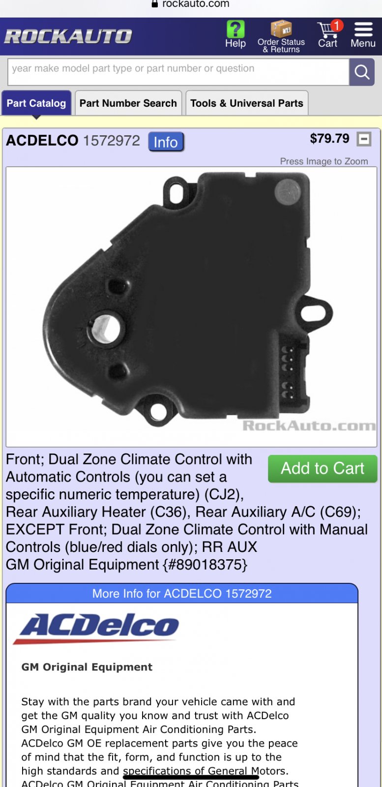

Blend door actuators are known to fail in these vehicles. My guess is that is what you are dealing with.
wjburken
Dec 26, 2017
10,314
29,542
Eastern Iowa
Something like this.
H
houston_t
Jul 1, 2020
Do you know the location for the drivers side actuator ? Is it the one under the dash around the ashtray area ?
