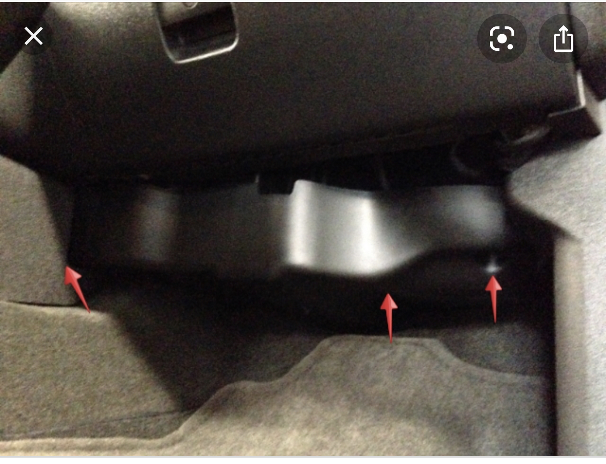

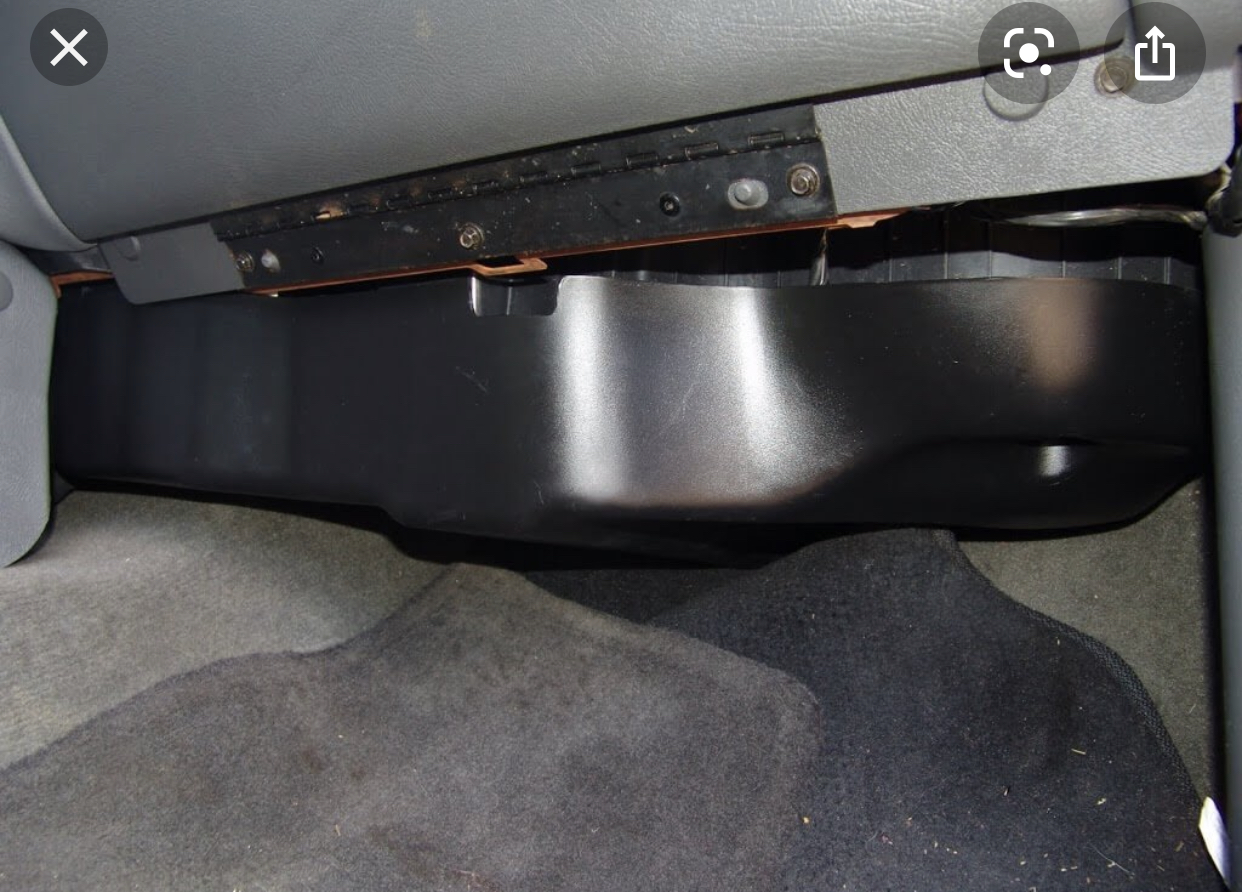

Yeah, mouse piss has that distinctive smell. Go up under the dash on the passenger side and pull down the kick plate... 5-6 screws. Youll see the blower motor and filter cover ( if installed) I’d start there. They prob have the nest right under the kick plate.

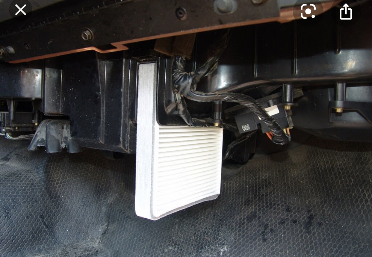

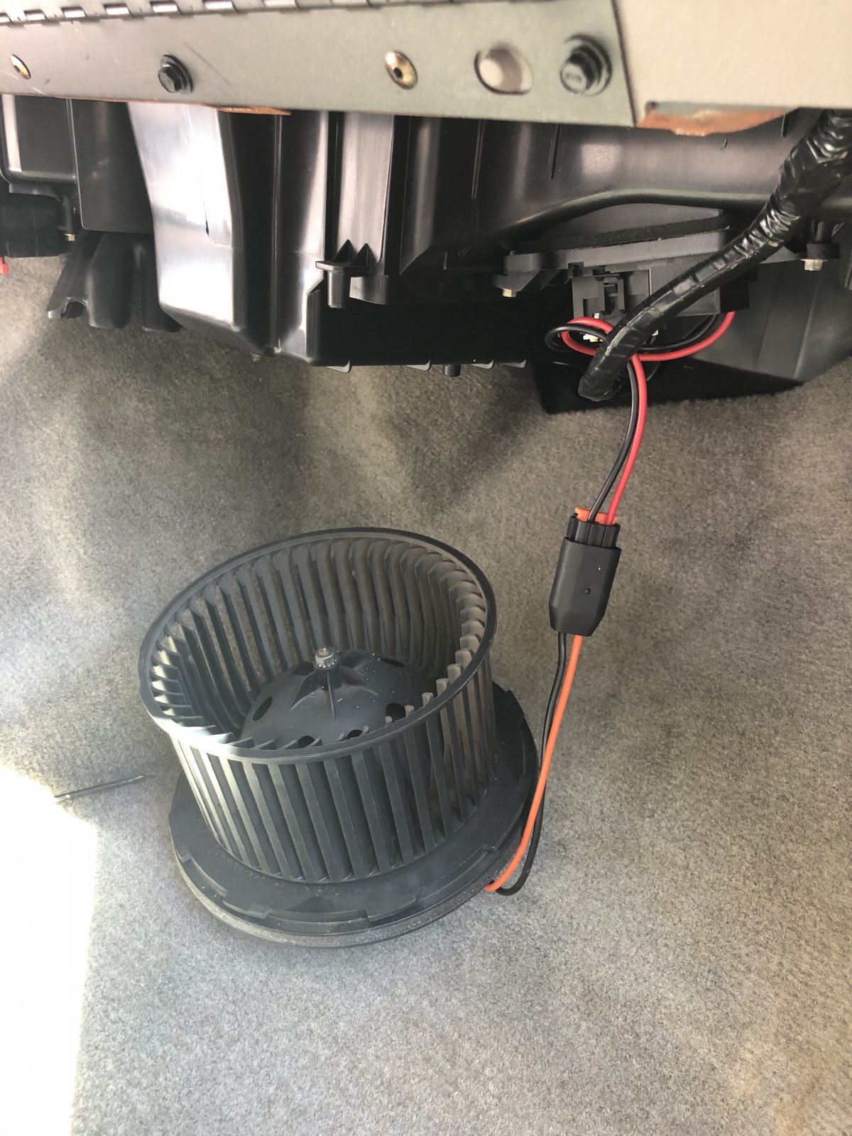

Here’s some pics

Thanks for the pics, will take a look in there. The Tahoe has rear heat and AC as well but the smell only comes out when running front heat. Yeah unfortunately I have enough experience dealing with mice that I have learned their smells

I dont see where the cabin filter is but feel free to educate me. I was trying to see how I could access the area to the left of the blower, towards the driver side, to check in there but I couldnt find anything online other than instructions for removing the dash to change the heater core.

2005 didn't have a cabin filter. Mine had a bad smell and I sprayed an entire can of lysol into the AC air intake to kill the bacteria.
