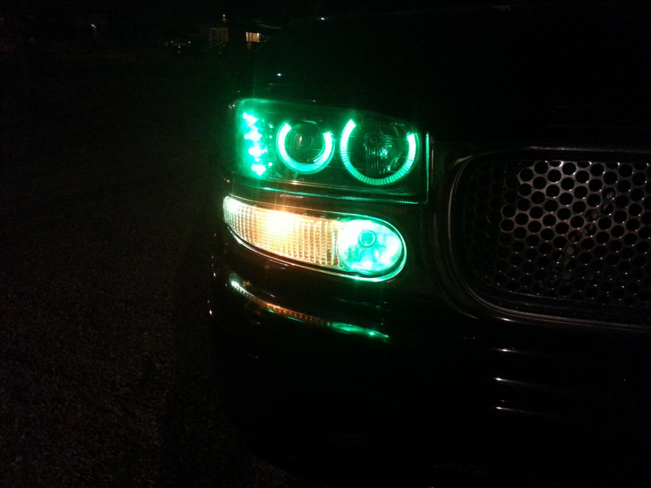

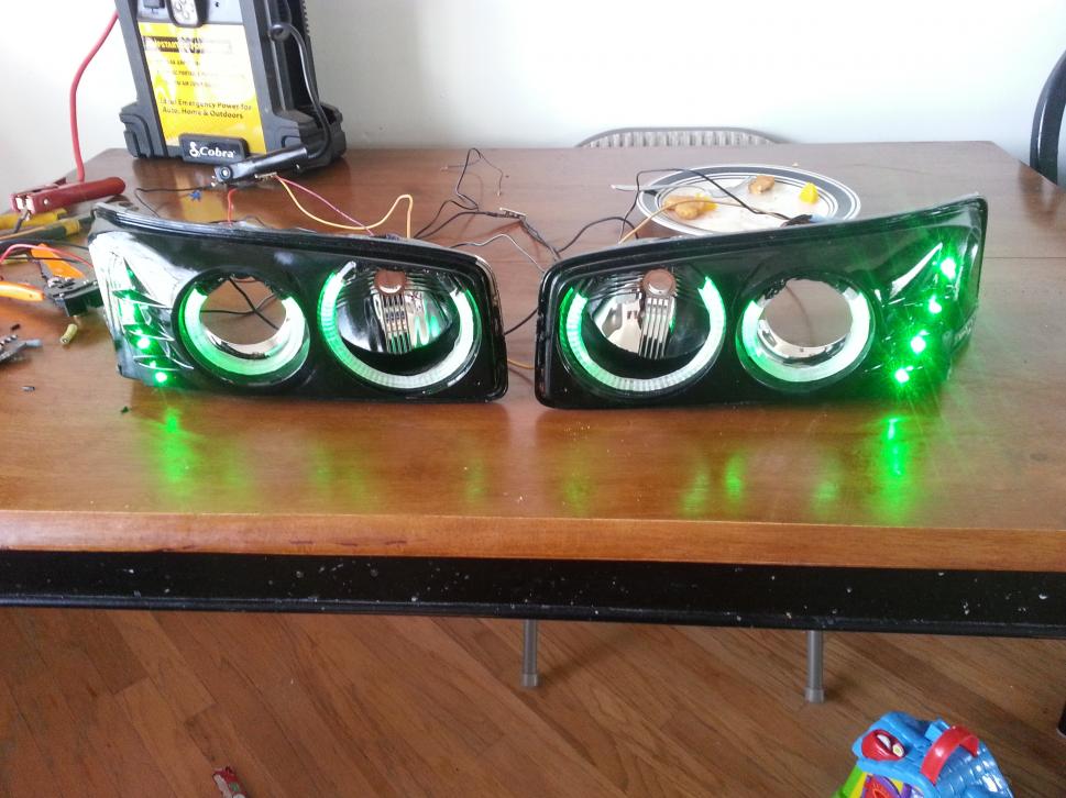

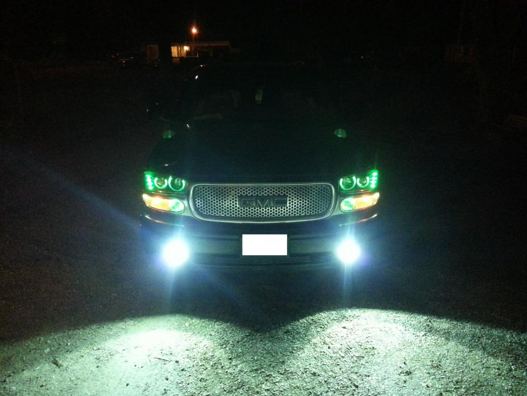

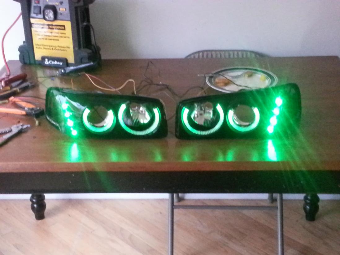

I just painted my headlights and added green LEDs and made my own angel LED lights. See what you think.

was wondering where you got your foglight bulbs at i don't like my stock ones they don't light up very bright....are they hid or no? i have hid headlights but can't decide if i should do the fogs or not

Yes the fog lights are 35w HID 6000k kit. Boy do they make a difference. I would highly recommend them. They are from DDM tunning. They recommended I don't use the 55w kit for the fogs due to the amount of heat put off by them in small housing. Could melt the light housing. My headlights are 55w HID 8000k and the 35w 6000k match perfect together.
No they are not legal really but I live a in small town and when the lights are on you can't tell very well. So I am not too worried. If I have trouble, they are an easy fix back to white LEDs.
As for making the Angel eyes, there is a youtube video on how to make them. just type in angel eyes. Use window Blinds rod and an oven to shape them the way you want them. Its easy but time consuming. I bought the LEDs off ebay and they came pre-wire with the resistor set up for any 12v system.
