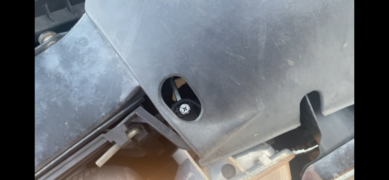

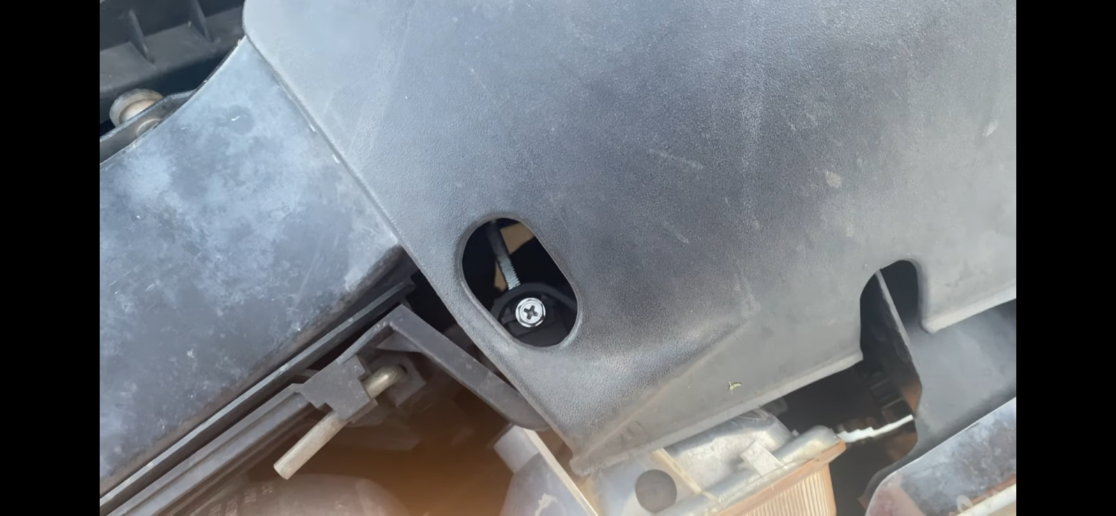

They're basically like these (screenshot from YouTube), but with Torx drive. I've seen a few that appear somewhat similar, but will look again. Thanks for the assists so far.

you have to pull the headlight out to replace the adjusters, those 2 L pins just twist open pull up and out
Thanks. We’re going to try the scrapyard again soon. Last week, they were all rusted to junk.

ya any adjuster from a 00-06 tahoe, yukon, suburban, sierra, silverado, avalanche will fit and work
the yukon/denali have a different headlight shape but the adjuster will fit, not sure on the escalades.
