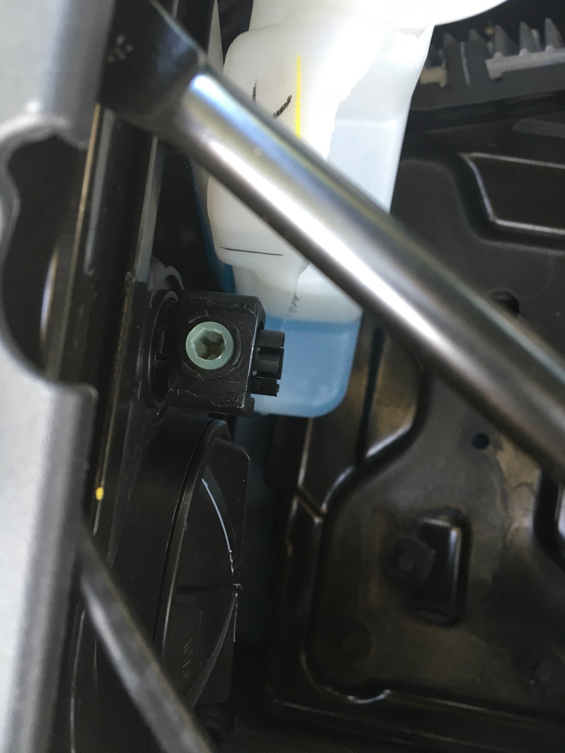

Is this the up/down adjustment screw for the headlights?

Yes that is the screw. The horizontal cut off line at 25 ft. should be at the same height as the center of the headlight as in the projector lens. It can be on the line or slightly lower on low beam. The adjustment i think is in the owners manual.Or get the shop to adj. it to spec.
