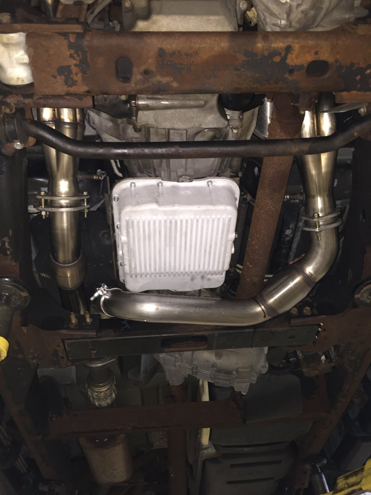

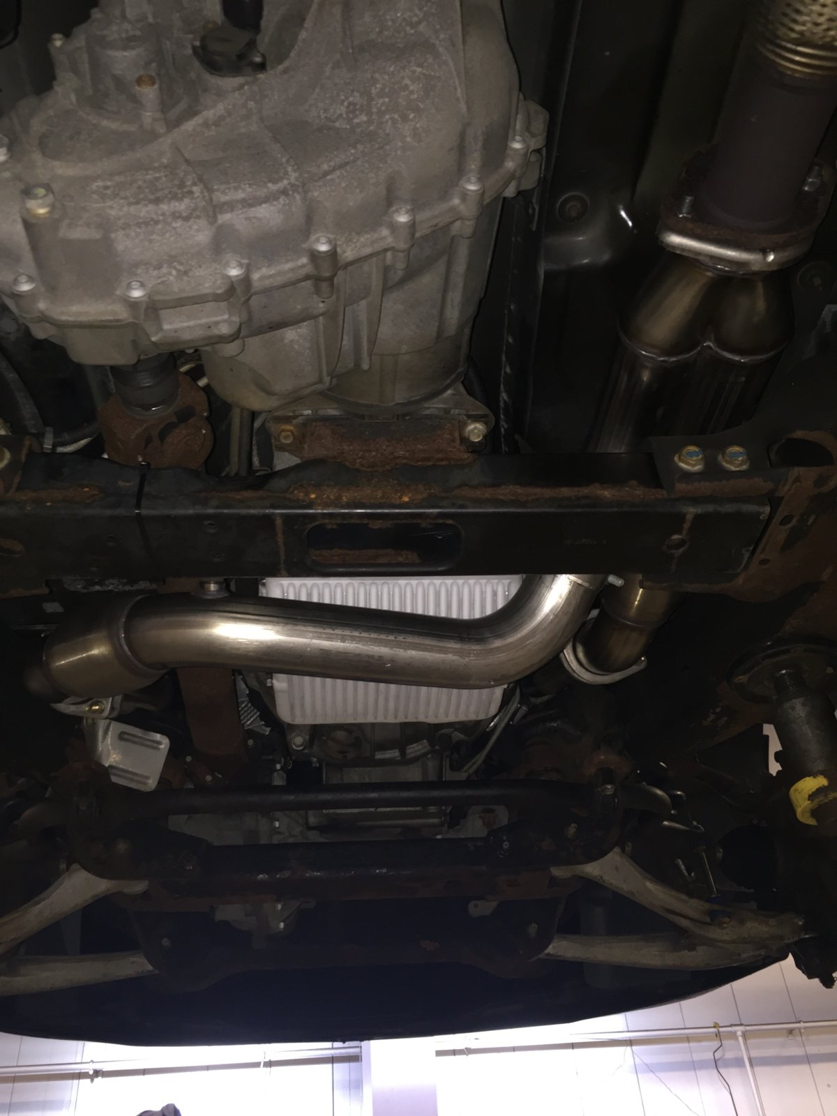

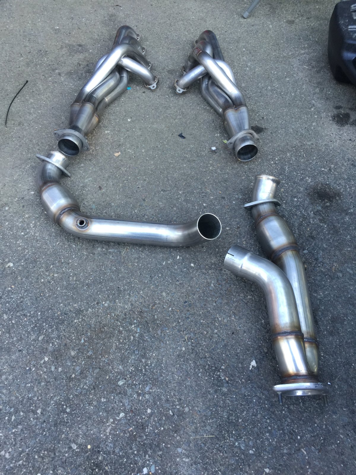

I had room, I used the Random technology C6 high flow catalic converters but had to get them welded. When I have time i'll take some pictures

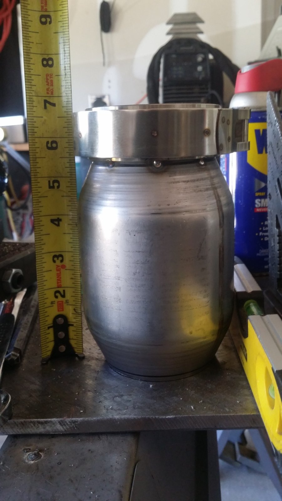

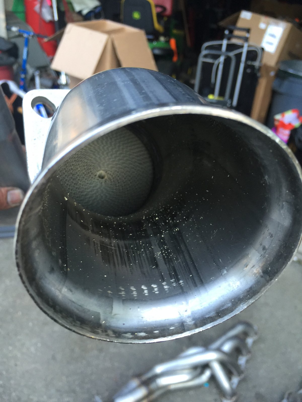

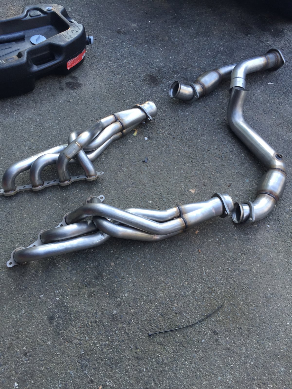

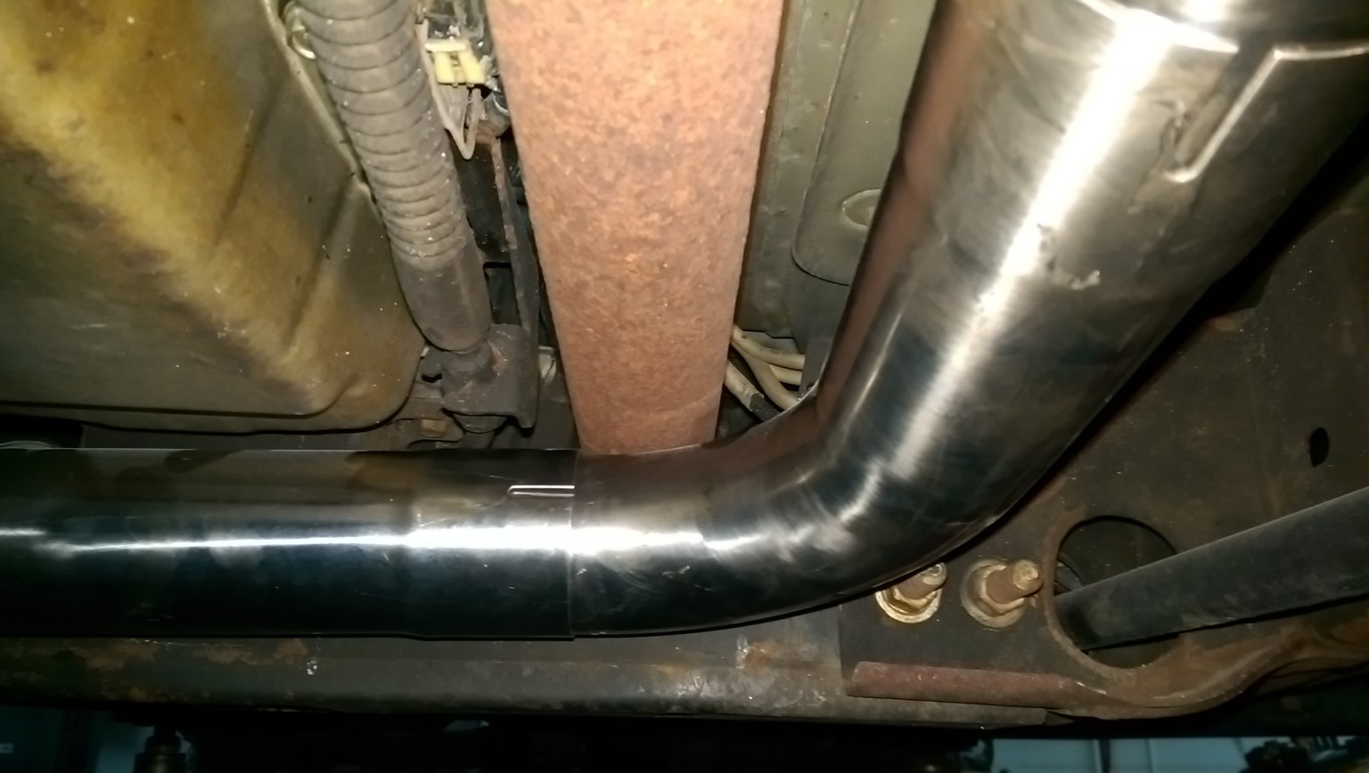

I'm going to be using Magnaflow high flow cats for my install. They started out as 2.5" but I turned them down to 3" to make them as small and compact as possible.
Ivan, looking forward to seeing yours.
Tony, looks great man. Must sound killer

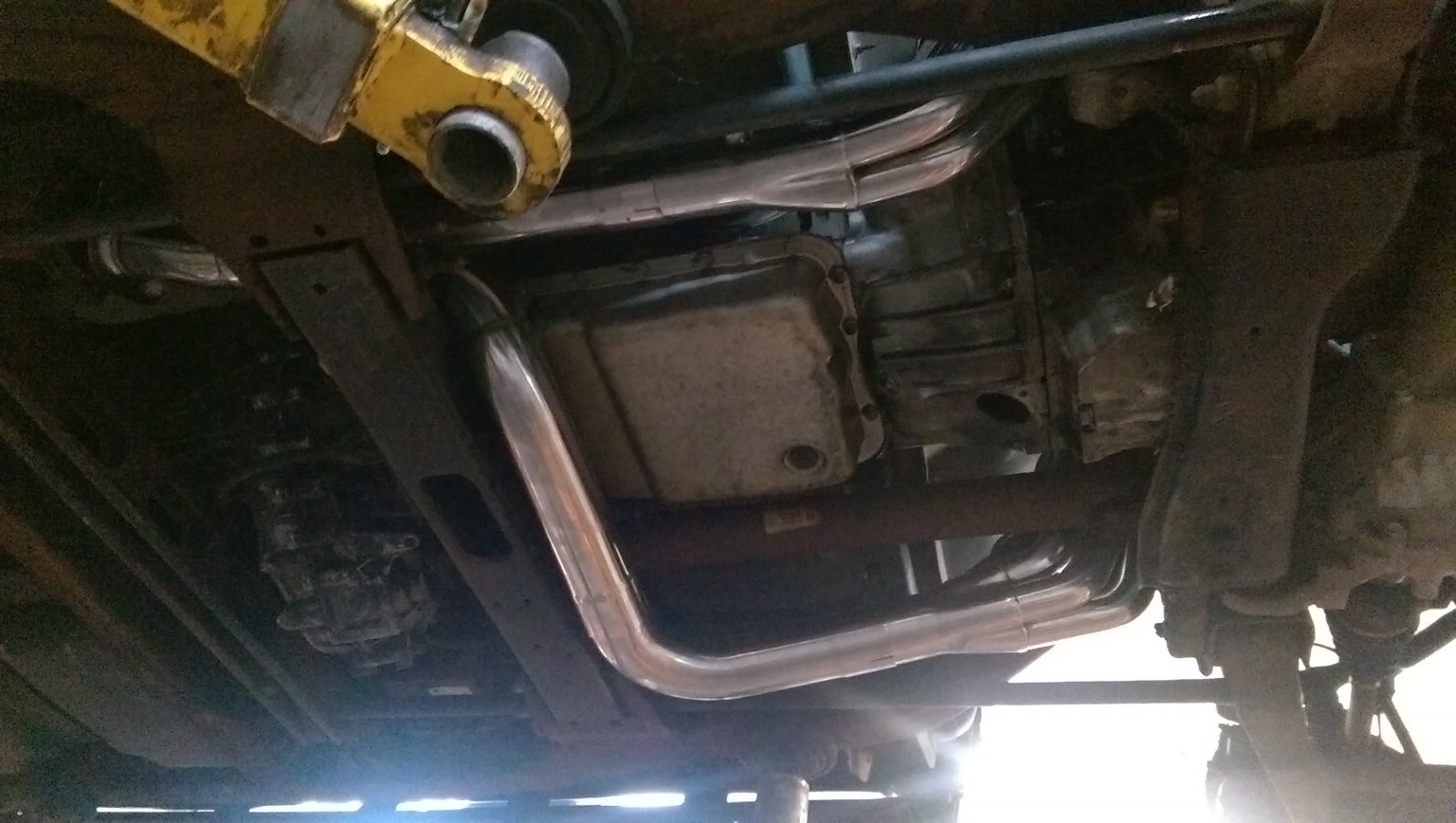

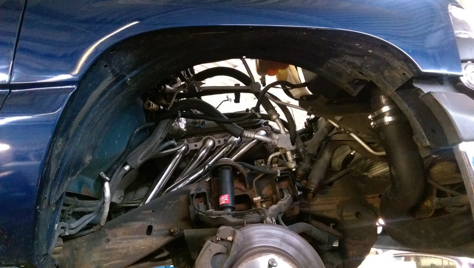

I actually have the pics on my build thread. There's no prop shaft on, so you won't see any rubbing now.
