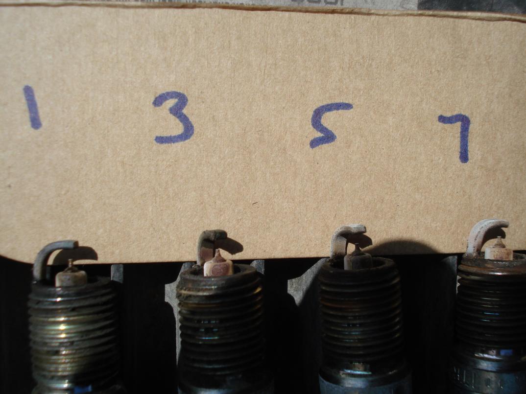

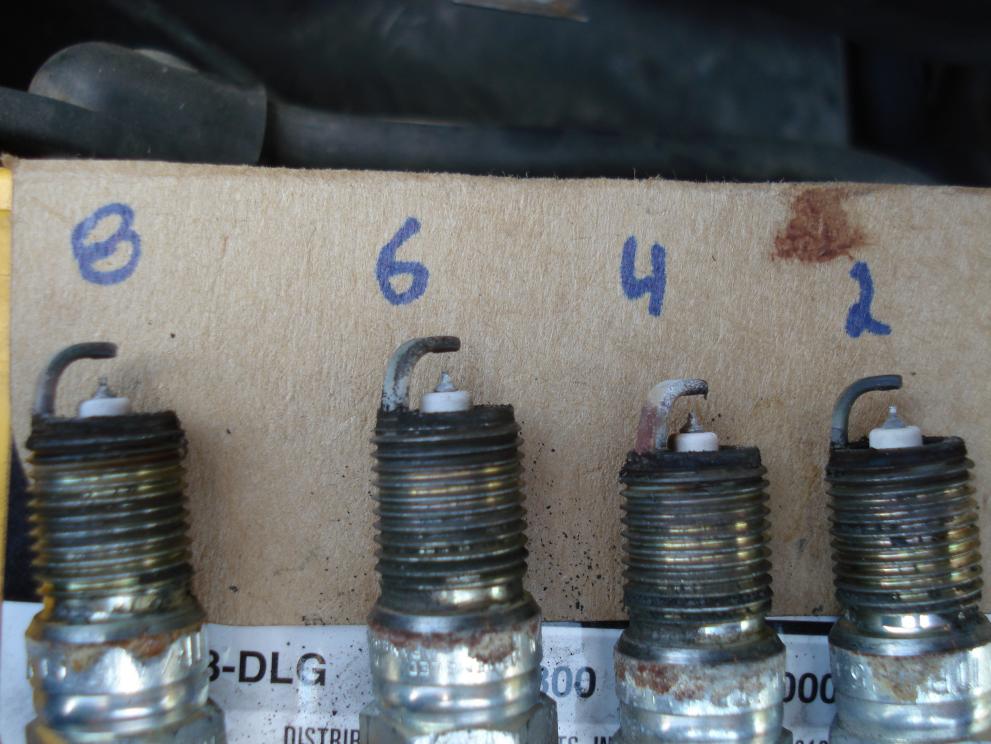

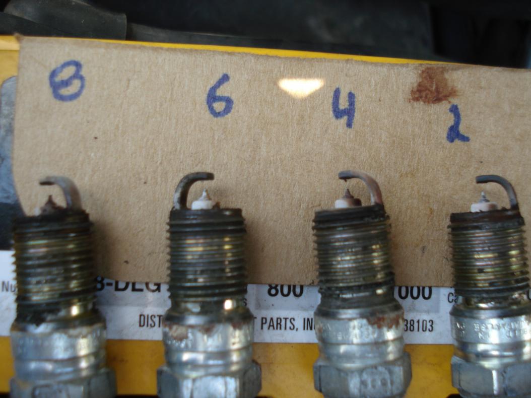

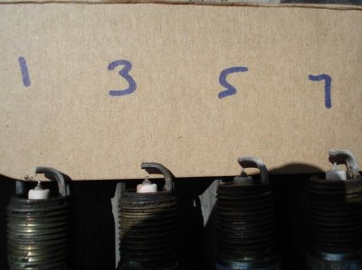

I pulled the spark plugs yesterday. They were changed about 2.5 years ago and have about 43K miles on them. All of the above mentioned work was done at that time, not a year ago. What do ya'll think?

Looks fine to me, the redish area is deposits from additives, the white ash is normal. You may have a fuel distribution issue as seen from the amt of ash that changes from one cylinder to the next.

must be the pic. some of them dont look right. must have some harsh fuel and additives for them to look like that. you could test for leaks head cracks one way by using a combustion leak detector. it has a fluid inside that reacts to combustion gases. you hold it against the radiator neck opening while engine is running. also if you are sure you have no air in the cooling system. look for bubbling in the reservoir tank when running as gases will go there too.
