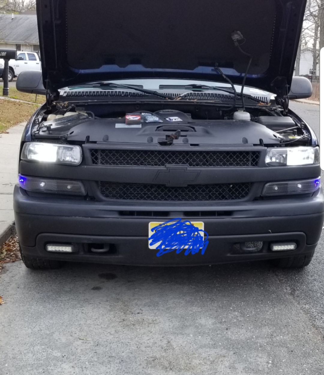

I used an HD grill with my stock bumper pad. I did need to trim the bottom of the grill. 20200610_153539.jpg
