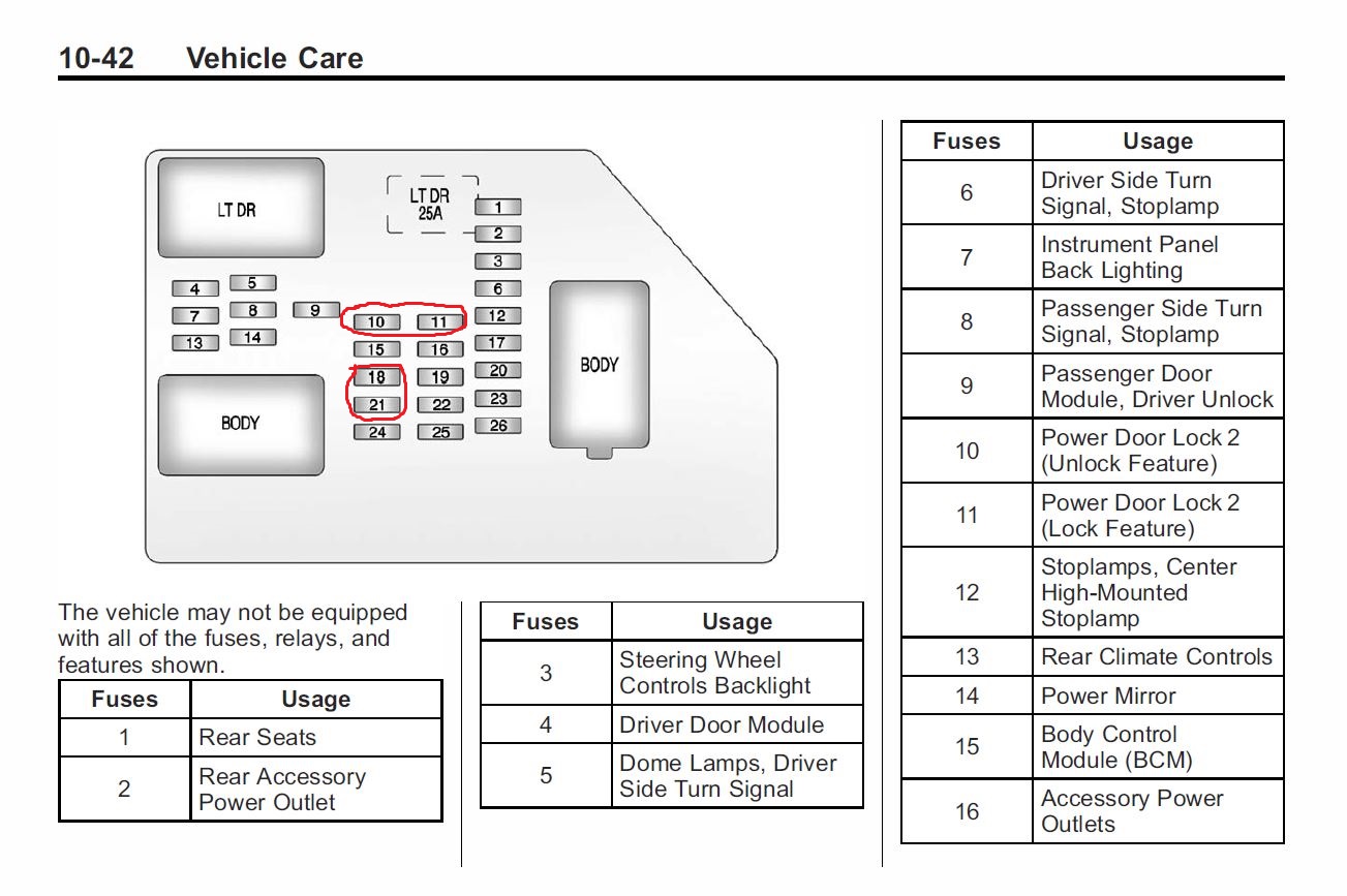

I guess these trucks are more likely to be the door lock actuators which can be purchased online pretty reasonable and installed yourself, but just to rule it out on the drivers side dash when you open the drivers door on the left end cap of the dash there is a plastic cover that comes off and there is some fuses in there you will want to check #10, 11, 18, 21

ya, there is only a couple circuit breakers for the windows, looks like one for the drivers side and one for the passenger side, the drivers side is the one labeled "lt door" on the pic above, the other is cb4 under the left side of steering column, but I would check to be sure they aren't locked out from the drivers control switch, I can lock mine so my kids don't sit there and play with them all day, on the nbs the same lock would work for the passenger front also but on these trucks it no longer does.
