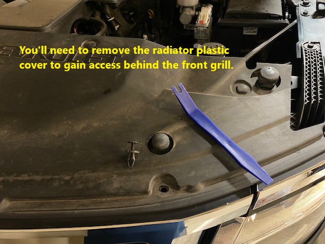

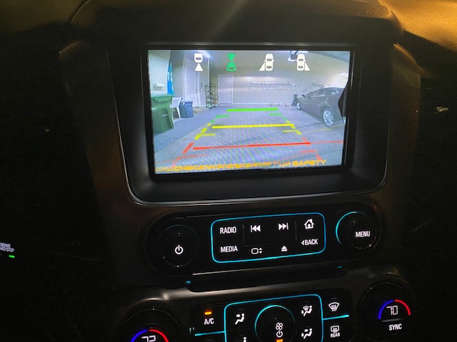

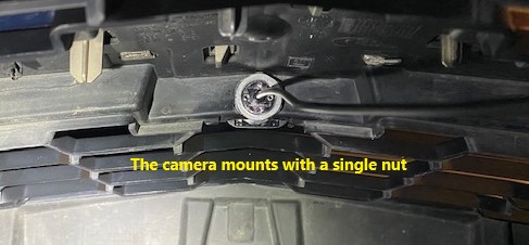

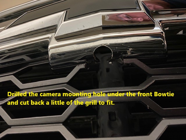

Front Camera installation for 2019 Tahoe
Mounting the camera in the grill was easy.
I had installed a “Navtool” iPhone mirroring device about 6 months ago. This device allows you to watch any video on the Tahoe Infotainment screen while in motion. The device also has 4 camera input plugs.
The device is a little more involved to install. For Installation, you have to remove part of the lower dash, the top of the console, and a panel behind the glove box. Their YouTube video helps.
