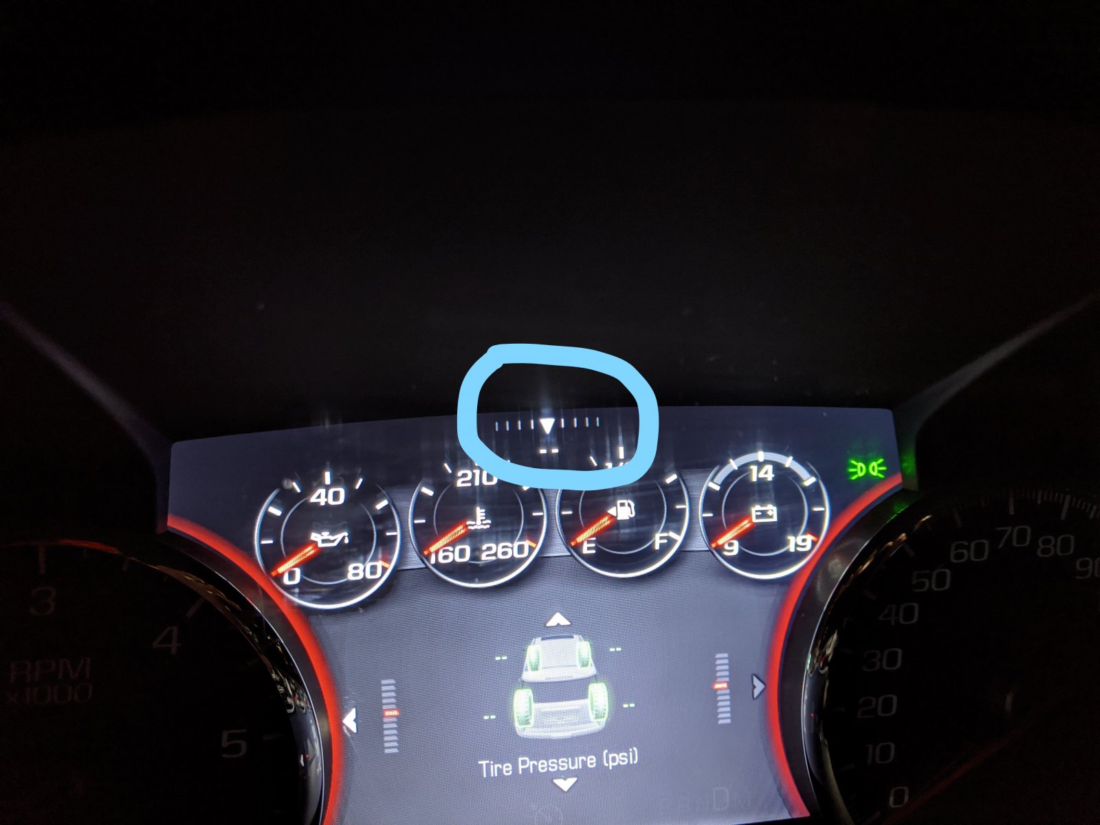

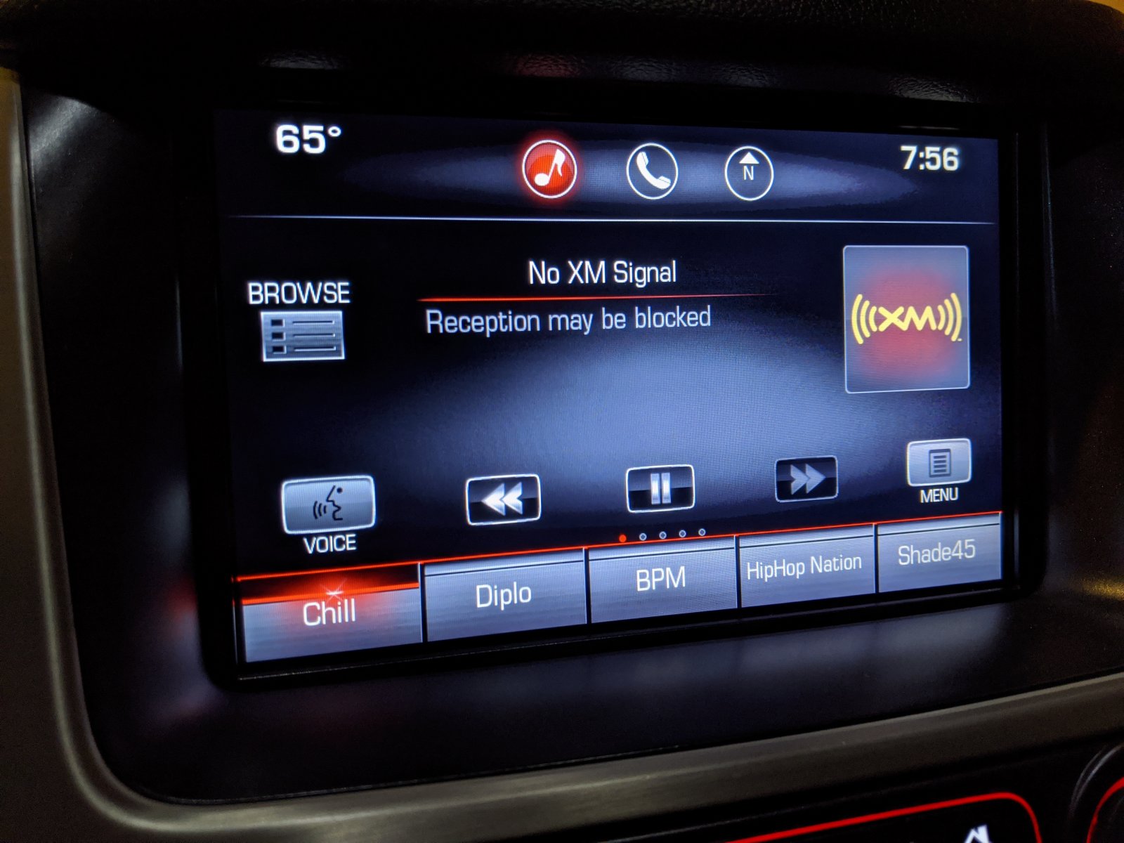

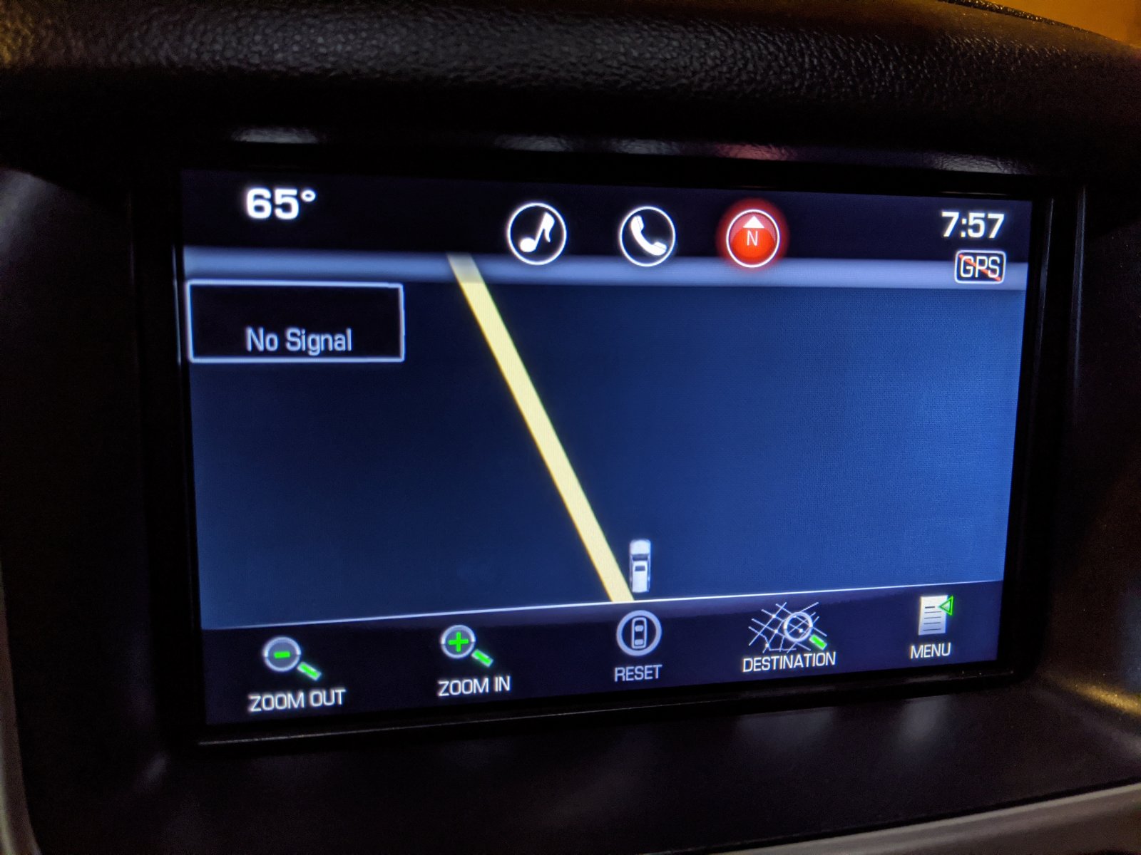

Hey all. Has anyone had trouble with GPS, Compass, and XM radio all going out around the same time?
Read a few posts online that the antenna could be leaking but am not sure how a leak to the antenna is going to cause all 3 to go out.... is there a GPS unit behind the radio or something that I can check to specifically confirm what has failed?
If I leave the XM radio station tuned it will eventually connect for a couple seconds after 15-20 minutes and then go out again.
Thanks for the help

Get a bi-directional scan tool on the truck and it will tell you in moments what is up. When the gasket around my shark fin was leaking, water would drip down the COAX cable and knock out the GPS and Onstar until it evaporated and all was well again.

I had the problem on my 16 and 17 Suburbans. In both cases, the shark antenna needed replacement because water had ruined the connections which disabled the compass and made Onstar think I was someplace I was not.

Most likely the high frequency antenna. They get water inside them and they fail.
