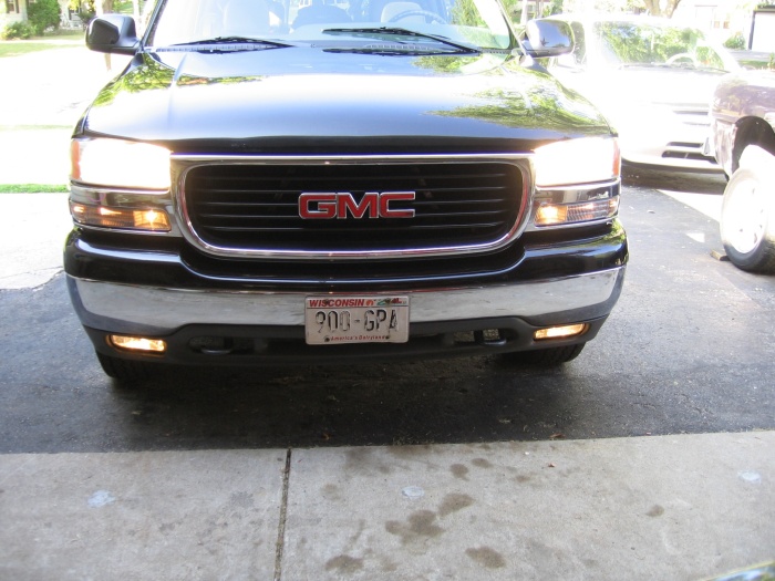

Got to tinker and mod a bit today.
yooformula
Sep 6, 2009
271
Milwaukee, Wi.

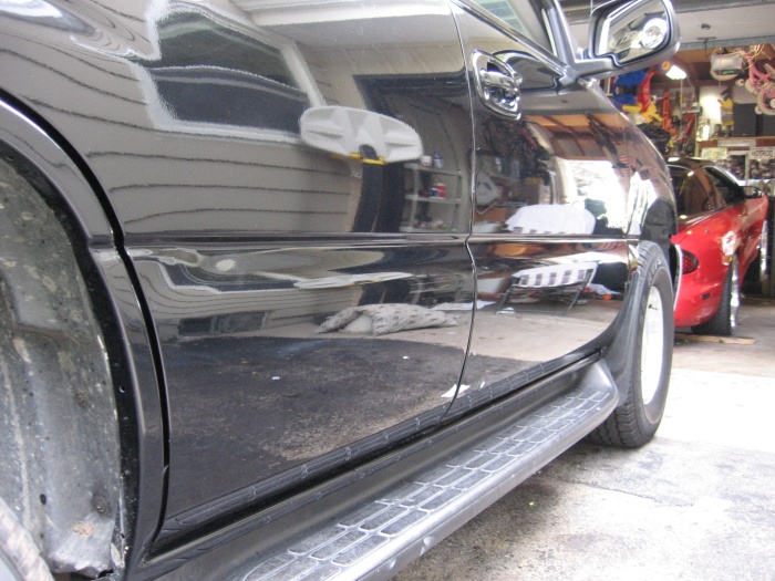

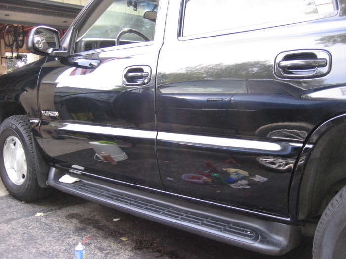

sorry the settings were off on my camera so the after pics look washed out and over brightened. Suprisingly the black on this 03 is very glossy and deep with practically no fading.
before..

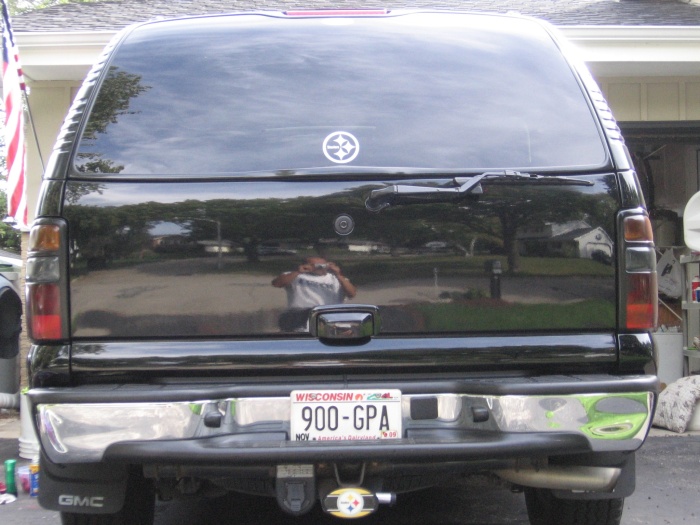

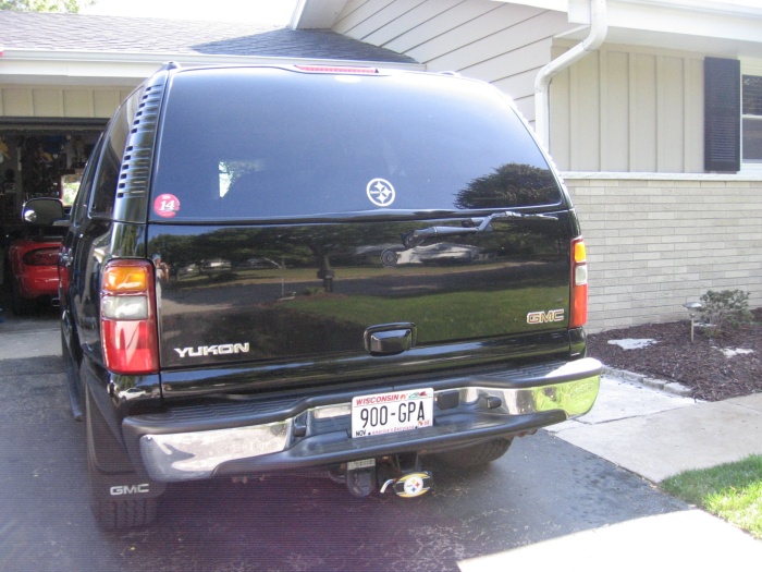

after....tails tinted and trimmed, debadged.

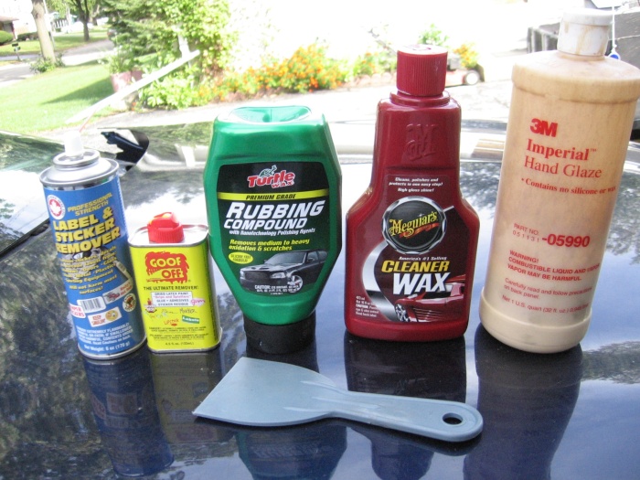

my debadging tool kit.
I liked the Yukon logo so that stayed.

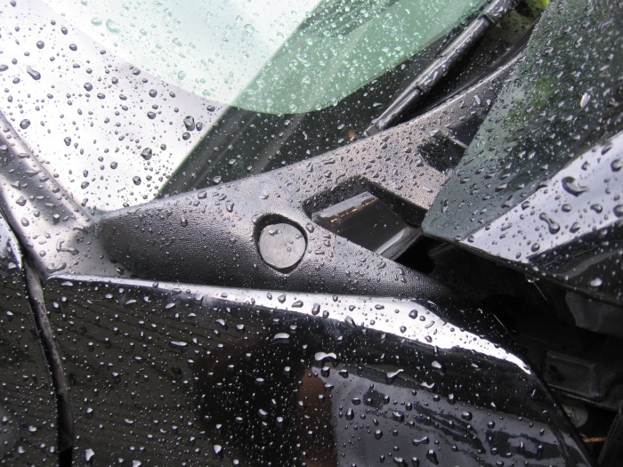

relocated the antenna and grounded it with no loss of stations.

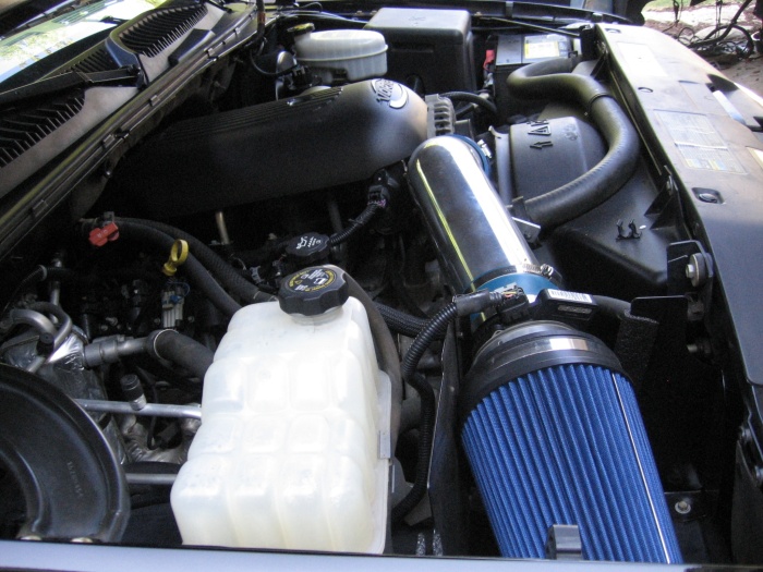

ebay cai with bottom plate removed.

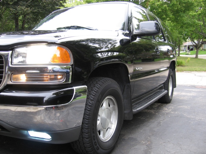

did the low 6/hi 8 mod, new set of smoked clear corners, silverstar lo/high's and have a set of hid's for the foglights to install tomorrow.
To round it all off, I swapped out all fluids to RP, got a tweak on my tune and swapped plugs/wires. Spring should bring the REAL mods...:)

and btw where did you relocate your antennae to? pics? explanation?

I got the antenna delete tip from here..

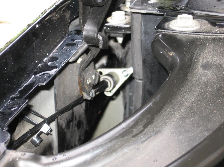

it runs along the fender and strapped with wire ties. Crappy pic but you can get the idea. I just unbolted the base of the antenna after removing it then routed it under the hinge and used some eyelet crimps with a piece of wire to ground the base to the mounting location.

does that hurt the antenna strength enough to notice?
I went through every channel I had saved on presets and NONE were affected. I had read that for some that lost a channel or two, grounding it out reclaimed the lost channels so I grounded it out just in case.

yooformula how's that CAI Doing for you ?
Link me please ? i would like to check it out
Seems to work fine. here is the link to the one I bought but I have also seen the Spectre brand cai at autozone for the same price less the shipping. the only thing I wasnt crazy about was the instructions and I had to trim the upper shroud just a bit(seemed a bit too tight of a fit for me)with some trimming shears. I also ended up removing the lower airbox plate for more cooler air.
T3rry
Jul 29, 2009
299
Calgary, Alberta, Canada
i have the same CAI, the only thing i still need to do with it is buy an AEM dry filter... i don't know if the ebay filter is dry, but i really doubt it
