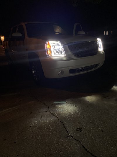

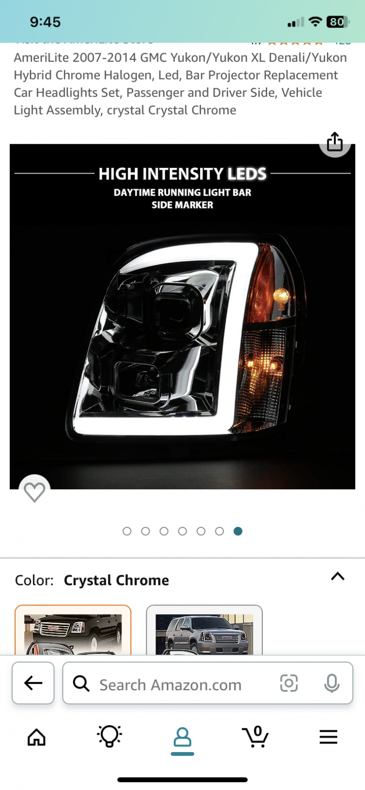

They have LED parking lights in them and they are big. They look good when they on with the headlights. I’d like for them to be on instead of the DRL headlights. How would I reconfigure wiring to keep the LED parking lights on?

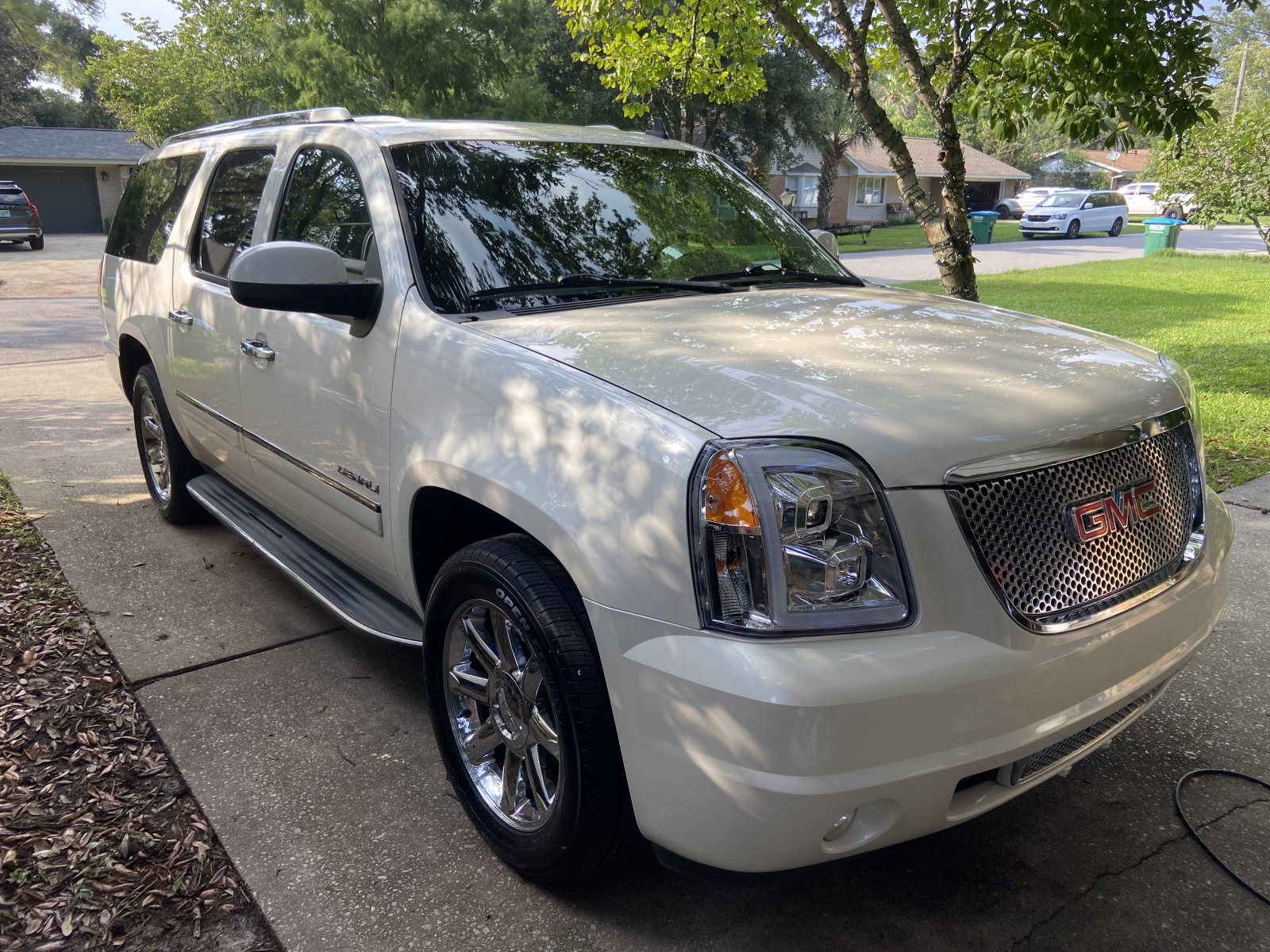

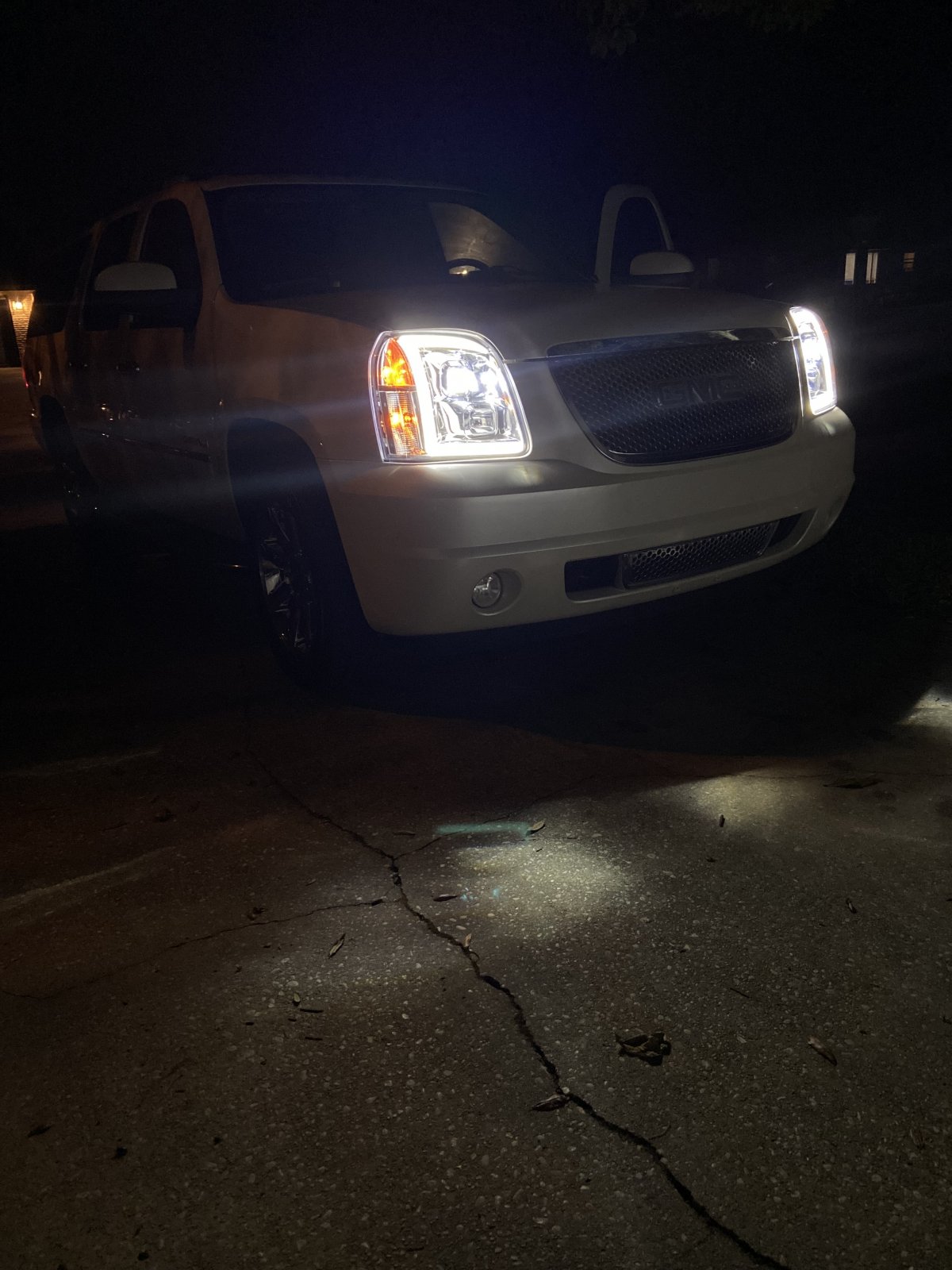

I got a little ahead of myself. Thank you for letting me know. It’s a 2012 Yukon XL Denali. I’ll include a pic.

You're going to have to figure out and offer up a lot more information than a picture of your rig with the headlights if you're looking for help and input on how to have the LED parking light strips illuminate as the DRL. Especially since they're aftermarket.
How does the LED strip operate now?
What illuminates as the DRL?
If you use the headlight switch and turn from auto to just parking/running lights does the DRL strip illuminate by itself that way?
Is the to projector low beam and bottom reflector high beam?
What connections or plus are on the back of the headlight housing?

The Yukon uses the low beam headlight bulb as the DRL, unlike the Tahoe which has a seperate bulb for it.
These housings have the LED bar wired with the parking lights. They can easily be rewired to the low beam harness and come on when the headlights are on, but not sure if they'd come on with the DRLs since the DRL circuit uses a lower voltage to the low beam headlight. Even if the LED bar works with the lower voltage, the low beam headlight will still come on also as a DRL
@Doubeleive bought some headlight housings that have a LED C shaped strip in them that gets wired directly to somewhere under the hood that come on as the DRL, but they were pricey, like $1200. Maybe he has more insight how to wire these, or what needs to be done to just have the LED as the DRL

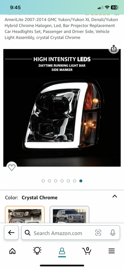

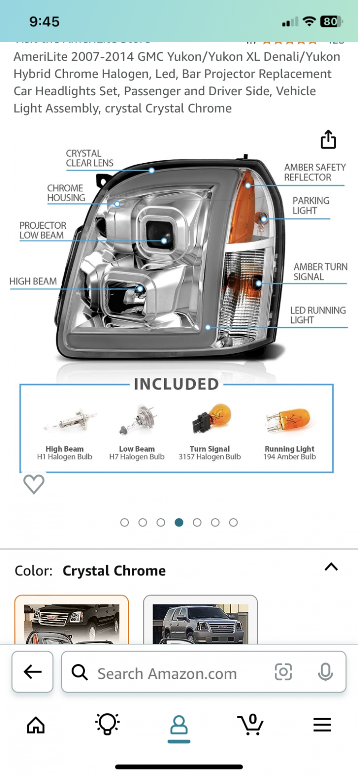

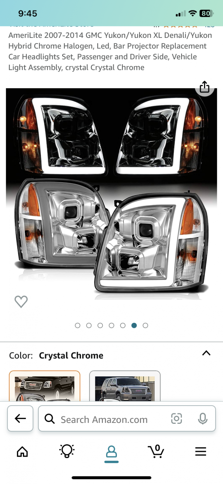

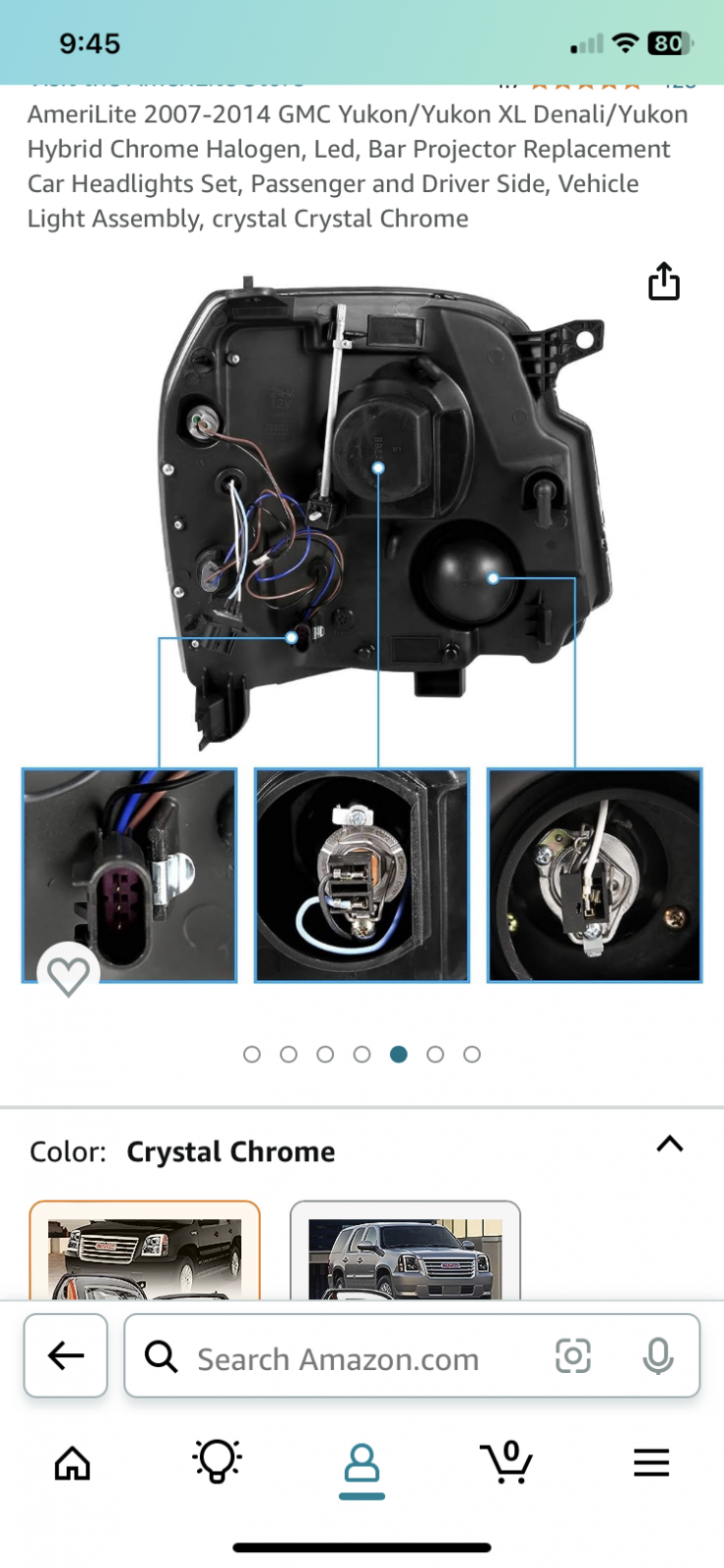

Hope these pics help. They are from the manufacturer. They were plug and play for my Yukon.

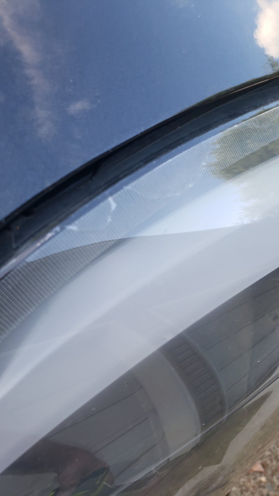

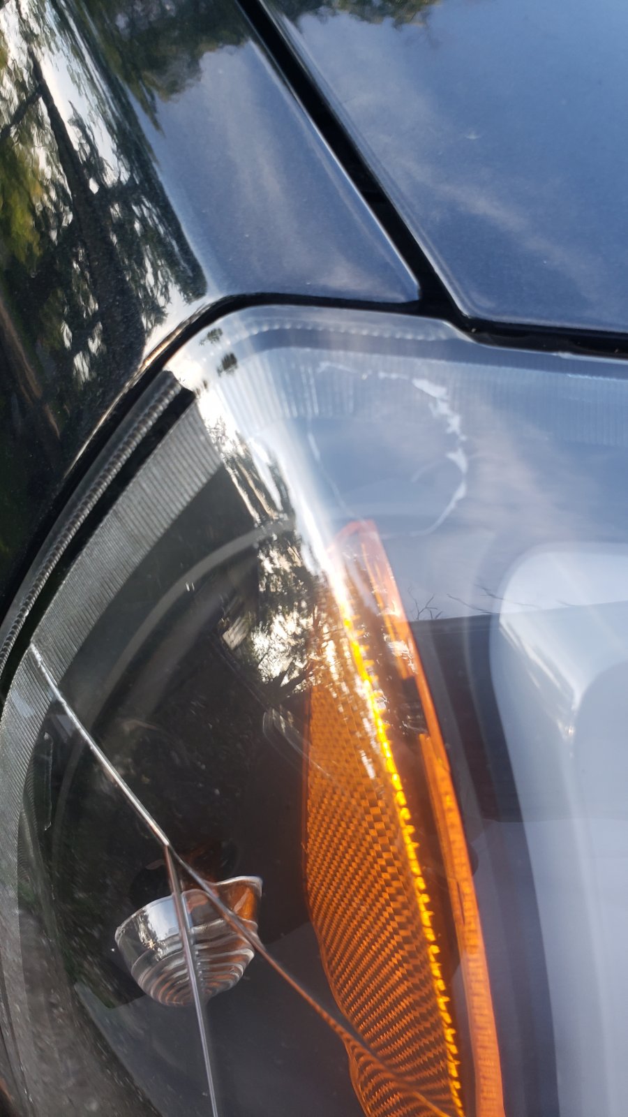

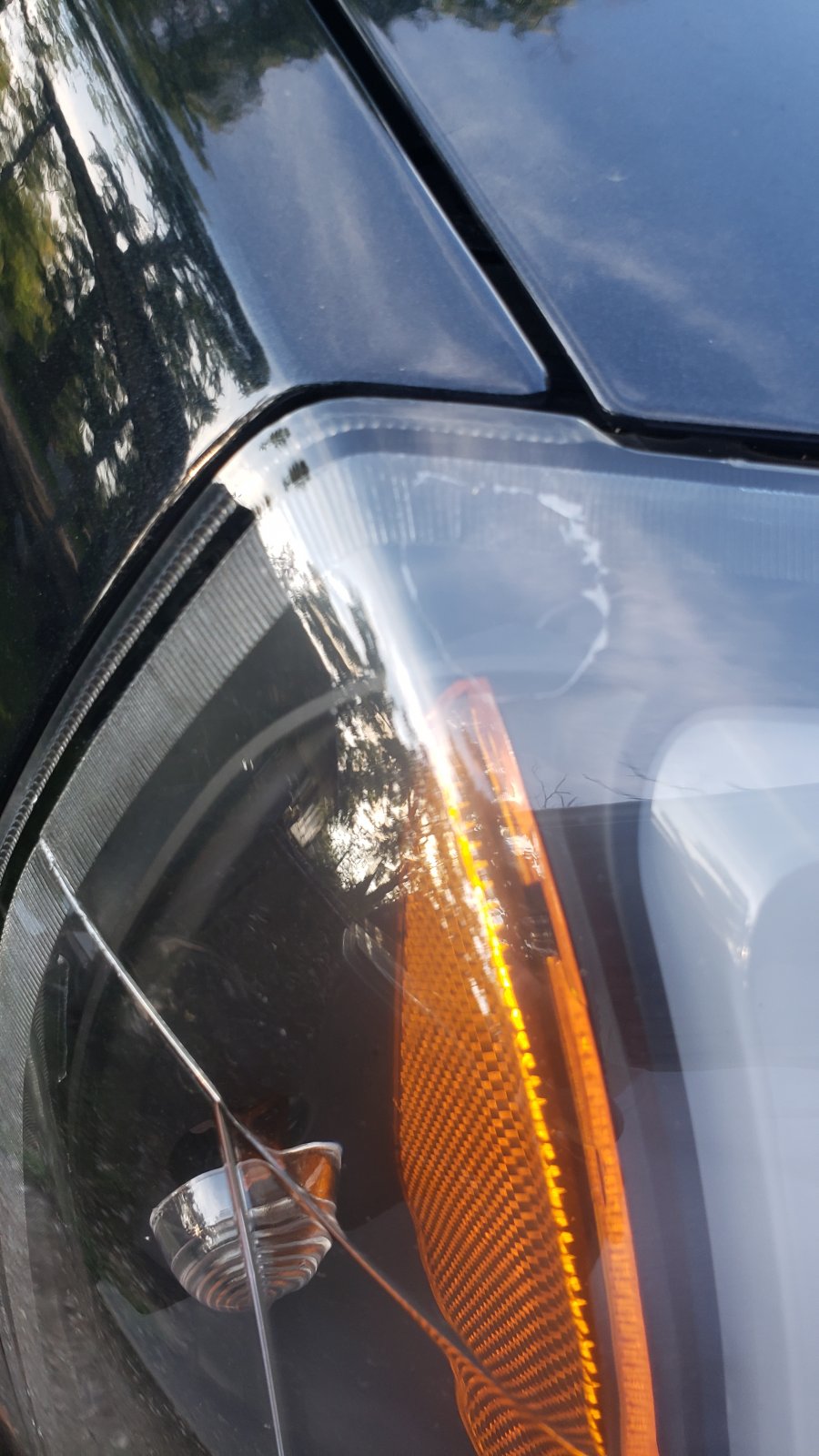

I have the same headlights, but smoked. I noticed a couple months ago that the thin, clear coating on the outside of the lens, is starting to flake near the top edge. I installed them in March of 2020. The clear on my black GMC grill emblem is doing the same, and also the top of the aftermarket rear spoiler with the full length smoked HMSL. They were all installed around the same time.

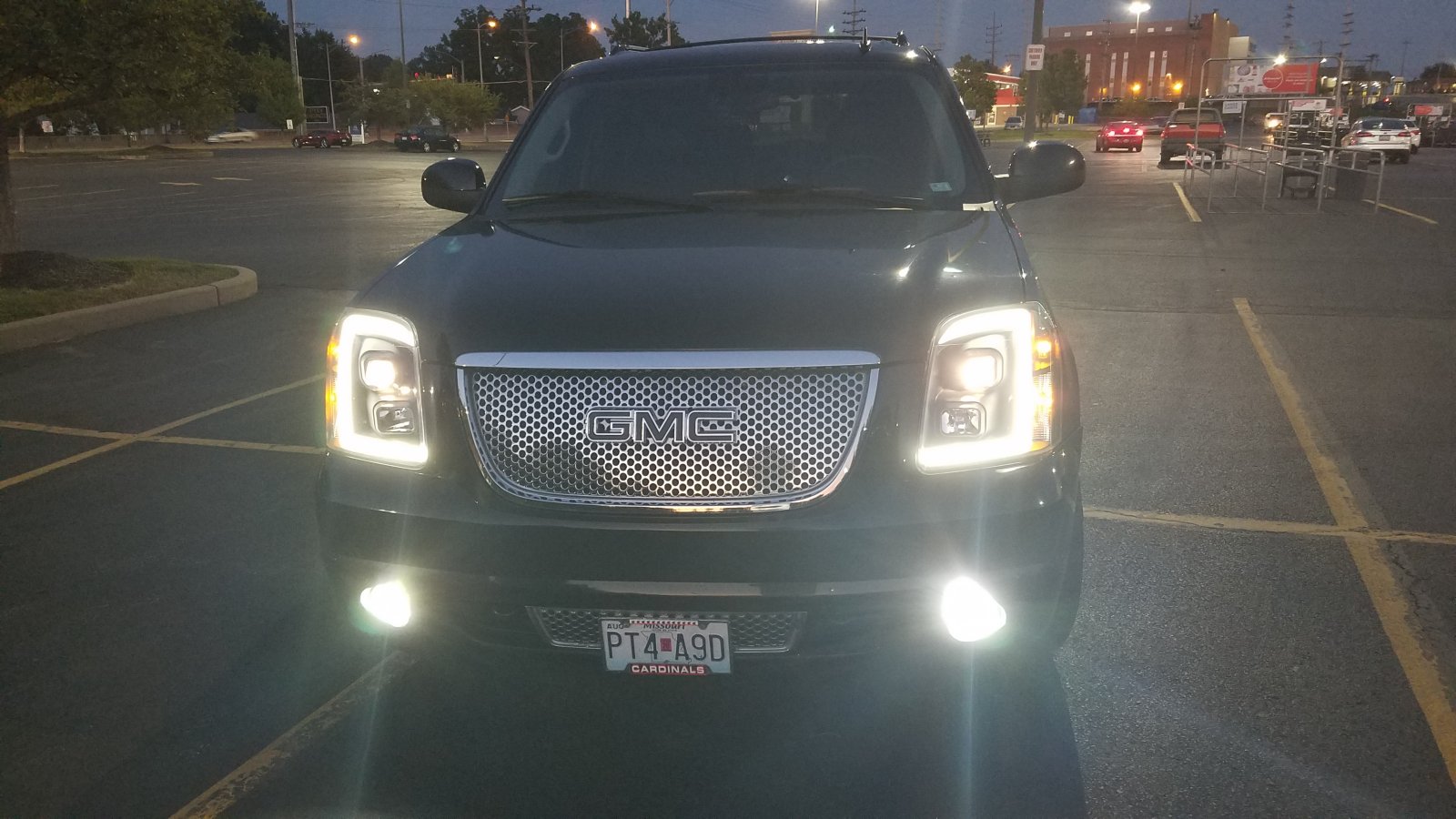

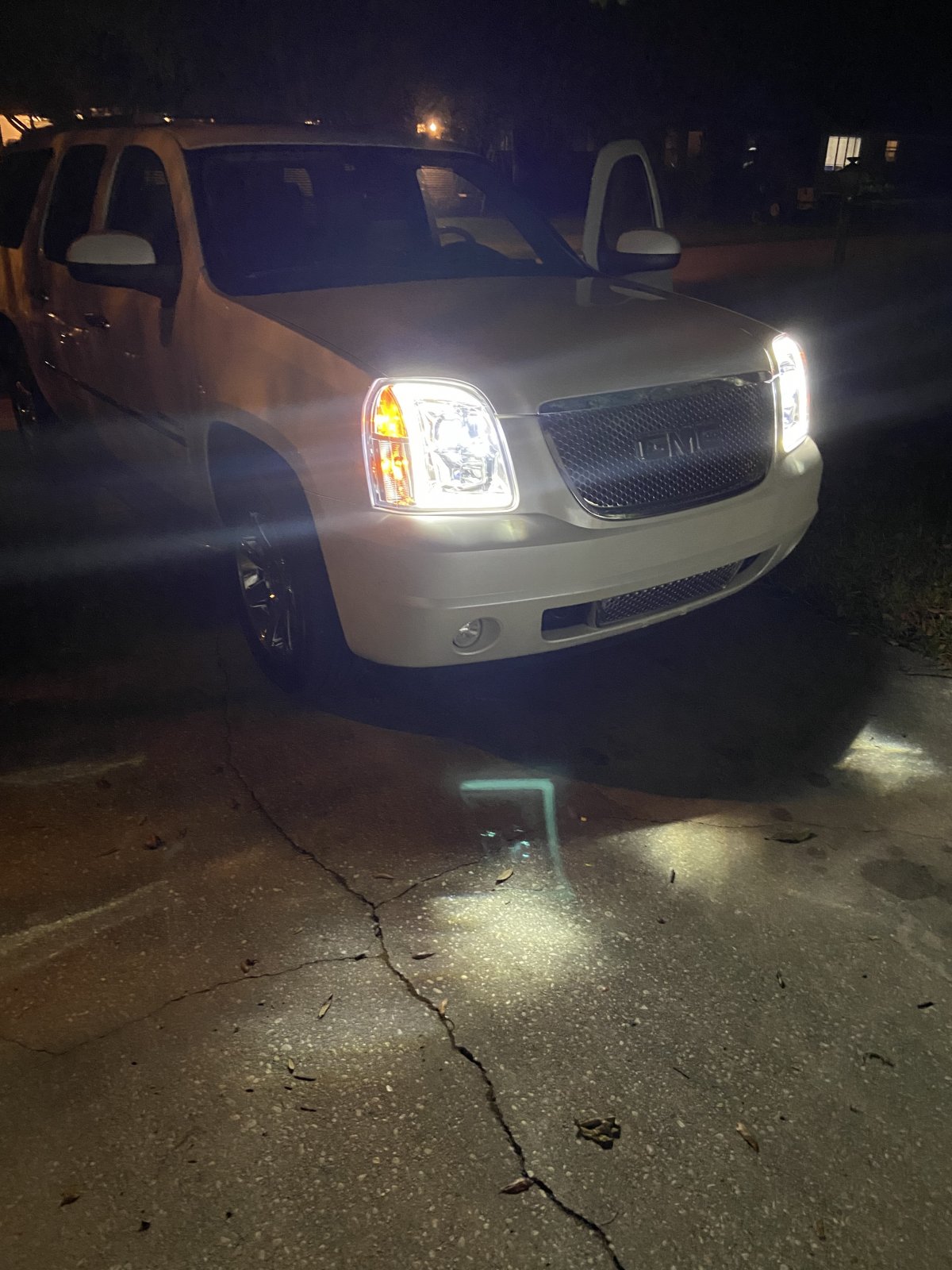

Anyway, these headlights have two plug connectors. One for the parking and turn signal, and one for the high/low headlights. The LED bar is spliced into the harness with the parking lights

there's a fuse in the under hood fuse box that has power with the key on and off. you will have to find the other wire from the led bar and wire it to that.
without a wiring diagram, you're going to have to take it apart and figure it out.. then run a fuse tap off that fuse to those wires.
Most aftermarket headlight housings will peel after about two years or so. Especially black housings. I’ve had several sets on my GMT800 do it, including the anzo u bar so pad like $350 for…. Ridiculous at that price point to not have better clear. The good news is that it’s pretty easily fixable. I detail professionally and restored my anzos last month jsut like any other set I would do in a client vehicle. Give them a couple rounds of wet sand using 1500 grit, then 2500 grit, sand paper, and then use an orbital polisher with w good gritty polish compound and they will shine right up. If you don’t have a polish machine on hand, 3M makes a kit that’s sold at Carquest and I’m sure all the big name brand parts stores, that has each of the sand paper types you’ll need as well as the little backing plate that goes into the chuck of any battery operated impact drill. It also includes little three inch diameter orange pads that will do the polish step. It’s pretty inexpensive. I actually use the 3M kit for small or odd shaped headlight housings where my bigger polish pads and the orbital won’t do a good job. You’ll want to make sure you follow behind the polish step with a good ceramic product to keep them sealed up against the elements.

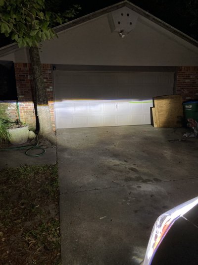

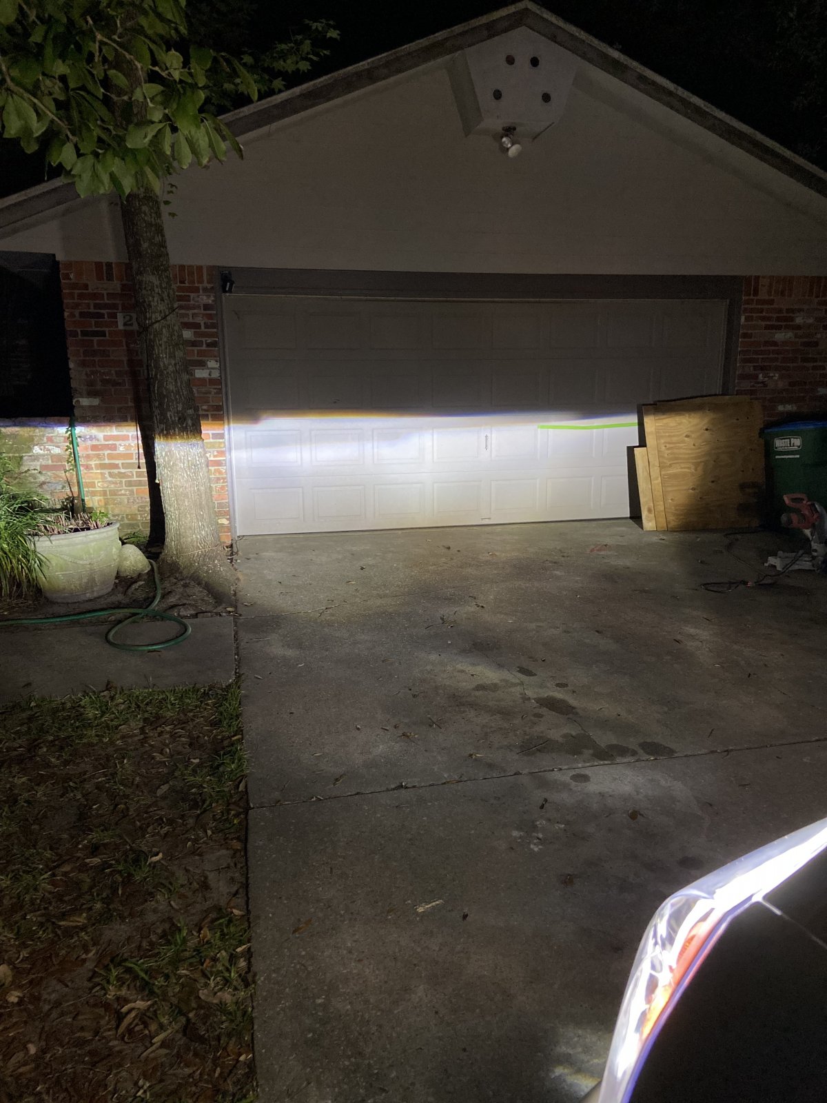

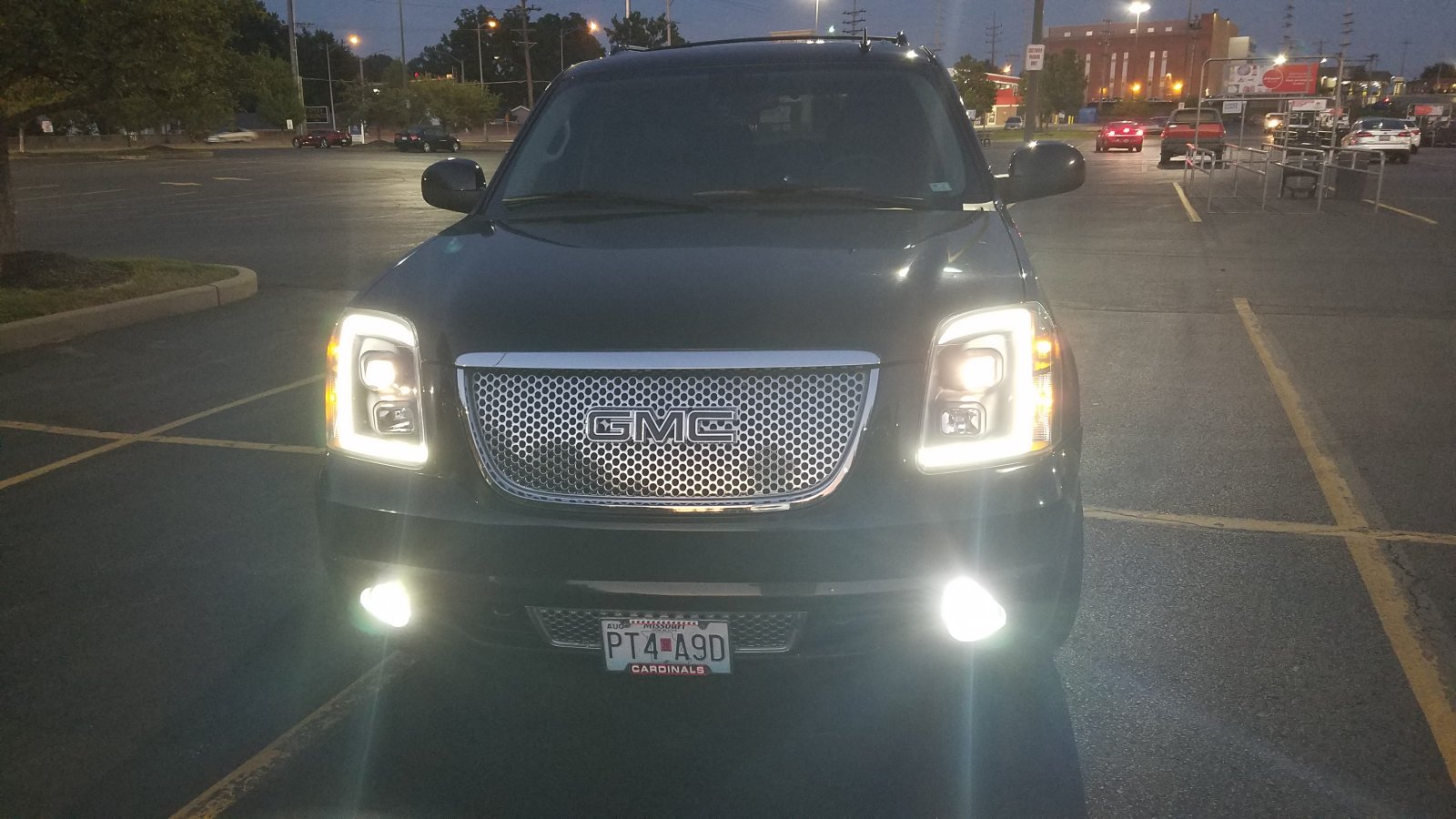

I ran those in our 08 Denali, during the day I just flipped on the parking lamps to run the LED daytime light bars.
HID bulbs work well in them but running LED bulbs in that projector makes you a major pariah to all oncoming traffic. I’ve got teens driving smaller pickups that get spot lit like deer in the LED that works well for your truck. The pics show 8k light bleeding all over the road without any pattern or cut off.
