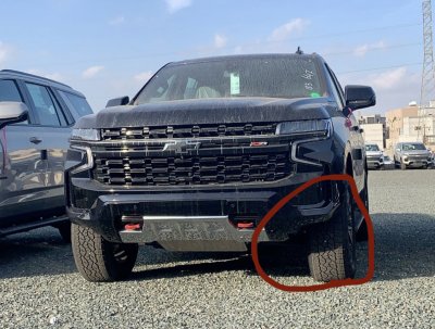

3 weeks ago I faced a problem in the front camper and toe when I bring my z71 to specialist workshop here in my area because small nail get inside one off the tires and we fix it. They told me your car’s front base not equal, And they fix it
When I saw old photos for my z71 before I got it, literally the front base of the car is not right. Someone explain for me please what’s goin on

I like to take my new vehicles to the local tire shop for an alignment. They have always been a bit out from the factory but not this much. After the alignment vehicles always track better and tire wear is less especially front edges.

It looks like you have the air suspension and its on the entry/exit setting with it in park. Make sure when you get it aligned you go to your settings and put the suspension in service / alignment mode. If your suspension tech is checking it while its 2" below its normal ride height it will be out of alignment.
